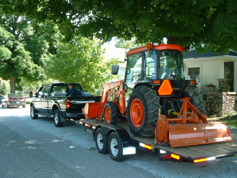

I have a 4330 with R1 tires and I can barely cover my tracks with a 58" CCM tiller. I would think that either the 66" or 72" would work. In softer soils the 72" should be fine.
