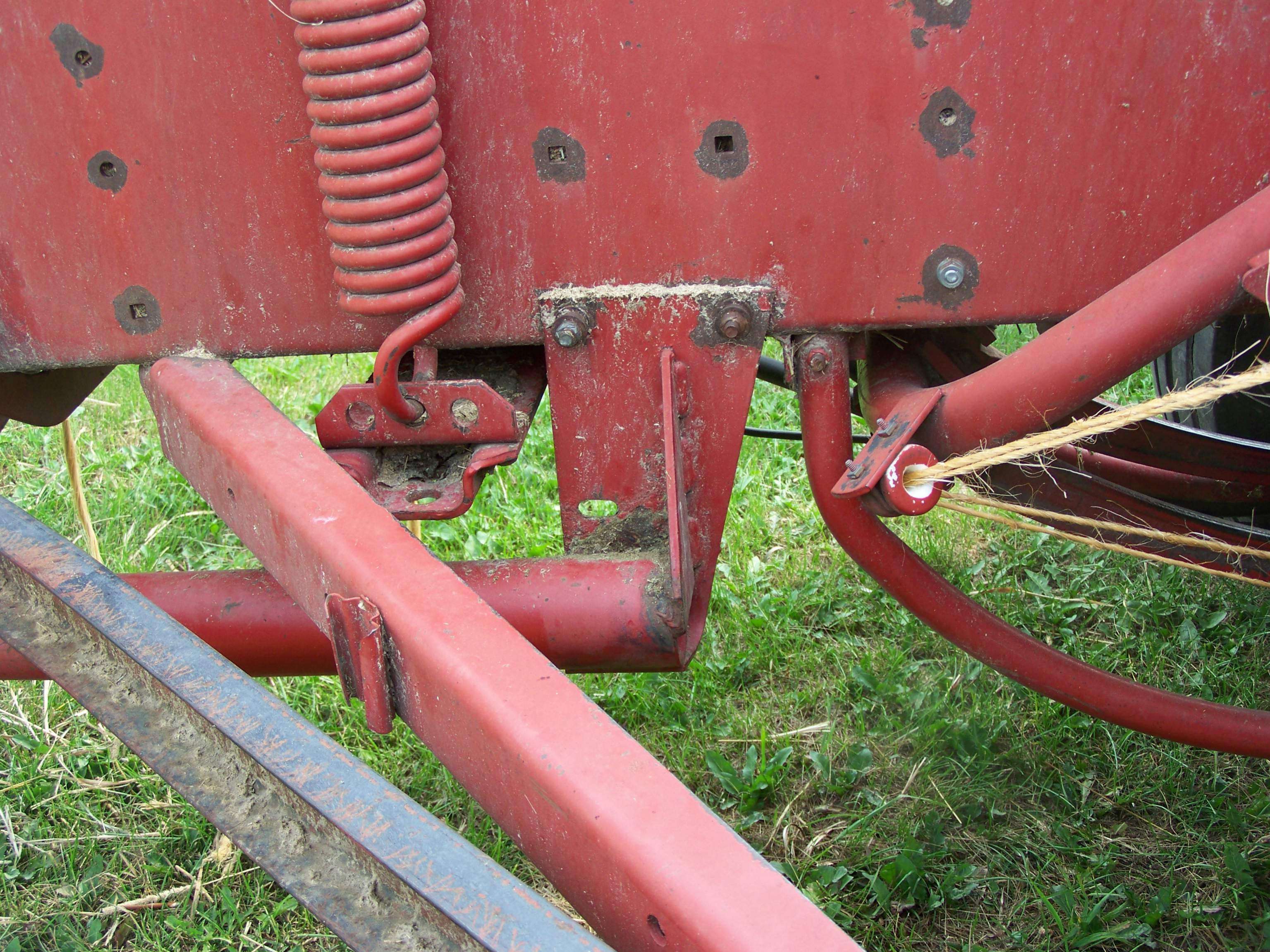

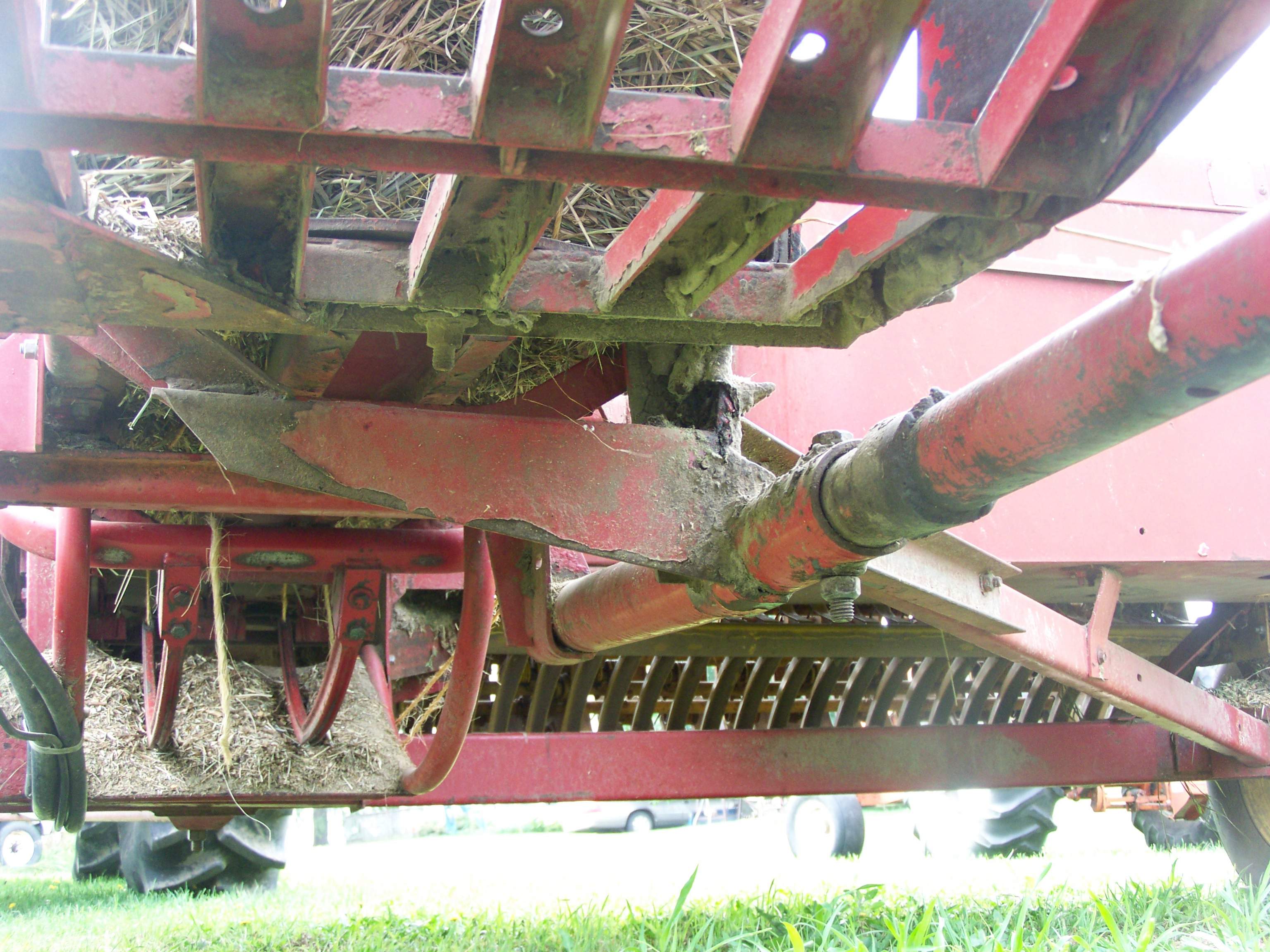

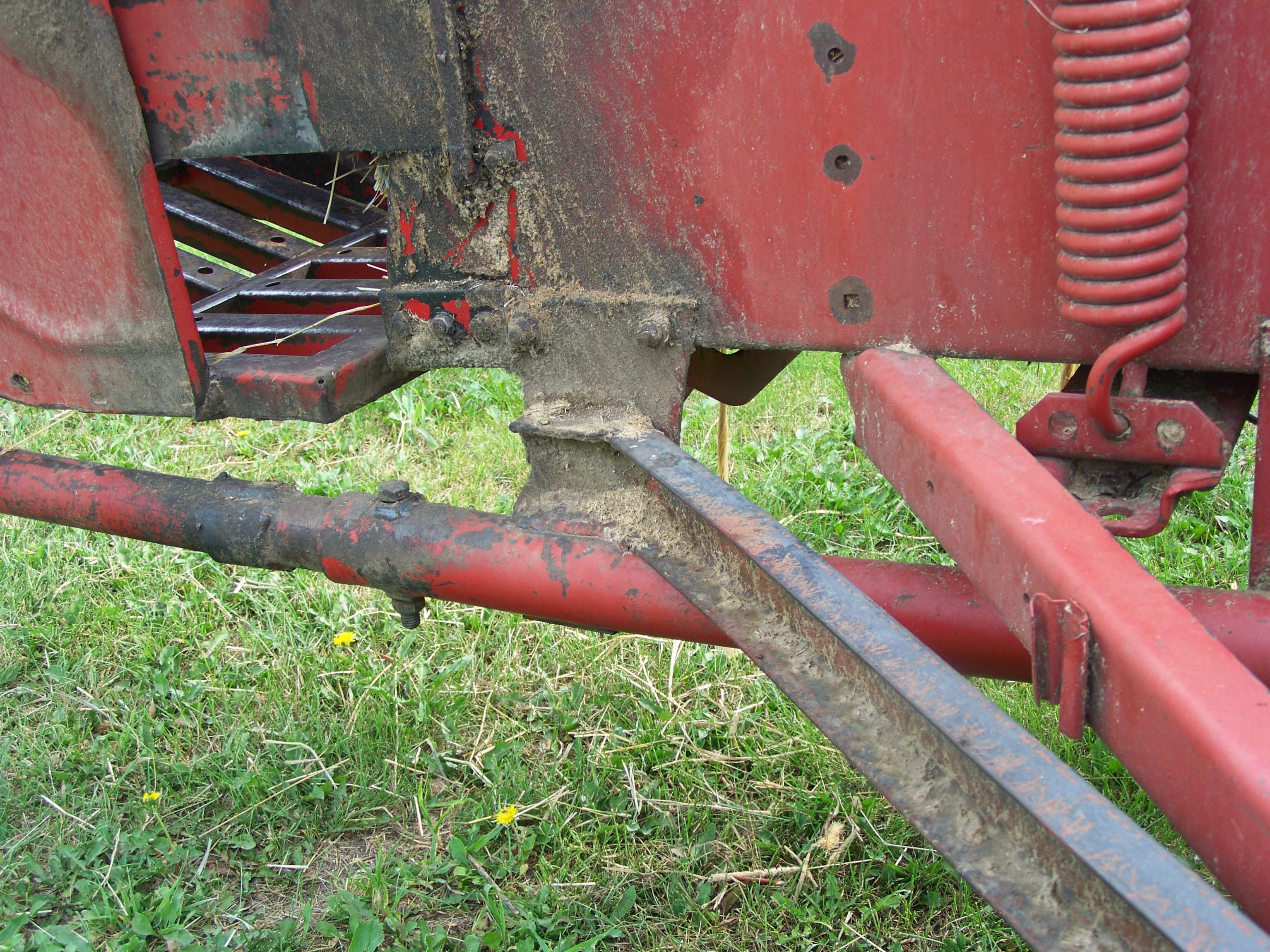

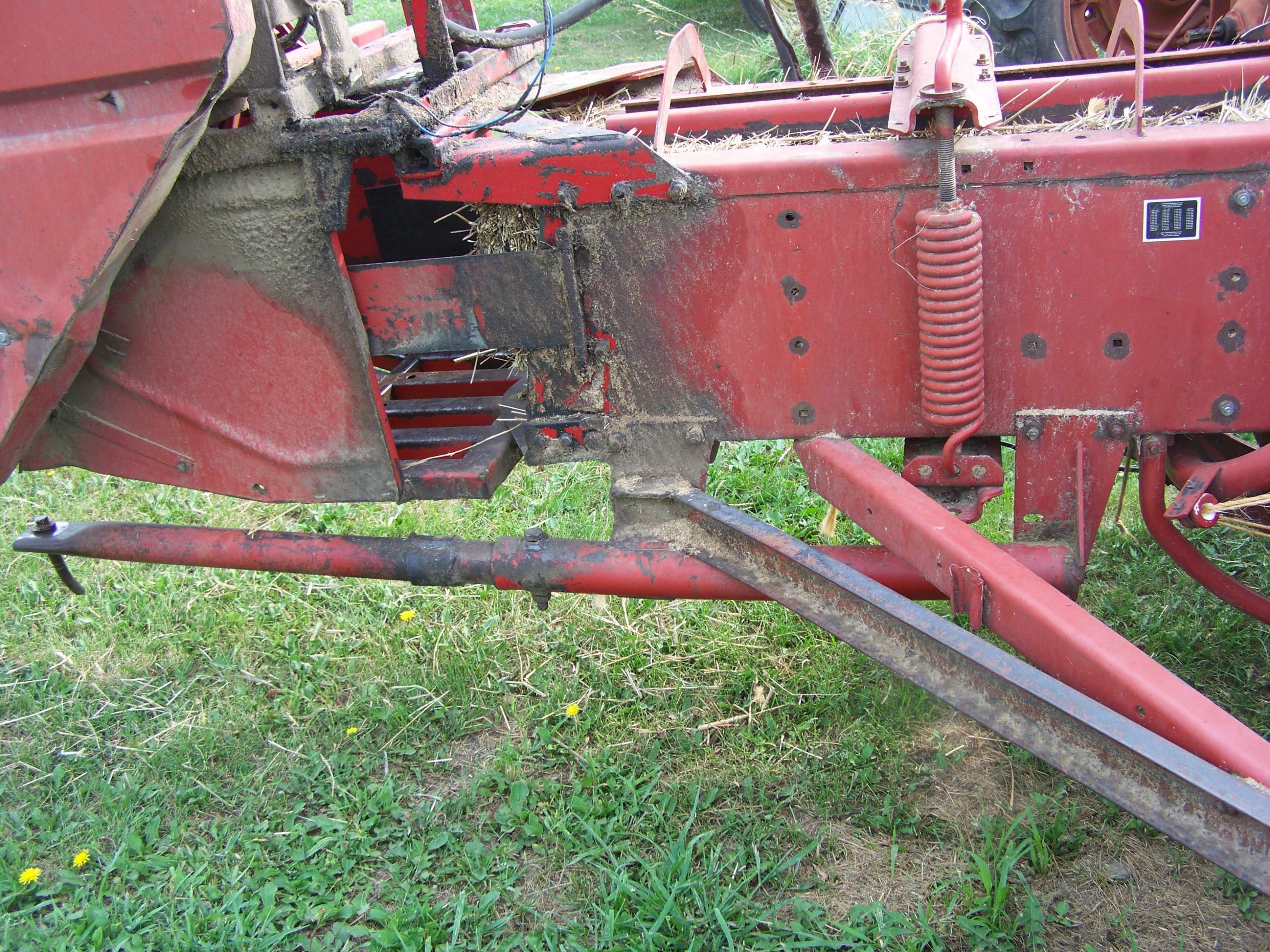

We call it a stooker but its a bale stacker. It makes a triangle out of the bales in a 4-3-2-1 pattern. I read that bales in the field dry faster if they get rained on if they are sideways. Dont know if its true but ill find out soon enough Im sure. Can you put up a picture of your hitch so i have an idea how to start. Thanks
   / 316 square baler #4
I hope these pics will help. This baler has a thrower on it, but the hitch should be the same. The last pic was taken from the under side. baler hitch 001.jpgbaler hitch 002.jpgbaler hitch 003.jpgbaler hitch 004.jpg
   / 316 square baler
Yeah. They do help. Seems pretty simple. At least i know where to mount to. Thanks.
