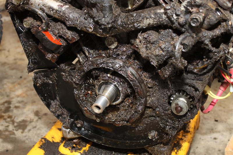

After a few evenings in a 35 degree garage, I finally managed to remove the engine. A friend fabricated a flywheel puller for me, so now the flywheel is off. I'll try to replace the oil seal tomorrow. I also found that the alternator coils are completely covered with oil and grease and gunk. The last couple times I ran the tractor (before I realized I had a major leak) the battery charge indicator on the dash would light up after while. I thought maybe my battery was getting old, but even after charging it overnight, the charge indicator would still light up. So perhaps the coils are damaged, or was everything just too gunk-covered to work properly? Do I have any chance of cleaning the coils properly, or should I replace it? Looks like a new alternator would cost me around $40. What's the best way to clean all this crud off the engine?

In case anyone comes across this thread in the future, I'll add this little update. I managed to get the engine clean, but the stator never really got clean enough, and some of the plastic on it was broken and discolored, possibly from when it overheated last summer. So to save me from having to disassemble the engine again later, I went ahead and replaced the stator. The old oil seal basically fell out with just a slight tug with a sharp hooked micro tool, so that was definitely my problem. The new seal went in nice and snug. I reassembled the engine, added oil, started it up and it runs like new, with no leaks. Thanks for all the advice guys. I was able to do the whole thing for less than $50.
