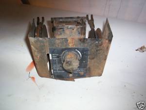

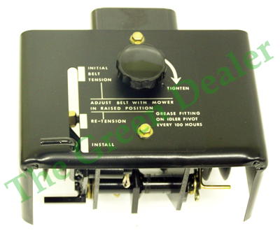

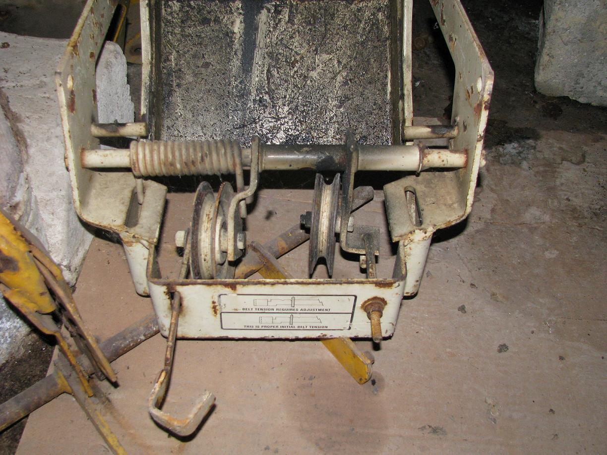

Yes, the BAB goes all the way from the front pulley down through the mule drive and to the pulley on the mower deck. The mule drive is the assembly that makes it possible to turn the belt. It also allows you to set the tension of the drive belt. It mounts to the front frame just below the grill where the snow blower or front blade would mount.
The first picture is what the JD mule drive looks like form the front. It doesn't show the pulley configuration. The second picture shows you how the pulley are position to give you an idea on how the belt gets turned, but it is not a mule dirve unit from a JD.
Addendum: I found the third picture on ebay. This is a JD mule drive that shows the pulley characteristics.

Oh ok yup thats what its got. So that one belt only drives the mower deck, and then there is another pulley to drive the blower for the grass catcher, right? I'll have to go and try and see if I can hook it up right :D
/ 318 Mower Deck Help Please #7
You got it. If I remember correctly, the blower belt is a smaller belt that hoooks to a second "stacked" pulley on the spindle for that outside blade.
