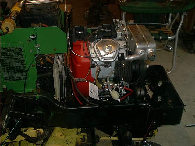

I know that I picked up on this thread a little late, but I've repowered an 420 with a 24hp Honda and a 318 with a 20hp Honda and been pleased with both. The 420 was a little complicated because they didn't offer a kit for a 420 so I ordered a 318 kit and modified it to work. On another note the 20hp for the 318 was a direct drop in.
