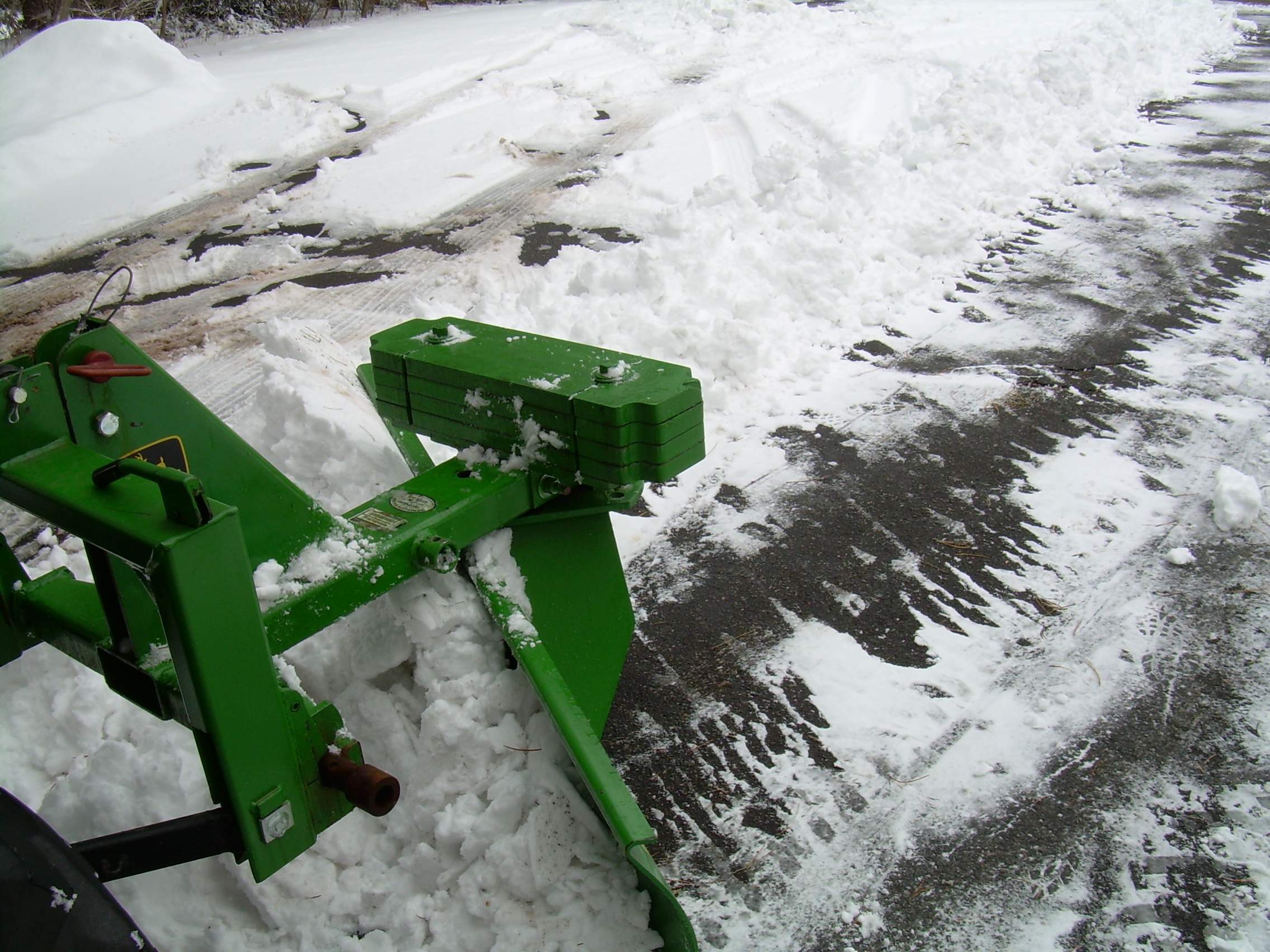

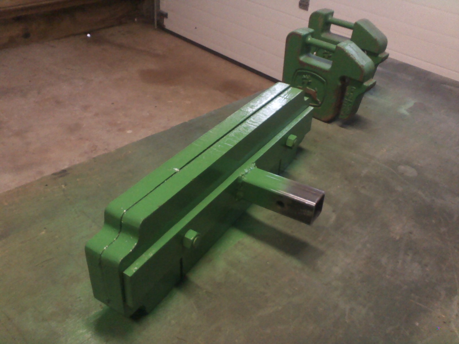

I made a custom weight for my 320 today, to slip in my receiver tube.
A couple of heavy steel plates from a gym set up, I could barely lift the 2 attached to the tube, probably 120-150 pounds.

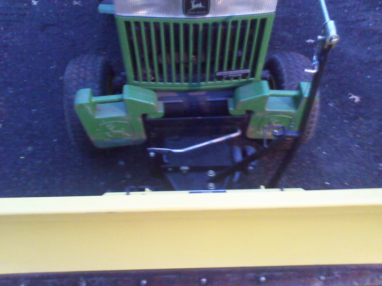

I also put 2 suitcase weights on the front to help with keeping the front tires from being pushed sideways when plowing. It might help a little.

VERY Slick JB!! Innovative and practical.. that 320 could probably run through a brick wall on ice.. I've got an old universal gym set collecting dust in the basement - could be a great use of some of some of the weights. Nice job!

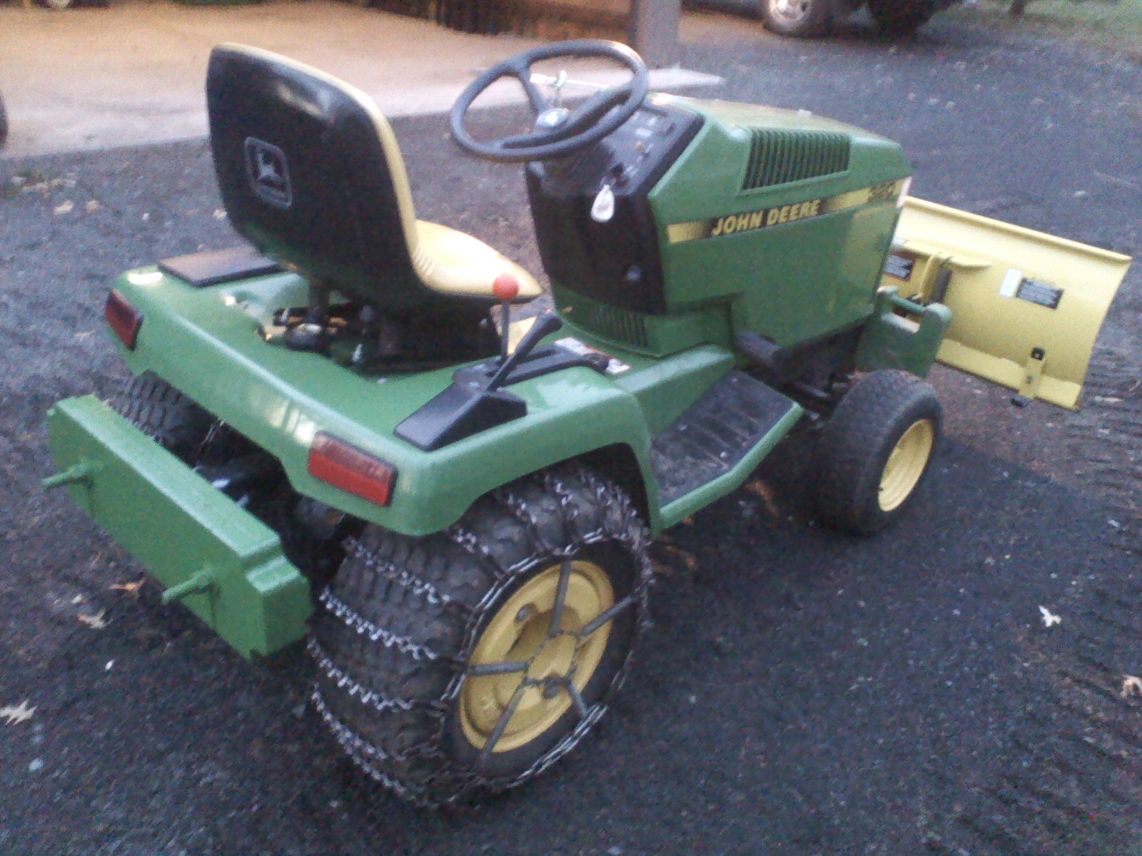

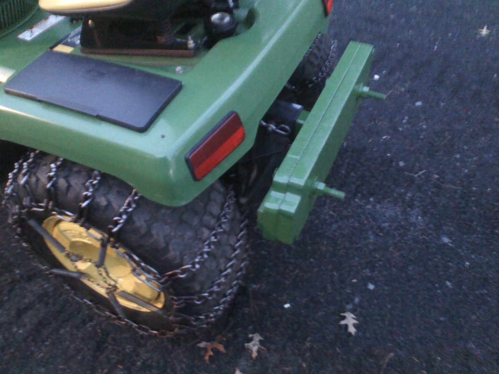

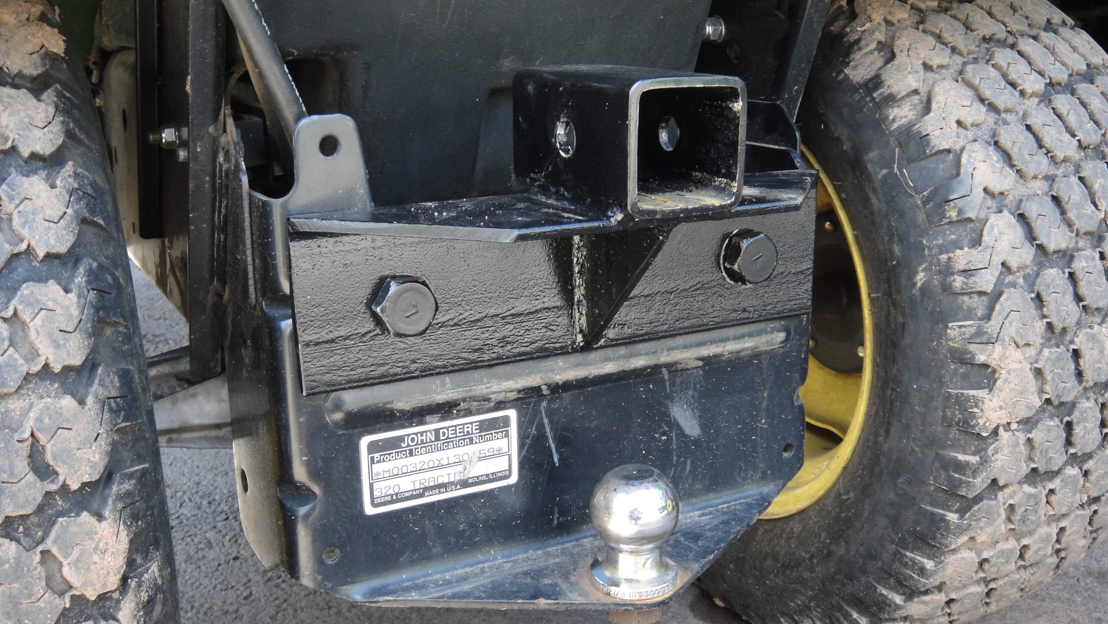

I use to hang a couple of suitcase weights on the back, but this year I put a receiver tube hitch on, welded to a pc of angle iron, bolted to existing holes in the back frame member.
So there was no room to hang the suitcase weights, I had 4 of these steel plates, found at the dump, they are very heavy. I had put all 4 on my 6ft back blade, but that was too heavy, so I took 2 off.
