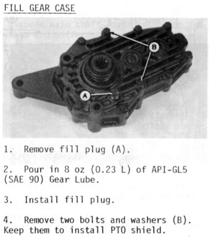

beenthere, That is the actual PTO
I do have rear PTO's on my tractors and on the 318 has the gearbox for my 47 mechanical driven tiller. Both use the same gear oil!
   / 322 2000 RPM rear pto oil #12
It is the same one shown for the 332, There is a fill/drain plug, it is #20 in the diagram.
   / 322 2000 RPM rear pto oil #13
Thanks, brought me up to speed.. so "gear oil" is the answer?
   / 322 2000 RPM rear pto oil #14
Yeap, 80W-90 or 90 in the rear gear case, not on the actual PTO. I'm wondering if you had the 4X5 series in mind.
#15
So are the service specs for this in the tiller manual since its not covered in the tractor manual???
   / 322 2000 RPM rear pto oil #16
Service Instructions are on page 20 of the Owner's manual for the tiller OM-M70369 V6
Also getting back to the previous topic, the PTO drive gear case takes only 8 oz of gear oil (M74202-I7 manual on the rear PTO/gear case)
#17
Again thanks for the info.
http://www.wfmfiles.com/download/316_318_322_330_332_420_430_2000_RPM_Rear_PTO_Installation_M74202-17(BM16675).pdf
