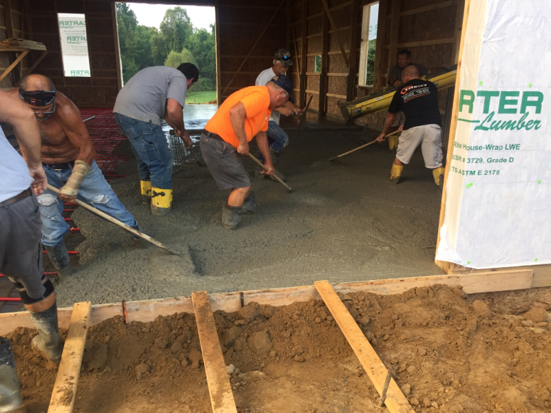

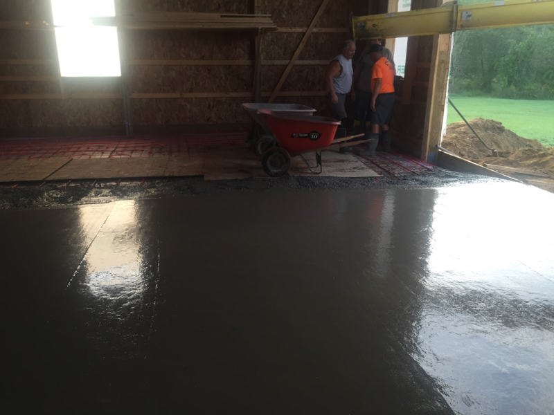

Multiple measurements and tons of photos. Being ill never see the tubes after concrete, this "should" give me and idea where the zones are at.
Yeah, I'd want precise measurements with a grid map drawn. Will come in handy for the day when you drill a hole in the concrete!!! :)
