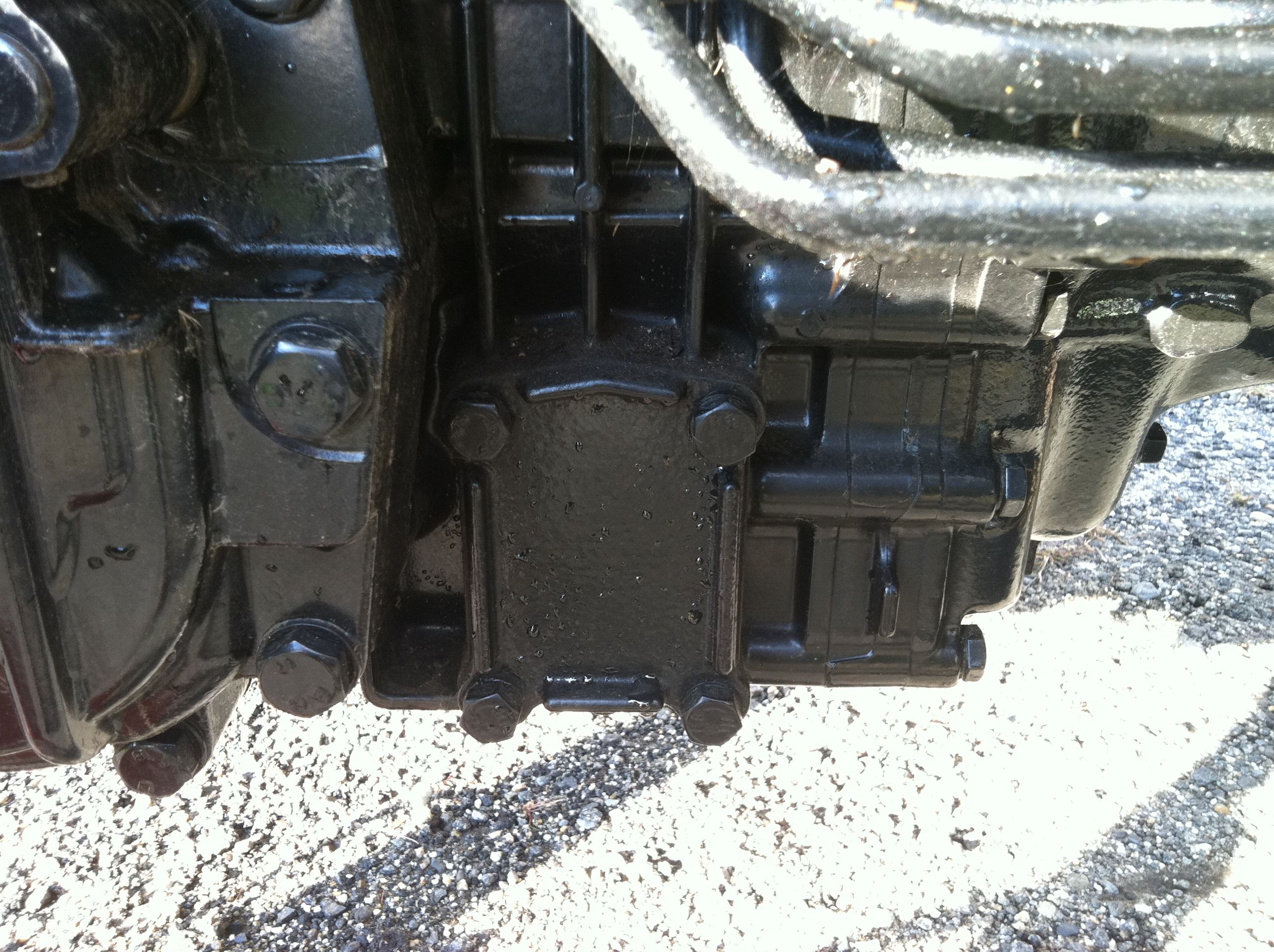

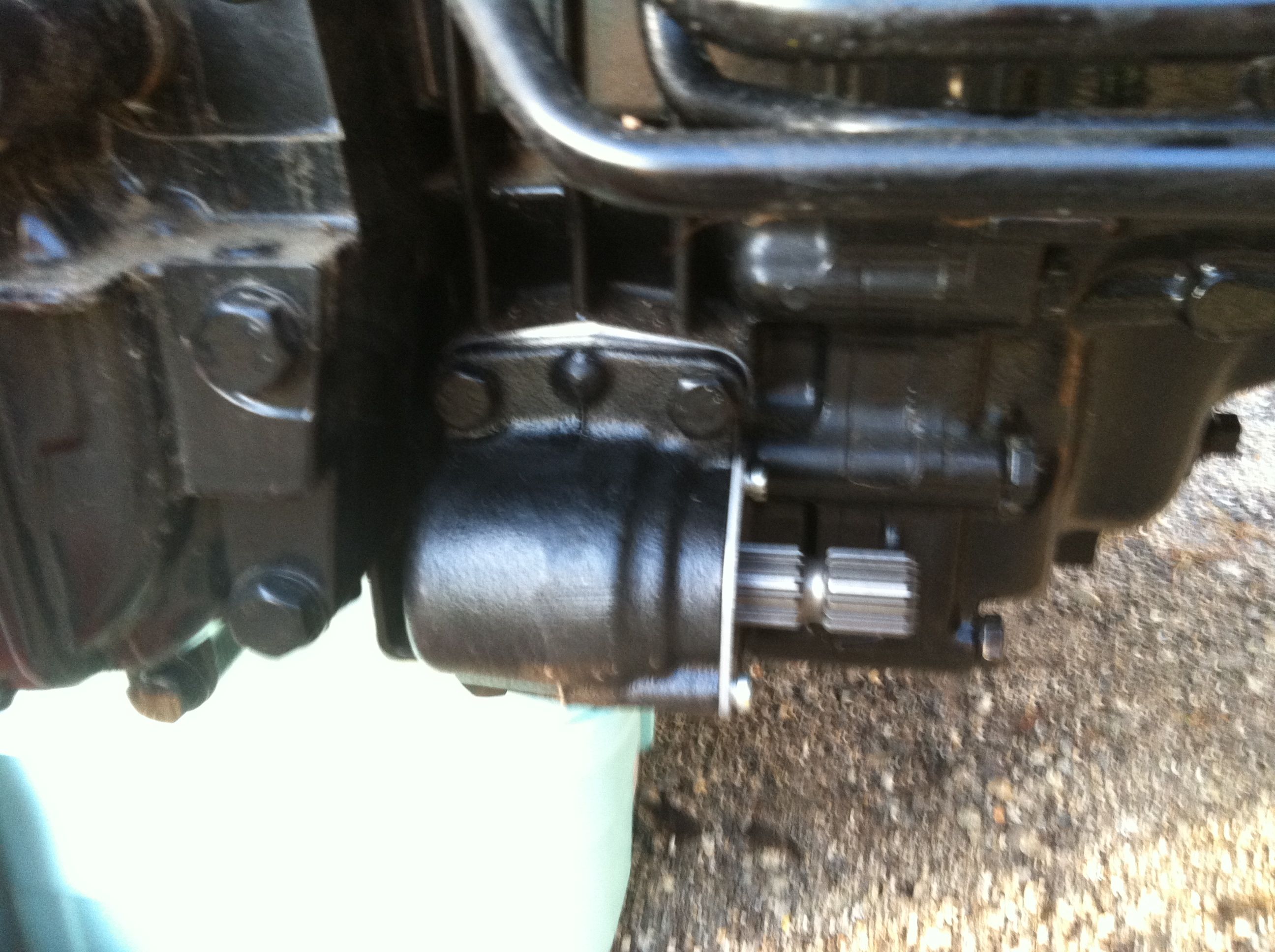

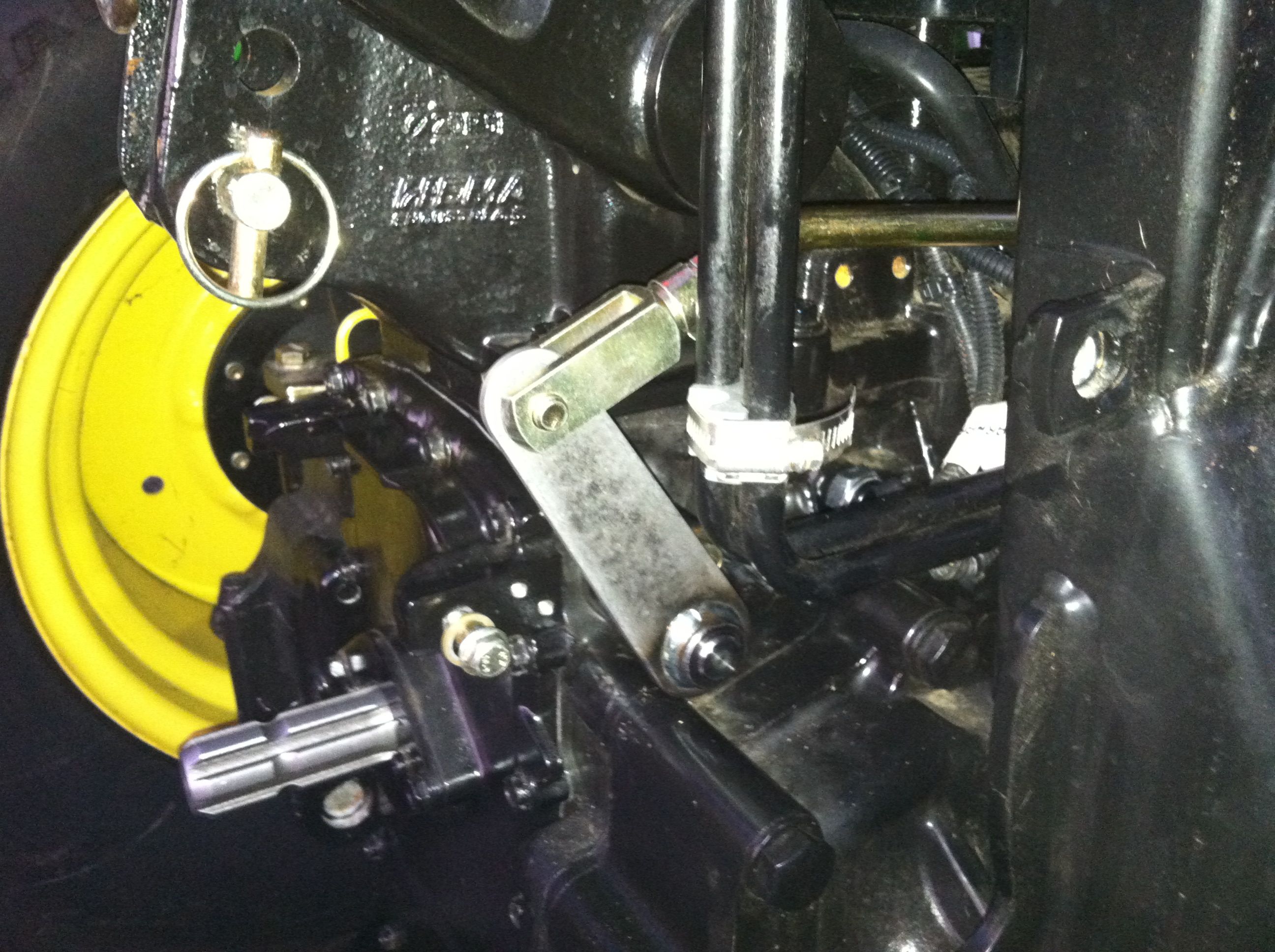

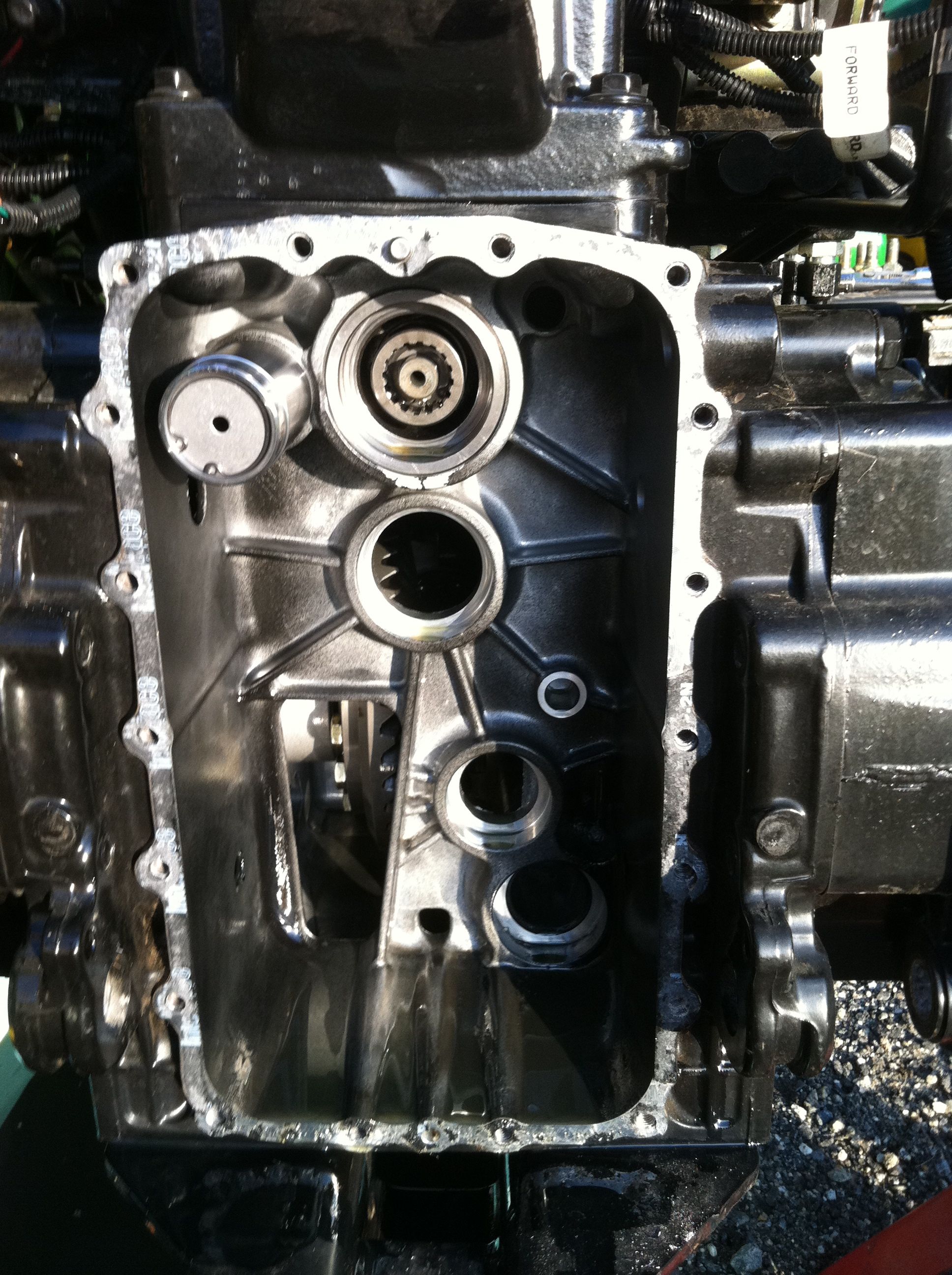

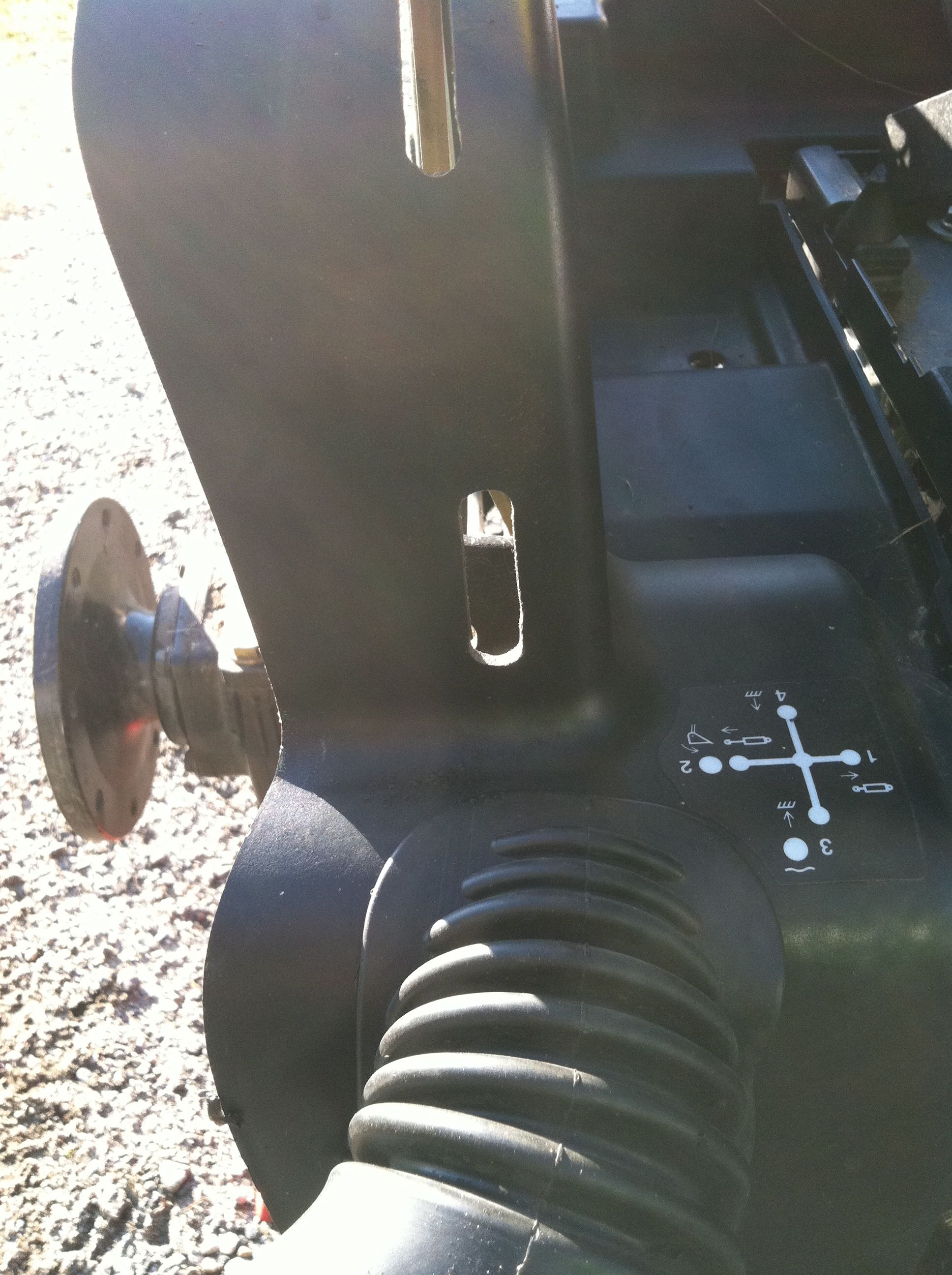

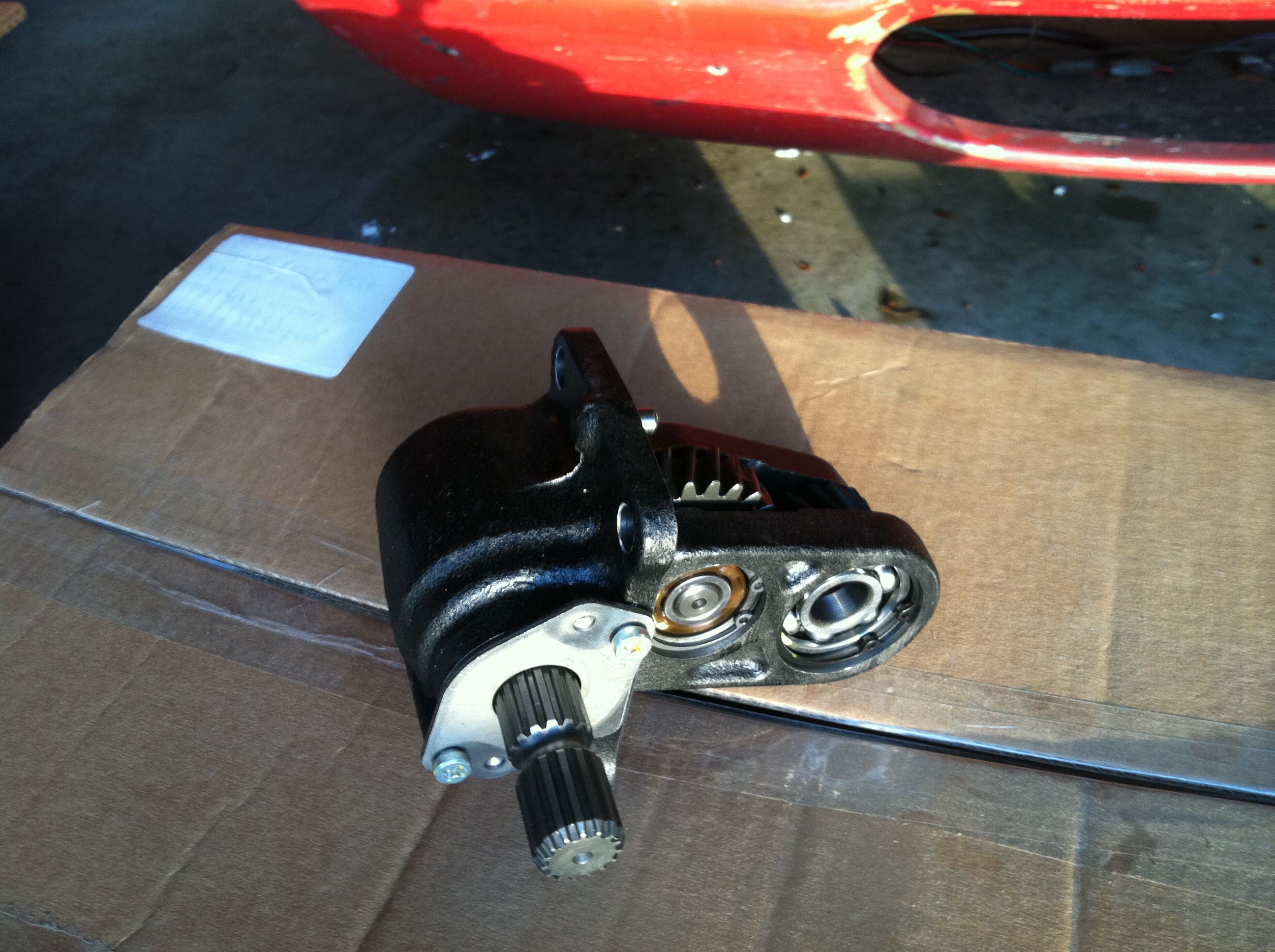

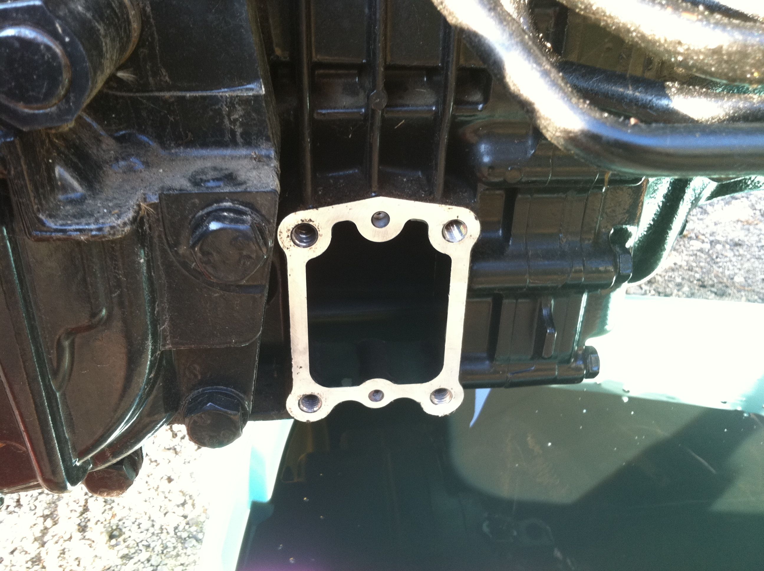

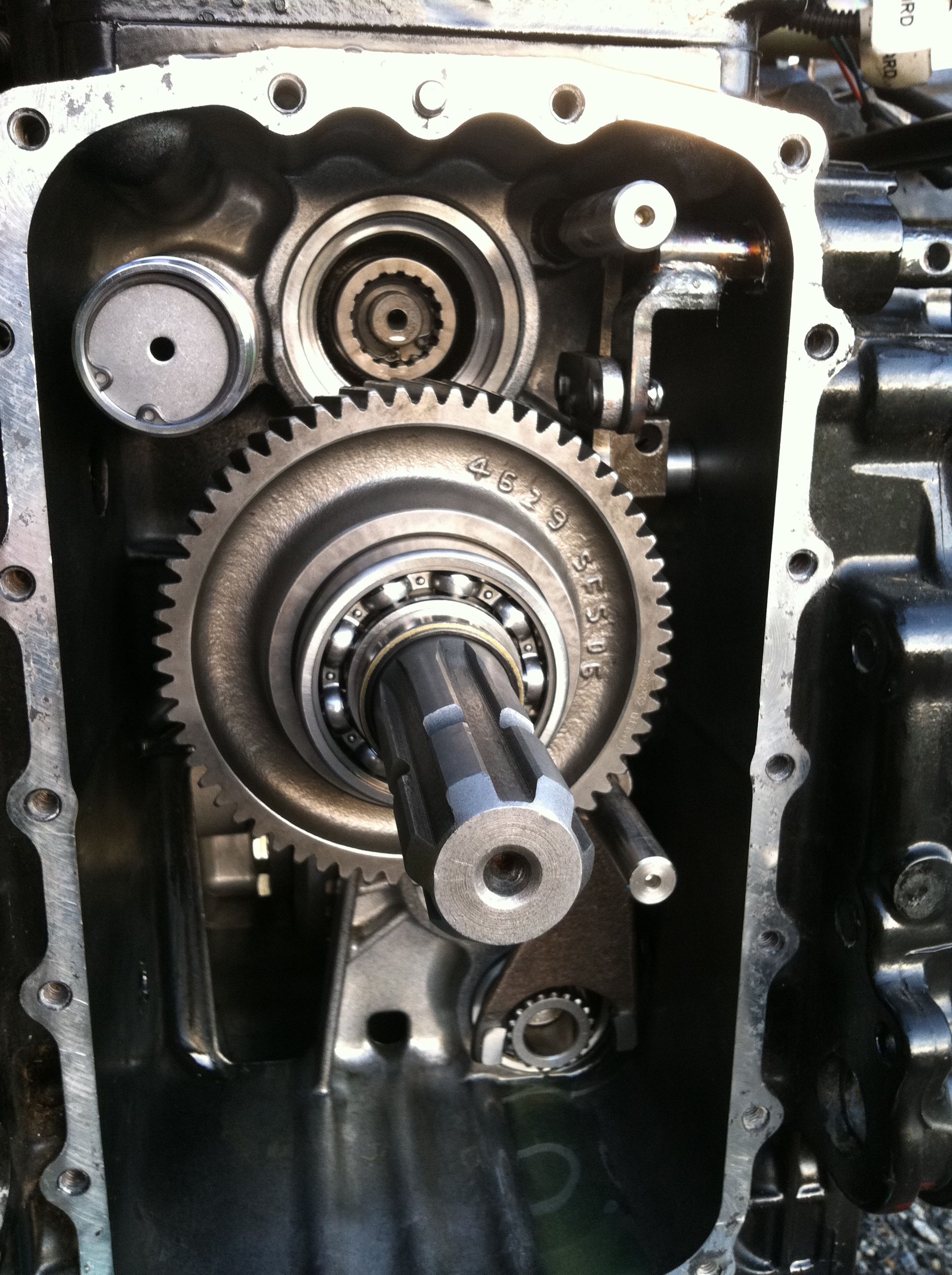

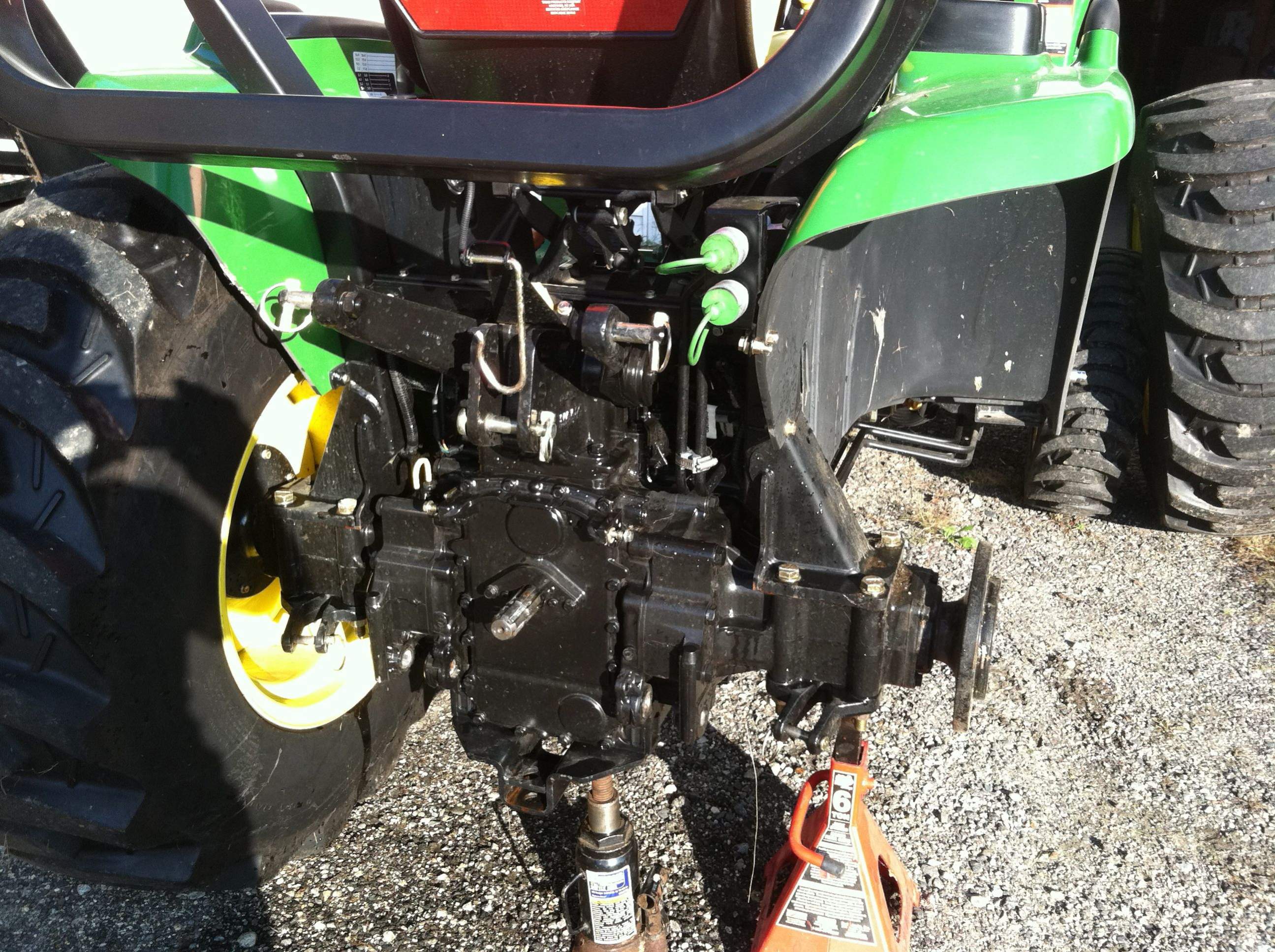

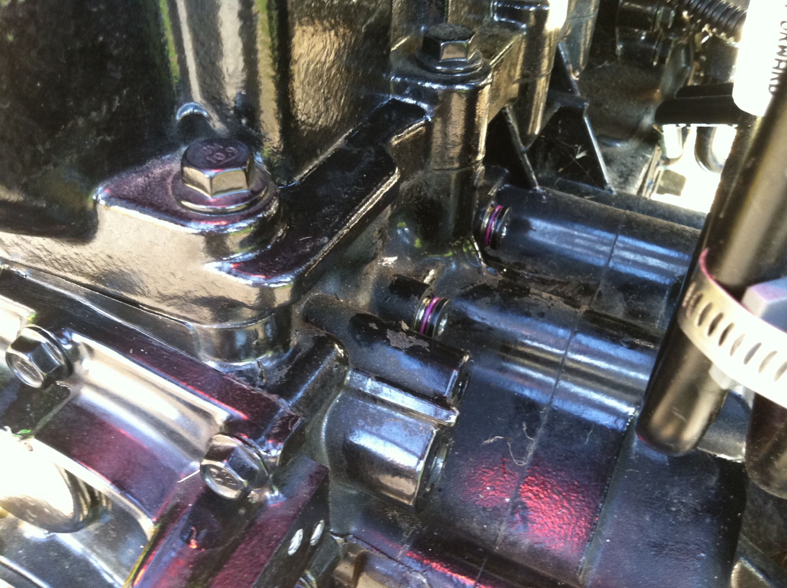

The question of a MID PTO and the Power Reverser transmission on these tractors comes up periodically since Deere doesn't let you configure one that way on Build Your Own.
It is definitely an option that you or the dealer can install. The kit from Deere is a little under $600 and is complete with everything you need except the Low Vyscosity oil to refill the transmission ( 6+ gallons).
It comes with an easy to follow instruction booklet with pictures that are not really the best but when you handle the parts it's easy to figure out.
They tell you it to allow 6 hours. It takes about 4 from start to finish and if you own a decent torque wrench you have the skills to do it.
Pictures below from when I did mine.
