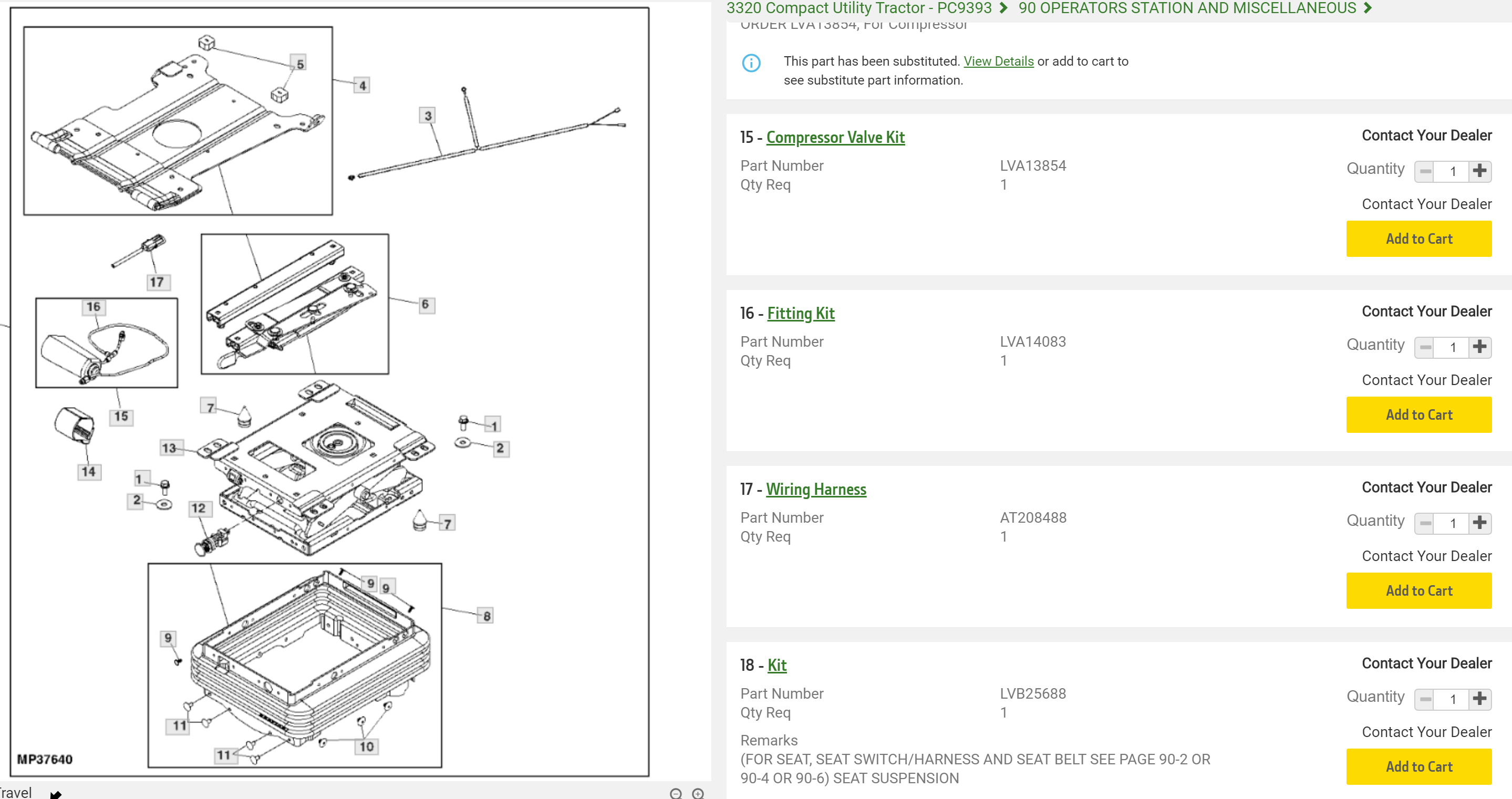

On some the wire was a bit short and got pulled off the compressor, check there first. Here is the parts breakdown.
   / 3320 air ride seat suspension
OK. It looks like the wire was a bit short and got pulled off the compressor. Now the compressor turns on but all I hear is hissing coming from the bladder. I guess that's my problem.
