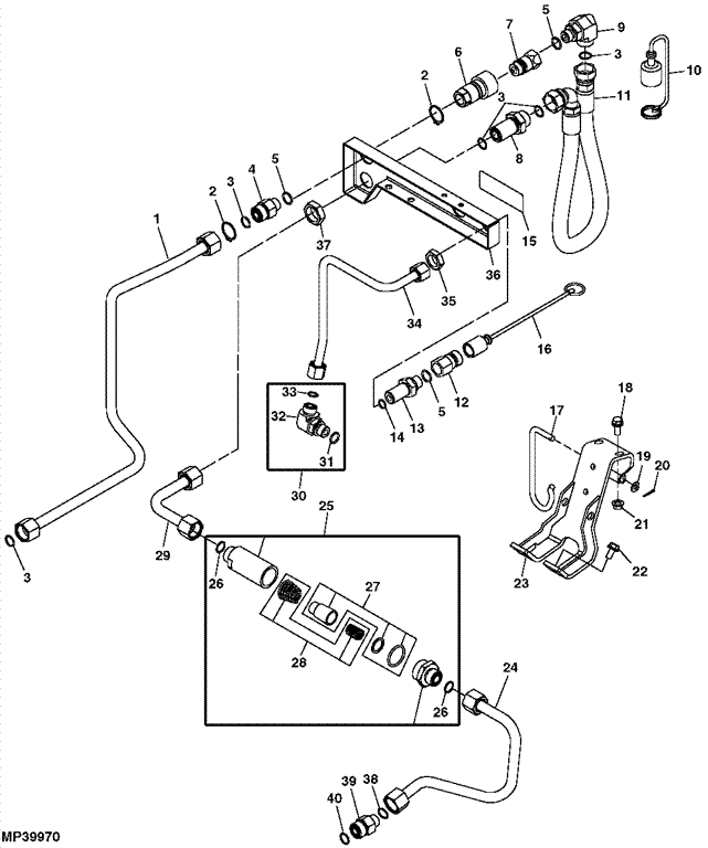

not sure if I am posting this in the right place but I desperately need some info. Just bought a Speeco hydraulic 3pt Log Splitter @ TSC. Unit came with no hoses. I am about to order 6' hydraulic hoses for it but need to know what the connection is @ the 3rd SCV location at the back of my tractor. The splitter end is 1/2" NPT which I will use o-ring fitting for.. I just need to know the male fitting on the other end so that I can connect to the 2 female couplers on the back of the tractor. Any help would be greatly appreciated as I am hydraulic challenged(ignorant). thanks.

sorry.. my own ignorance.. I need to connect to the backhoe connection ports.. my mistake.. need full flow.
First, this doesn't make sense. It is either a 1/2" NPT or ORB (o-ring boss). They are not interchangeable.
Take a look at the picture I posted, your best bet is to get the couplers from JD to insure they will fit properly, the part #s are:
6 LVA13231 HYD. QUICK-CONNECT COUPLER
7 AR94522 HYDR.QUICK COUPLER PLUG
I think they are 1/2" ORB threads on the couplers, but your best bet is to wait till you get the couplers before you get the hoses to be sure.
