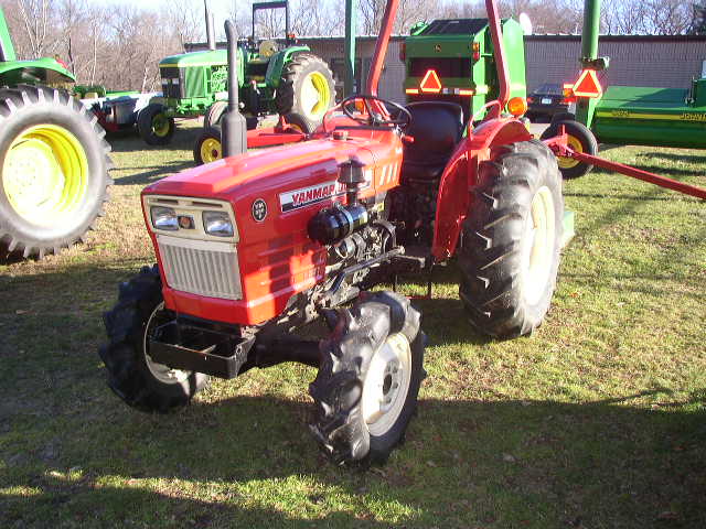

Well - here's an update. I went and drove the 336D and love it! I especially like how the powershift works. Very smooth to change speeds and direction. I bet it is a challege to manage a joystick, steering and the powershift selector when doing loader work....I guess you need three hands. But, the tractor is nice, so we're negotiating.
Gary has been a big help in getting me info, so am considering whether to get a loader for it.
Stay tuned. I attached a picture. Thanks for the help so far!
