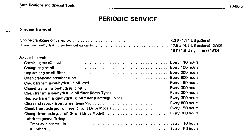

Anyone know how many hours between oil changes is suggested for the Yanmar 336d engine?
   / 336D engine oil hour change #2
3T84 engine series
Due note, when these machines first came out, oil was more 'generic'. Today we have synthetics, blends and a bit more science behind it all. The Shell Rotella T4 10W30 synthetic would allow oil changes in the 300 to 400 hour service range.
As for lube the grease fittings, I do this every 100 hours. There are more under the tractor under the open cab that need the lube as well.
The hydraulic oil, I've done it from 300 to 500 hours. This I learned the hard way not to go past 500 hours too far. The old Ford N's just keep going and don't care. The Yanmars will get the filter screen clogged and the machine basically doesn't move for PowerShift, nor the loader, nor the 3PT.
It's been 4 years, bet I have to repack the front bearings. This past summer I did all the trailer axles.
Like most things, the above list is a tight and strict Service Guide. Sure, you could go over a bit, but it depends on how you use the machine and in what type of environment.

Oil change interval: If the tractor is used for mowing, grading etc and its eating a lot of dust then shorter intervals are a good idea, to get rid of particles even though the chemistry of the oil is fine. And most advice is change it annually regardless of hours.
But I've been going 1.5 to 2 years on the YM240 that is now dedicated to the backhoe, because that engine doesn't see any dust or heavy load. Also, Yanmar says you don't need to change the oil filter with every oil change so for the YM240 i wait until at least 50 hours even if that's past 2 years.
