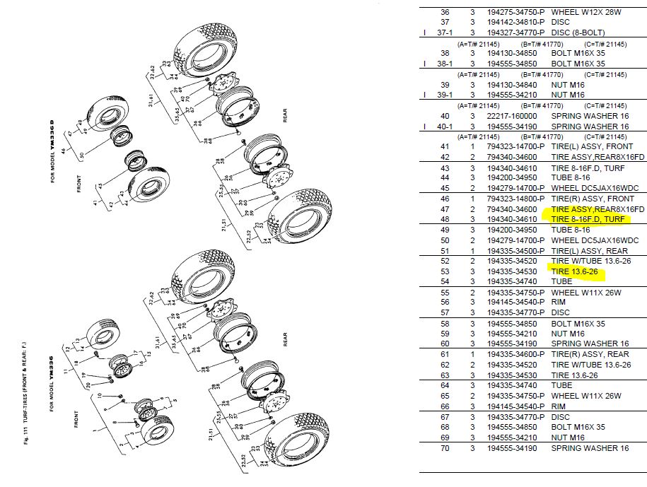

I was at the farm today so I checked. They are 12.4 11-28. Bridgestones as I recall but did not check that.
Hey, that's nice. Thanks for looking. And that size does match one of Yanmar's published specs - although as Aaron pointed out, there are a lot of YM336D tire & rim options that can be used with what is presumably the same internal F/R mechanical ratio.
And it does make sense that the Rolling Circumference of a Bridgestone 12.4 11-28 would be very close to the rolling circumference of the other tire we know that Yanmar used: The Goodyear Field and Road 13.6/12 12-26. So it all adds up right.
