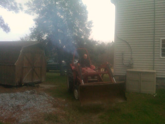

Was the oil level high? About the only way for diesel to get into the crankcase is through a bad injection pump. The fuel valve on the filter is only for turning fuel off while changing the filter. Should not have to be closed at any other time.
/ 336D
#12
Oil was a little high 1/2" over the full mark without screwing the dipstick in. It is still smoking too much - blue - and smells like diesel.
If bad injector - how would I check? can it be rebuilt or need a new one?
Noticed this evening the sparks we coming out of the exhaust, not over heating. I think it is running to rich.
Oldest son on the tractor.
Note to self - When you take the fuel bowl off to clean it - bleed the bowl before you try to start it.

If the injectors are wore out look into buying a new pump vs/ having the original one rebuilt. I was in a similar position with a different tractor and for a little more the new pump was more practical. Blue smoke is the engine burning excessive oil, it could be a result of worn rings allowing your engine oil to get past the rings and on top of the cylinder. That or when the oil warms up it expands and forces itself past the rings to the top of the cylinder. I would drain a little bit of the oil out and see if the blue smoke goes away. Have a merry Christmas everyone! :)
