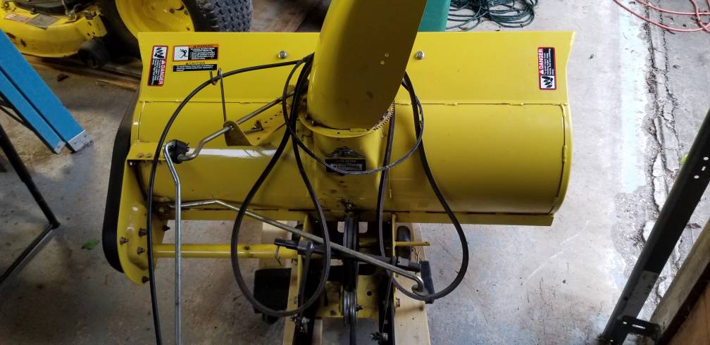

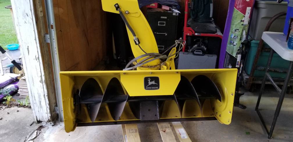

Looks like it's in great shape!
Not to split hairs but that is a snow thrower not a snow blower. The difference is that a thrower is single-stage while a blower has the second impeller that helps out with the wet stuff. Both are available for the 345 but the thrower is a little lighter which should help out with the extra weight I was talking about.
Looks like you got a great piece of equipment at a nice price. Enjoy it and let us know how it works out!

If my driveway is level, are rear suitcase weights needed. I have 50lbs wheel weights and the rear AG tires are filled with fluid, i weight 180.
