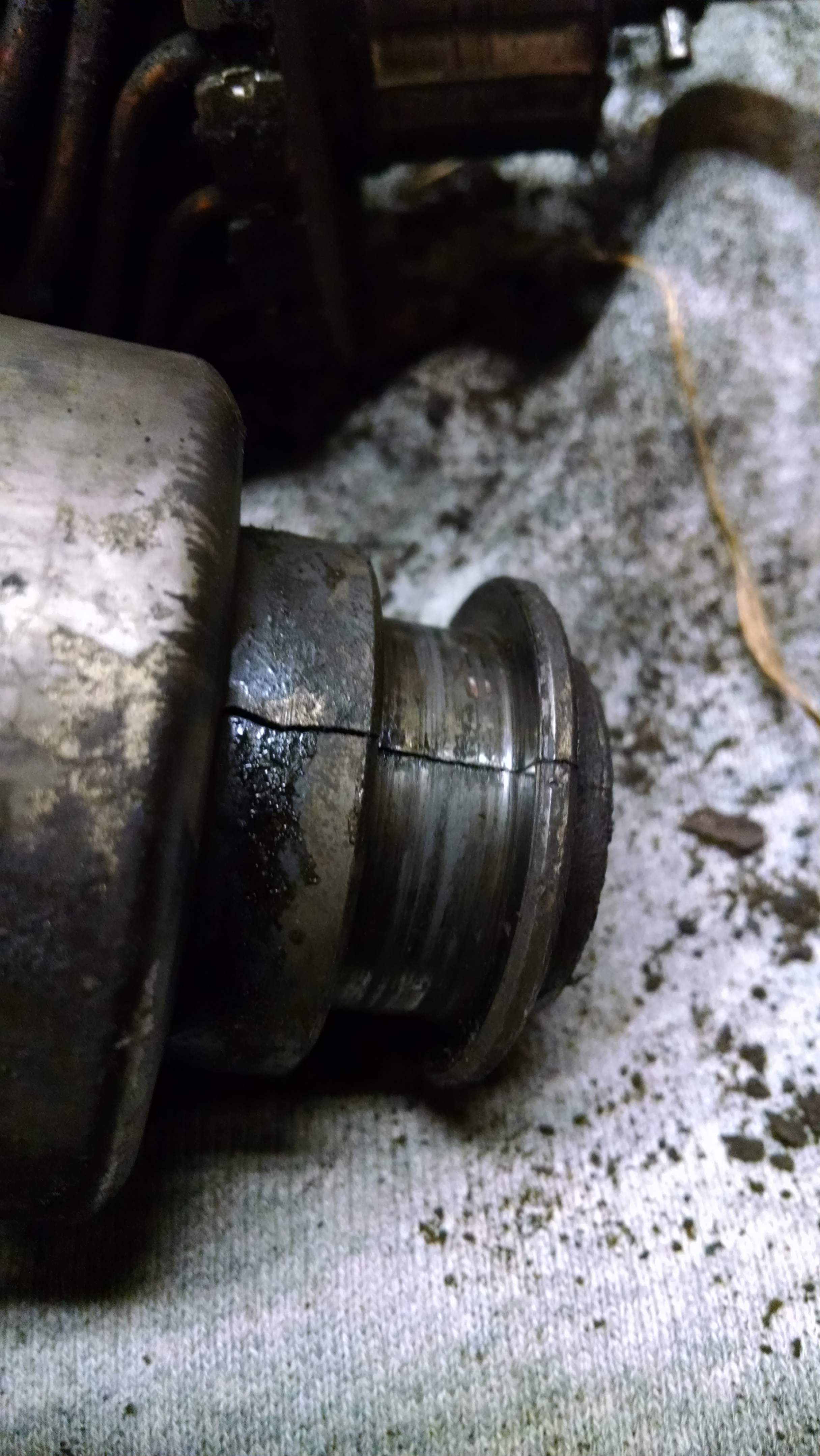

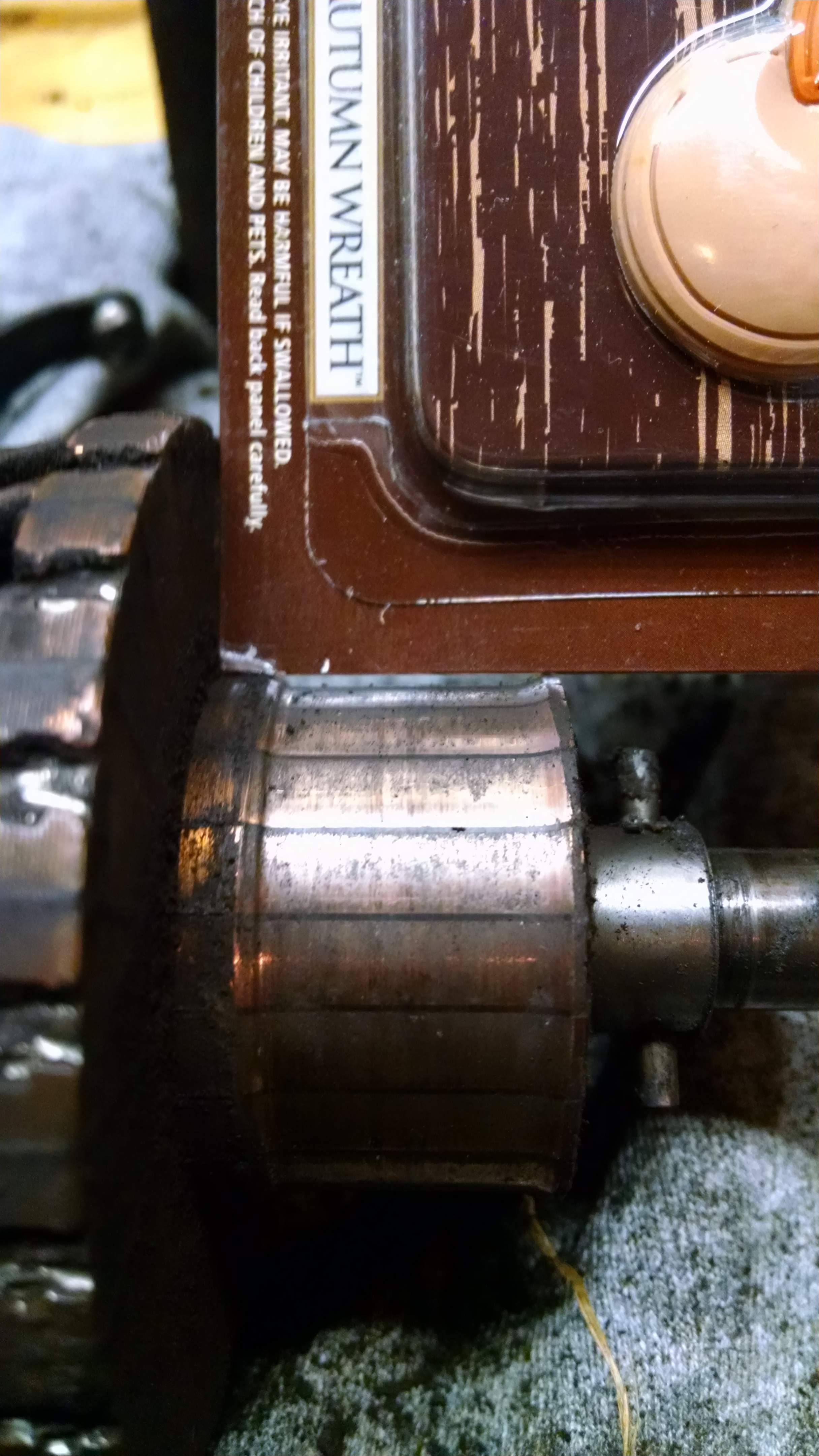

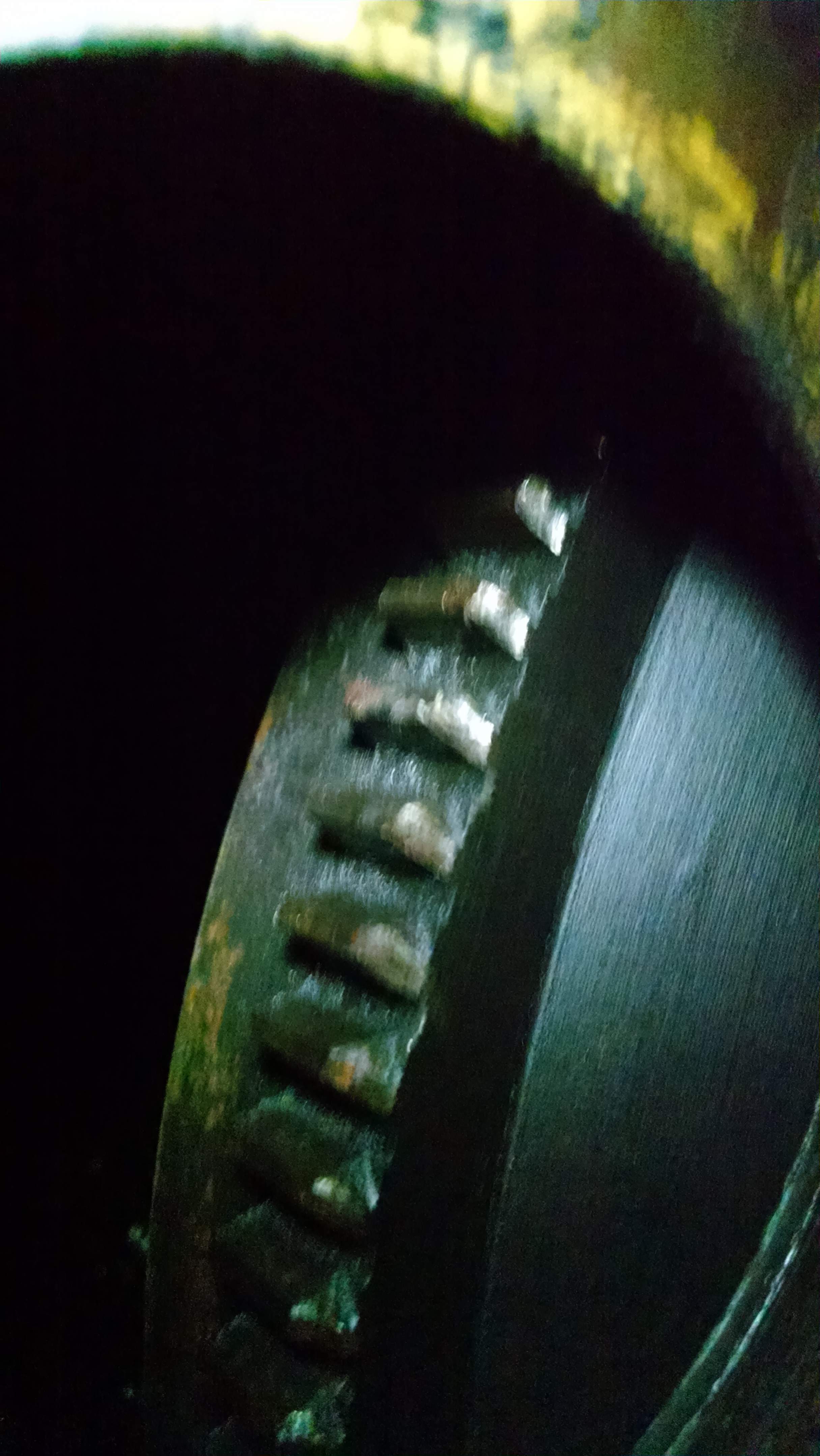

OK so got her home and got the old starter off and disassembled.starter needs a lot of work. So believe best route is to replace it. I can get a generic replacement for $151.00 plus shipping. Or get the Lucas (that's what's on it now) for $204+ s/h.
So looking for opinions, I'm leaning toward the Lucas but really have no inSight on this one.
Thanks!

The first pic is the flywheel. Has some burrs but I think I can dress it out OK. No chipped or missing teeth.then there's a pic of the split drive gear clutch and a pic of the armature wear.its pretty close to a 1/16" deep. Also wear on all the bushings and brushes are pretty badly worn maybe 50%?
   / 3500 starter clearance on diesel #16
Hard to tell on the pics of wear thru a phone. For the starter, I had my Lucas rebuilt, havnt seen the replacements. Do you have a local rebuilder?
