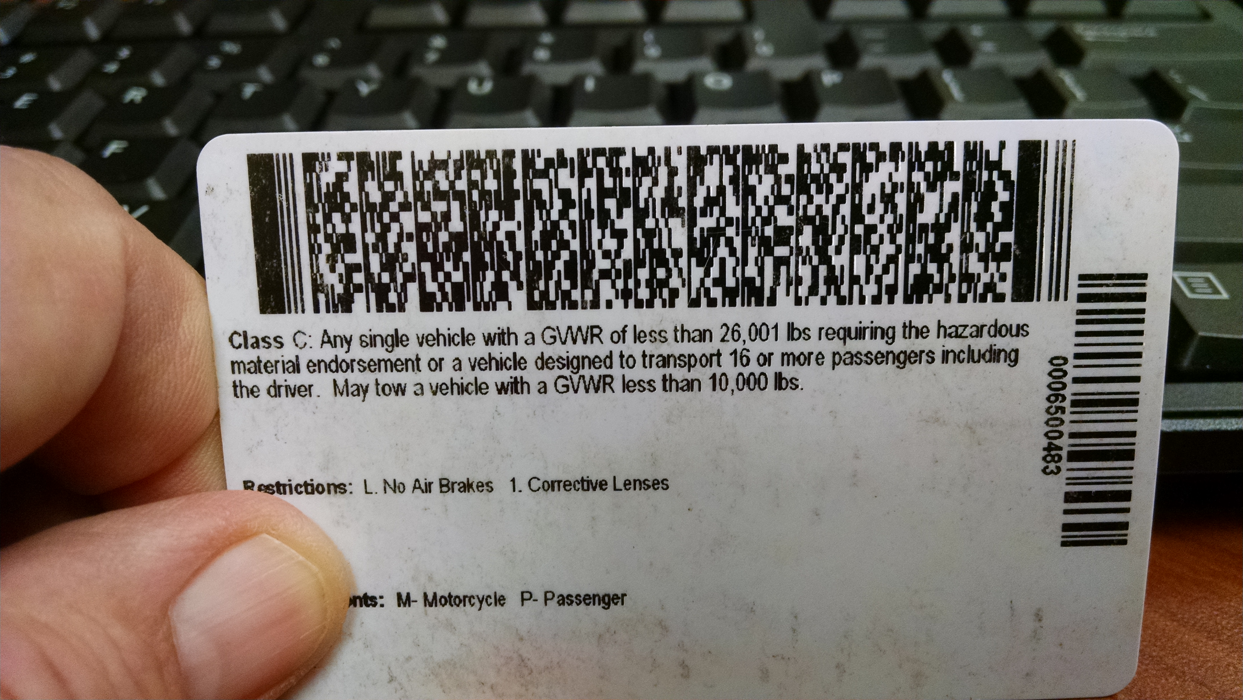

If your trailer is over 10K you must have Class A's or CDL's...
It states it on the license...
I live here...
I live here...
Is that a CDL?
IT is impossible to fit all the information onto a little card. You have to understand what that excerpt is refering to.
A class C is exactaly as your license describes. Any vehicle designed to haul haz-mat OR 16 or more passangers.
IF using a vehicle that fits that description as the tow vehicle.....you have to keep the trailer under 10k.
Fortunatally, a 3/4 ton or 1-ton p/u doesnt fit that description, therefore are not bound to the 10k limit. Just have to keep the combo rig under 26001
