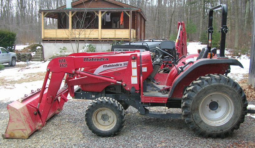

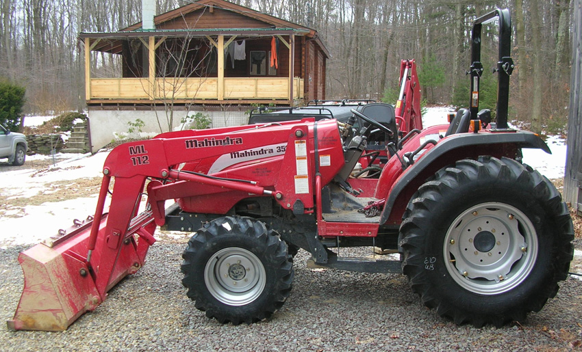

Dougster said:
Great photo comparison! :) I don't care about the lost 5 inches of digging depth... I still say you are TONS better off now than you were before! :)
Dougster
Thanks! I really like the results.:D :D
   / 3510 lift kit #22
Good lookin' upgrade! Just a note-- and I'm sure you've already thought of it, but here goes...just rememeber after about 5-10 hrs go back and retighten those lug nuts. I hit my 6000's front/rear and FEL frame nuts/bolts about every 10 hours with the HD Impact wrench. You'd be surprised how some will 'loosen' over time--especially the FEL bolts. Good luck! BobG in VA
   / 3510 lift kit #23
You've probably already know this but some of that extra height is due to the industrial tire vs. the ag tire.
Looks great, keep us updated on how it works out!
   / 3510 lift kit #24
Where did you get the 16" front wheels? Seems Mahindra has a Bastard size bolt pattern and hub size
