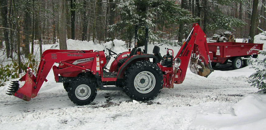

Looks a lot more agressive in the after photo. Can you tell any difference in the way it pulls?

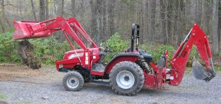

djw250 Don't mean to hijack your thread, but how does the 3510 handle the big hoe. I'm considering purchasing a BH, and I'd like to get the 509, but at almost 1500 lbs, its nearly half the 3510's weight. Any problems using it other than the ground clearance issue?
Thanks,
Dave

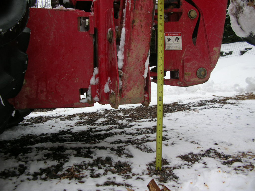

The limiting factor with 3510/509 hoe is the weight of the tractor. When I originally got the tractor. My first thought was I bought a backhoe with tractor attached to it-it's big. The 509 is a beast. I currently have a 24" bucket on it and it works fine.
I've wondered about the weight of this tractor. My owner's manual (3510/4110) lists the weight at 3881Lbs. I wonder why it's lower now?
As far as losing digging depth-5" or so-it doesn't concern me in the least.
BTDT Looks a lot more agressive in the after photo. Can you tell any difference in the way it pulls?
I've only had the tires on for a few days, I haven't really pulled too much yet and the ground is frozen-so I really can't tell. It drives the same as before as far as I can tell. BTW these tires are loaded and the other tires weren't.

That makes the tractor look much more aggressive, I like it! Did the added height affect the fel any? I remember getting my 3510 stuck pretty good. That's the biggest thing I had so for a couple seconds I was dumbfounded. Then the light bulb went on, use the FEL silly. I clawed my way out, but with the extra few inches, would'nt one lose some downforce with the loader?
I like the bigger front tires, it seems with a full bucket of damp clay soil, I need a wider front tire that won't sink as much. Of course the taller tires in the back would be needed also, to keep the gear ratios in line.
But think of the extra lift height he gets! :D Seriously, the ML112 FEL is equally at home on a 3510 and a 4110... the latter being the dimensional equivalent of what he just built! :) I have never had a problem with the ML112 on my 4110. If anything, I believe it should work a little better for him at this tractor height.

I finally got around to hooking the 509 up, to get it out of the snow. It's about 5" higher than before, almost double what it was before.

Great photo comparison! :) I don't care about the lost 5 inches of digging depth... I still say you are TONS better off now than you were before! :)
