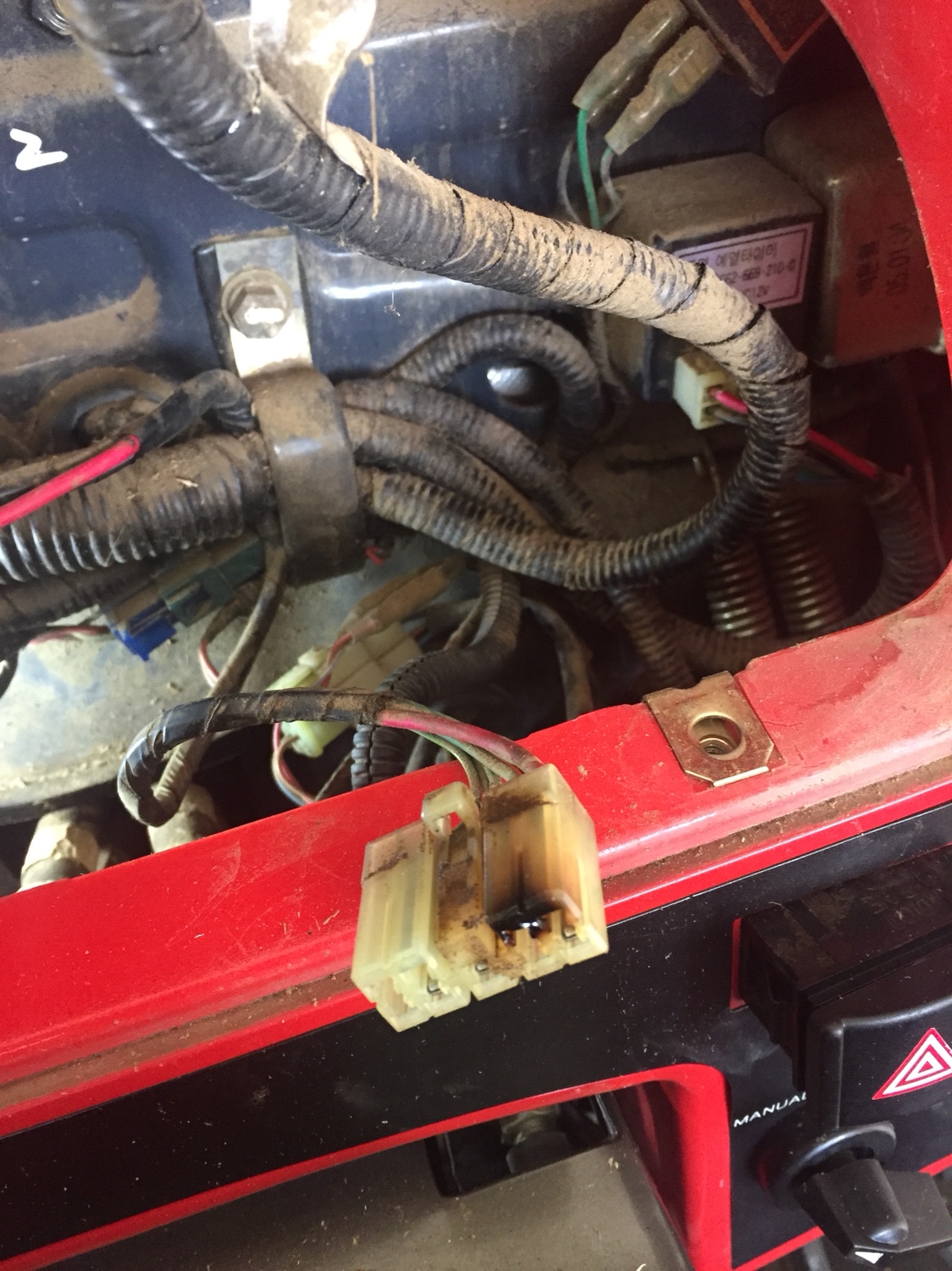

Sep 14, 2018 / 3510 questions Thread Starter #12 OP zilla24 Bronze Member Joined May 10, 2007 Messages 85 I've been through just about every connector on the tractor so far, cleaned, greased and reassembled with no luck. Guess I'm going to try a key switch next.

Sep 14, 2018 / 3510 questions Thread Starter #13 OP zilla24 Bronze Member Joined May 10, 2007 Messages 85 Think I found my problem
Sep 14, 2018 / 3510 questions #14 K Keith_B Platinum Member Joined Dec 21, 2004 Messages 784 Location Kentucky Tractor Mahindra 4110 zilla24 said: Think I found my problemView attachment 570918 Click to expand... That looks like the probable culprit.
Sep 14, 2018 / 3510 questions Thread Starter #15 OP zilla24 Bronze Member Joined May 10, 2007 Messages 85 That’s the harness for the hazard switch. Unplugged it and the dim lights go out. Going to order a new switch and see what happens.
Sep 22, 2018 / 3510 questions Thread Starter #16 OP zilla24 Bronze Member Joined May 10, 2007 Messages 85 Replaced the hazard switch, good to go now...
