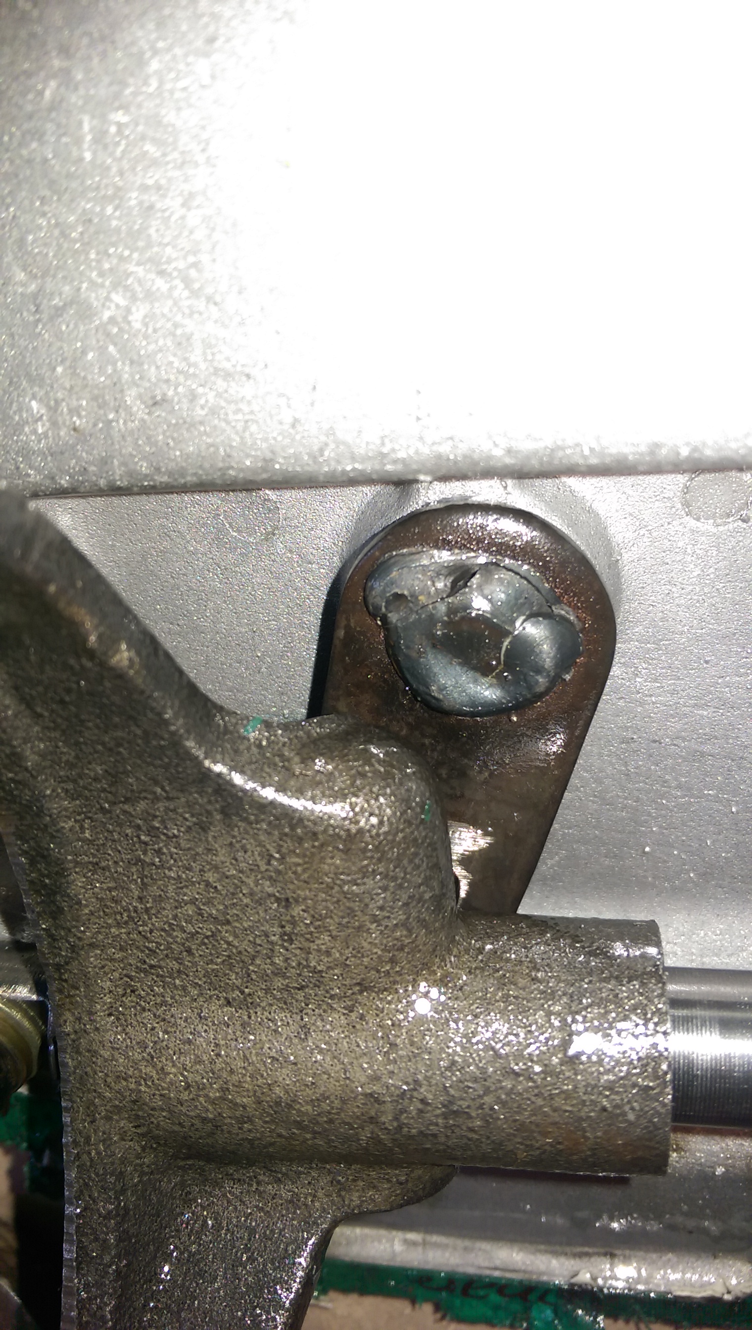

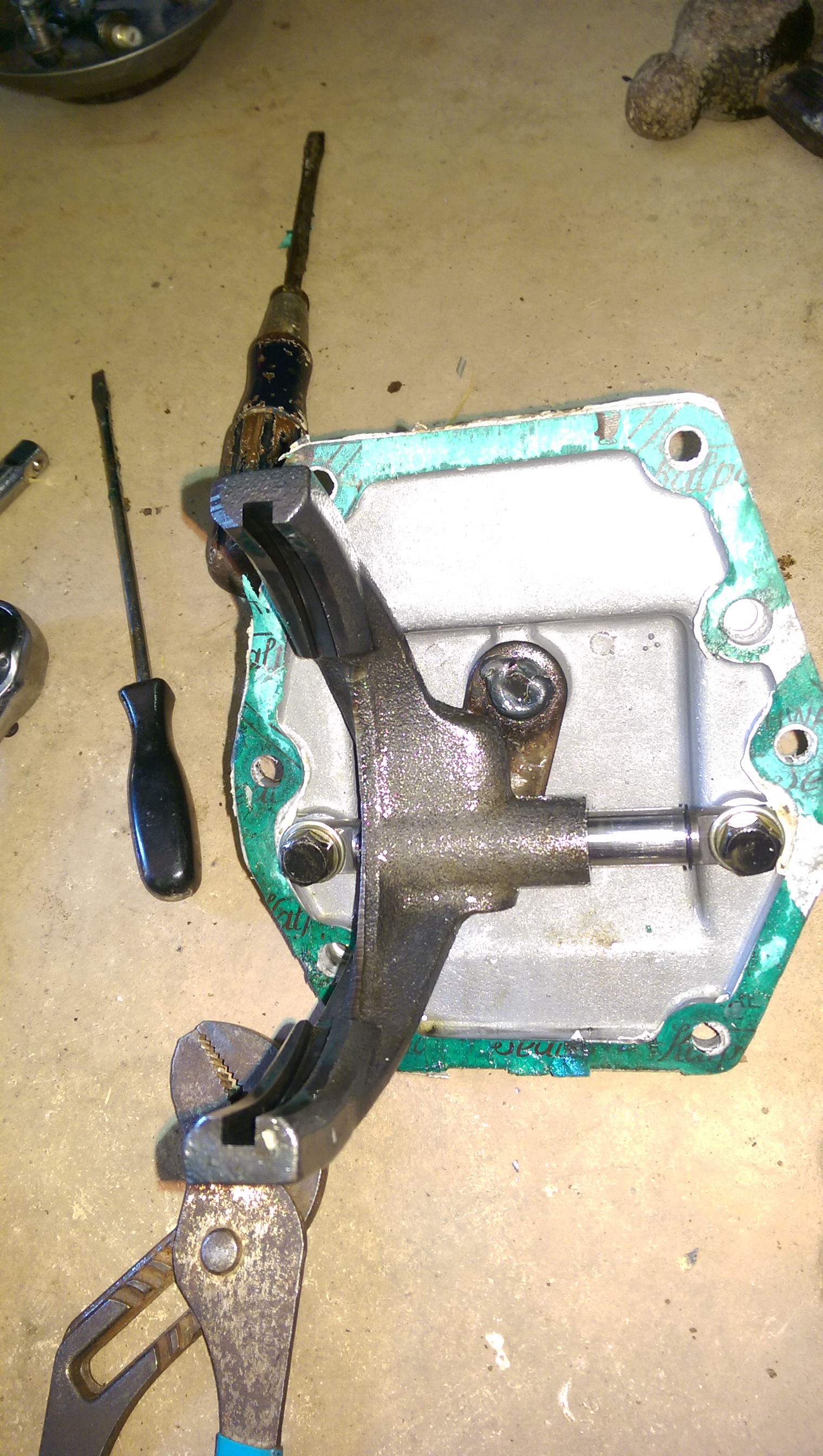

3510 Shuttle Clutch Failure and Repair- PICS!
Here are a few pics.
The inside lever that moves the shuttle clutch fork had on really CRAPPY weld! :mad:
We'll be welding her up tomorrow. BTW, forget about removing the exterior pin to the lever/shaft. I think it is a welded pin, couldn't even drill it out :eek:
Now I'm looking to find a new gasket for the cover. Any ideas?
