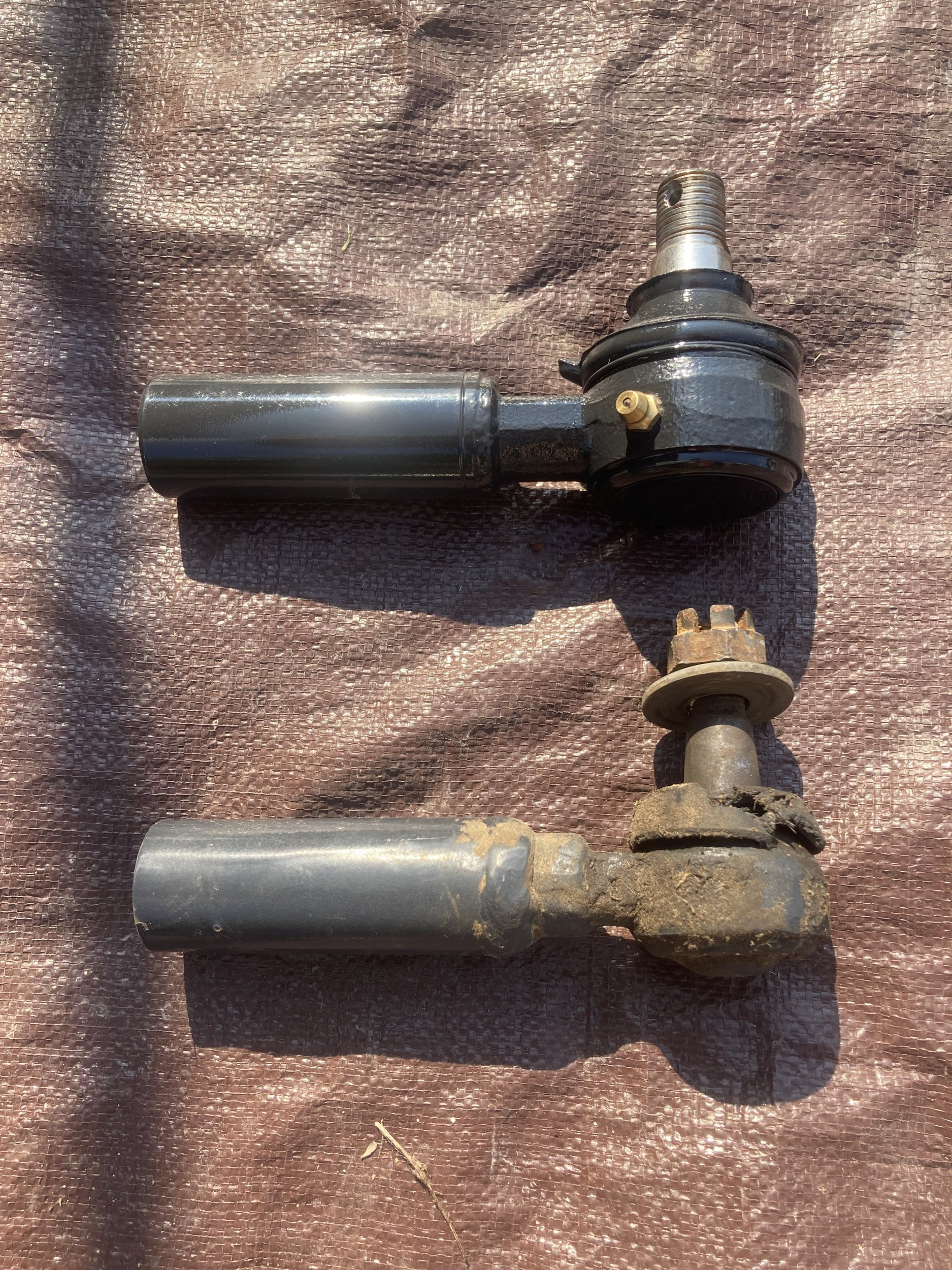

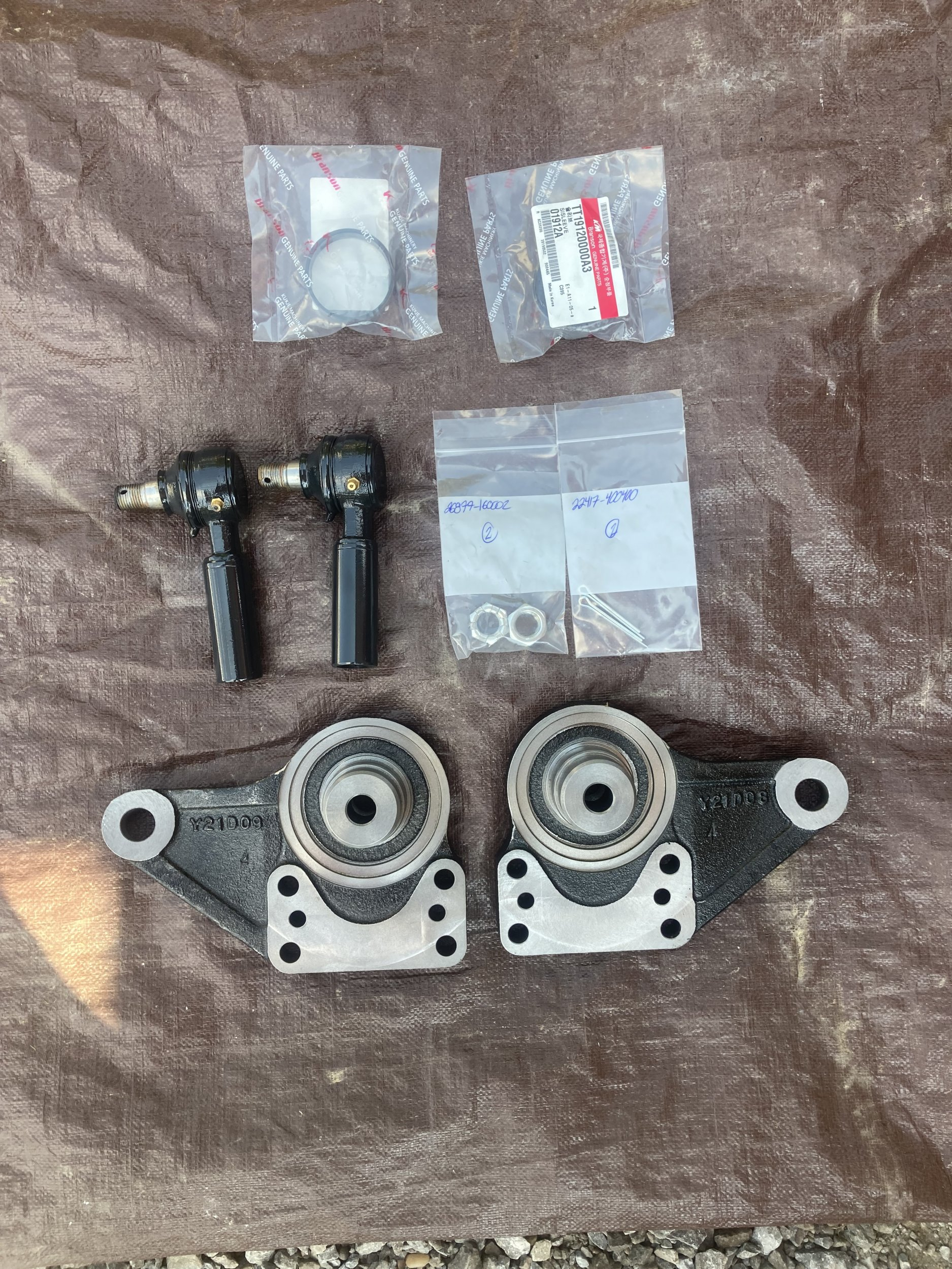

Parts arrived today, all was correct, pretty easy install, I plan to add a washer between the new knuckle and the castle nut, seems like it should be part of the upgrade kit. Here’s a picture of the components of the upgrade kit and a pic of old vs new tie rod end.

Looks good! I need to call them about the right side I did not receive yet. Sure looks like they must have them in stock. :ROFLMAO:

K5lwq, I was surprised they came so quick, I sure hope you get the correct one owed to you! I made sure to open it all up in front of the parts clerk, after your ordeal.
