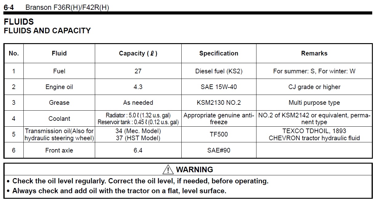

First of all, 6 liters of oil on that engine is way more than it needs. Not sure where you got the 6.1 L number. This engine will take 4.3 L according to the manual. I'm looking at the manual for my tractor which is a F36R ( same as 3515 over in the US) but the engine is the same as yours.
I would get the proper oil quantity and rotate the engine by hand for a couple of turns to check if it is not seized. I believe you can get a wrench on the front pulley nut.
EDIT: For some reason, it says 6.1L on the TractorData website. However it seems awful lot for a 1700cc engine.
Here is a screenshot of the manual for my tractor.

Interesting! I'll go try this now. The previous owner (who misplaced the owners manual) told me it took about 6L of oil and online I've seen anywhere between 4.3 to 7L. I guess because I never had an issue before using 6L of oil I figured it seemed reasonable.

I refilled with new oil and hand turned the engine to make sure it wasn't seized. Took the necessary safeguard steps and decided I would try to restart the tractor. Great news was that it started up as usual, burned off a bit of residual oil quickly and then performed as it always has. Idled up to pto speed and back down with no issues. Thank goodness!
