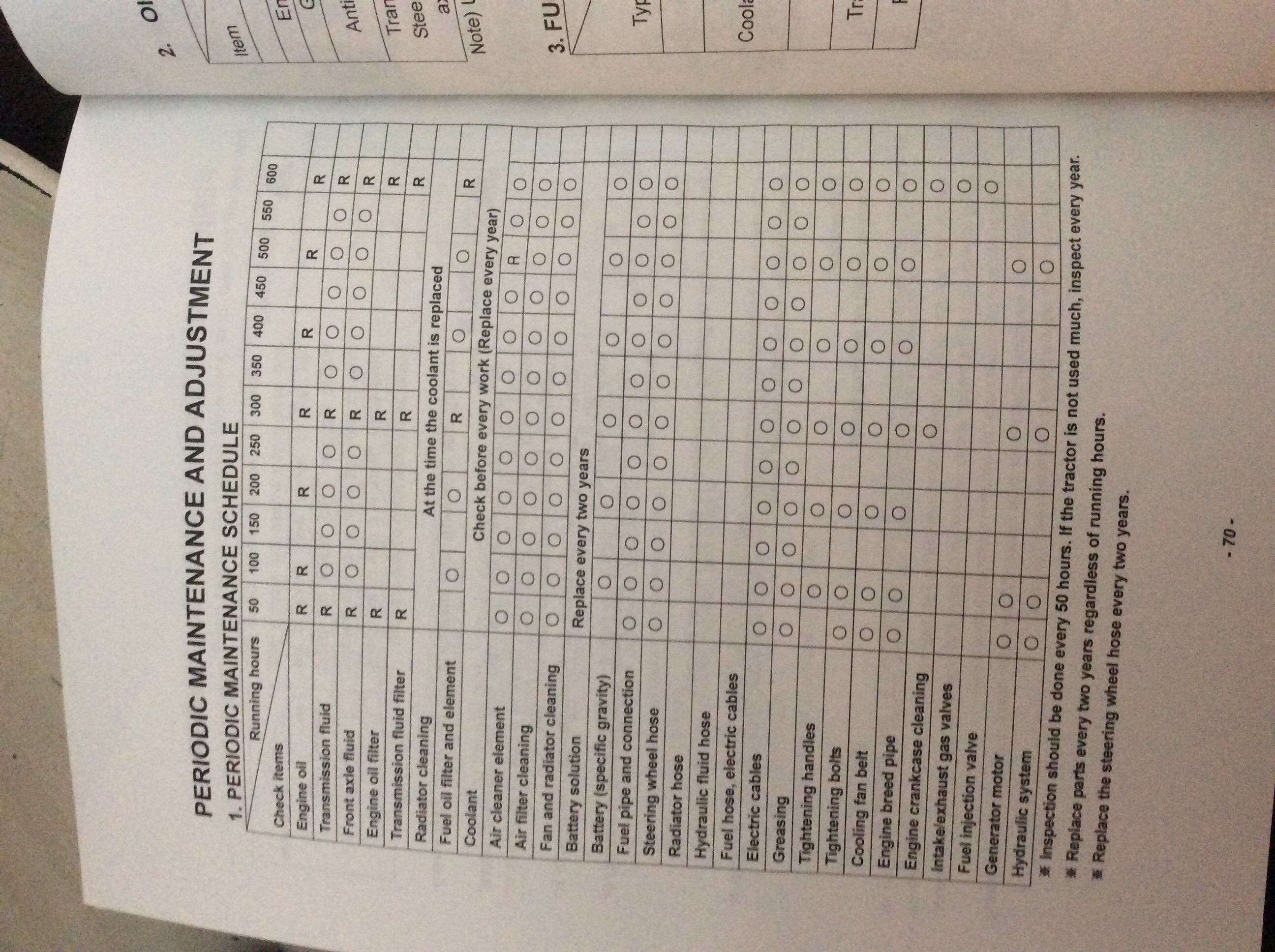

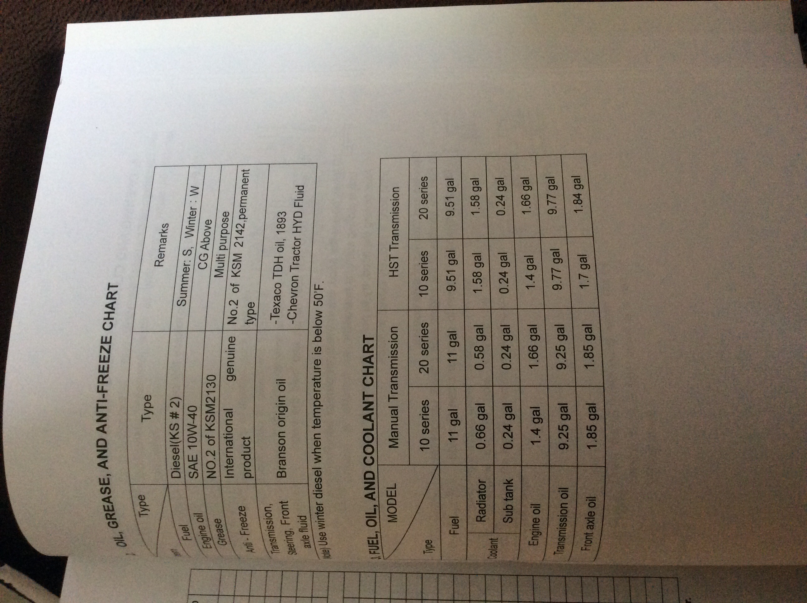

Some of you said it was hard to find info on the 10 series and I agree. I wound up finding an owners manual. Here is the info on oil from that.
   / 3510i runaway engine #23
So that's about 5.3L, give or take, quite a bit to 6.1L. It could or could not been the cause of the runaway.
