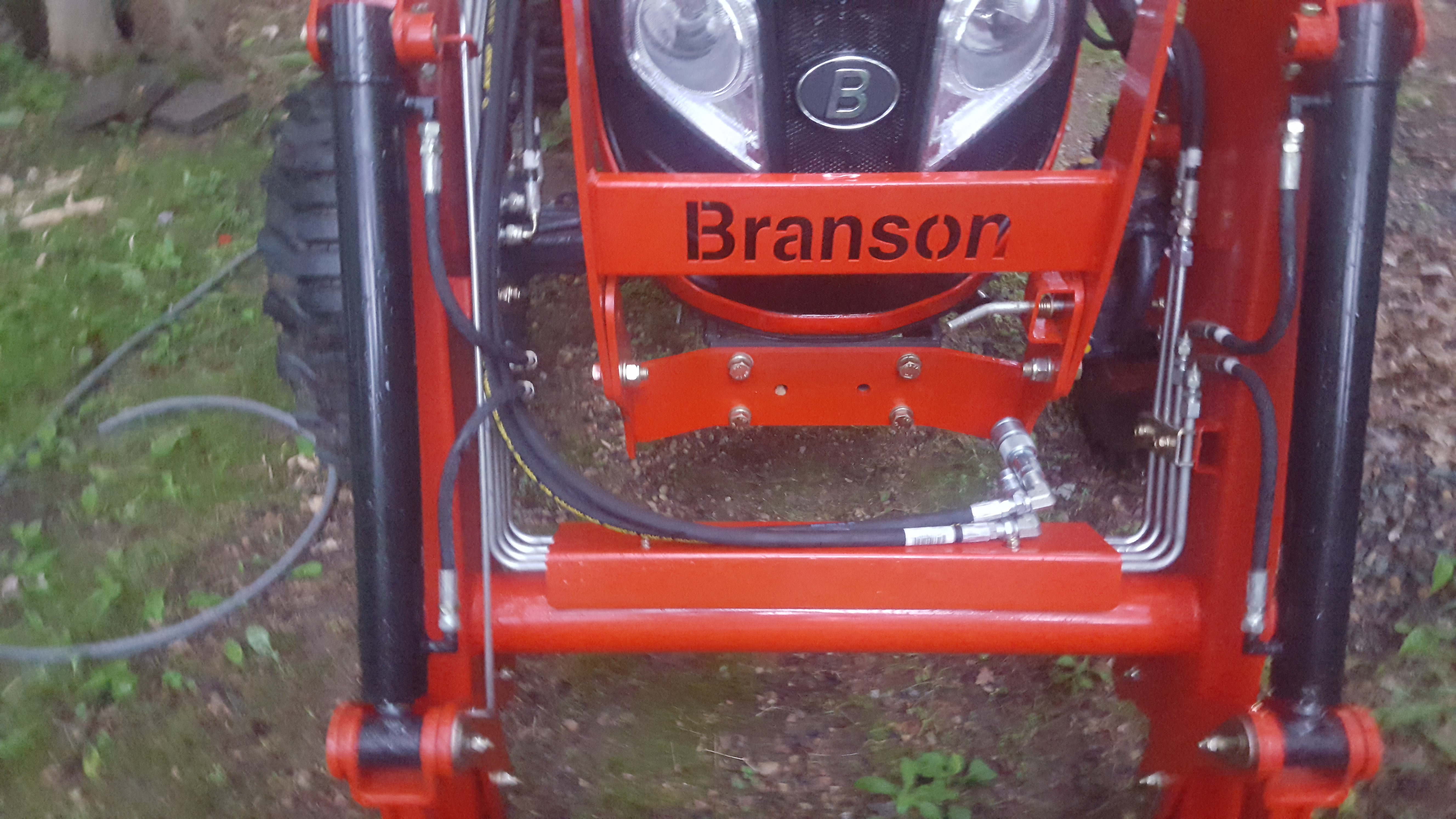

I think your idea of mounting the diverter by the loader valve will be fine. There will be two lines running forward to the quick connects for the implement. With the diverter out on the loader torque tube you'd have two lines running forward from the loader valve to the diverter and then two more running back to the end of the hard line near the loader valve. That's how the Branson factory diverter I saw a picture of was set up. You could remove the hard line completely and just run hoses from the diverter to a tee and to the cylinders, but that's more work.

If you can remove the tee's in the curl hard lines on the right hand side of the loader frame,
then using elbow fittings run 2 short hoses to the diverter valve and 2 short hoses from the straight thru ports of the diverter back to the curl lines with the tee reinstalled in the lines for the curl cylinders then your quick connects can either go directly into the diverter valve or short hoes to were you wish to mount the quick connects.
That is just one way to do it.
Your proposed way will work just fine also.

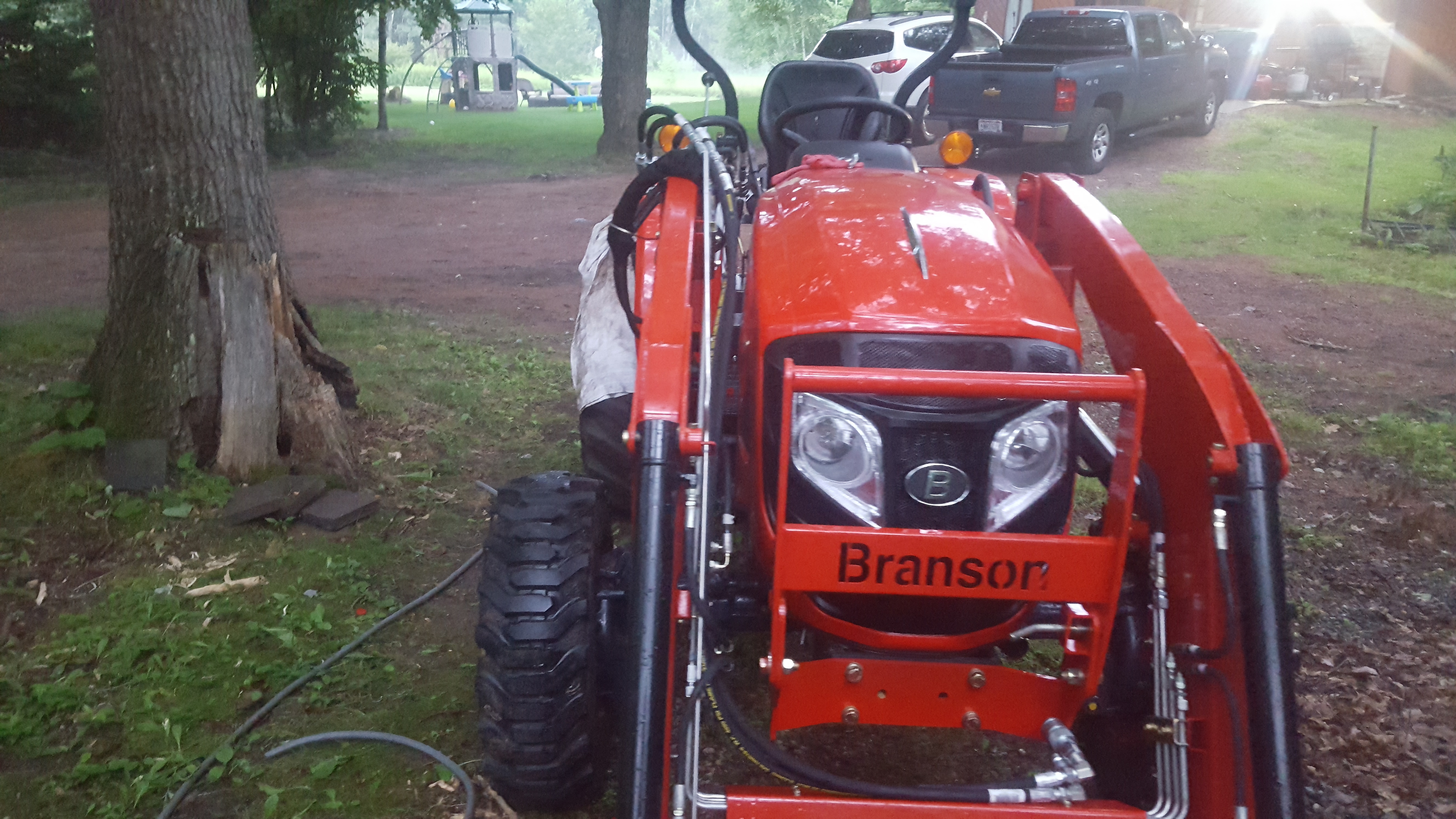

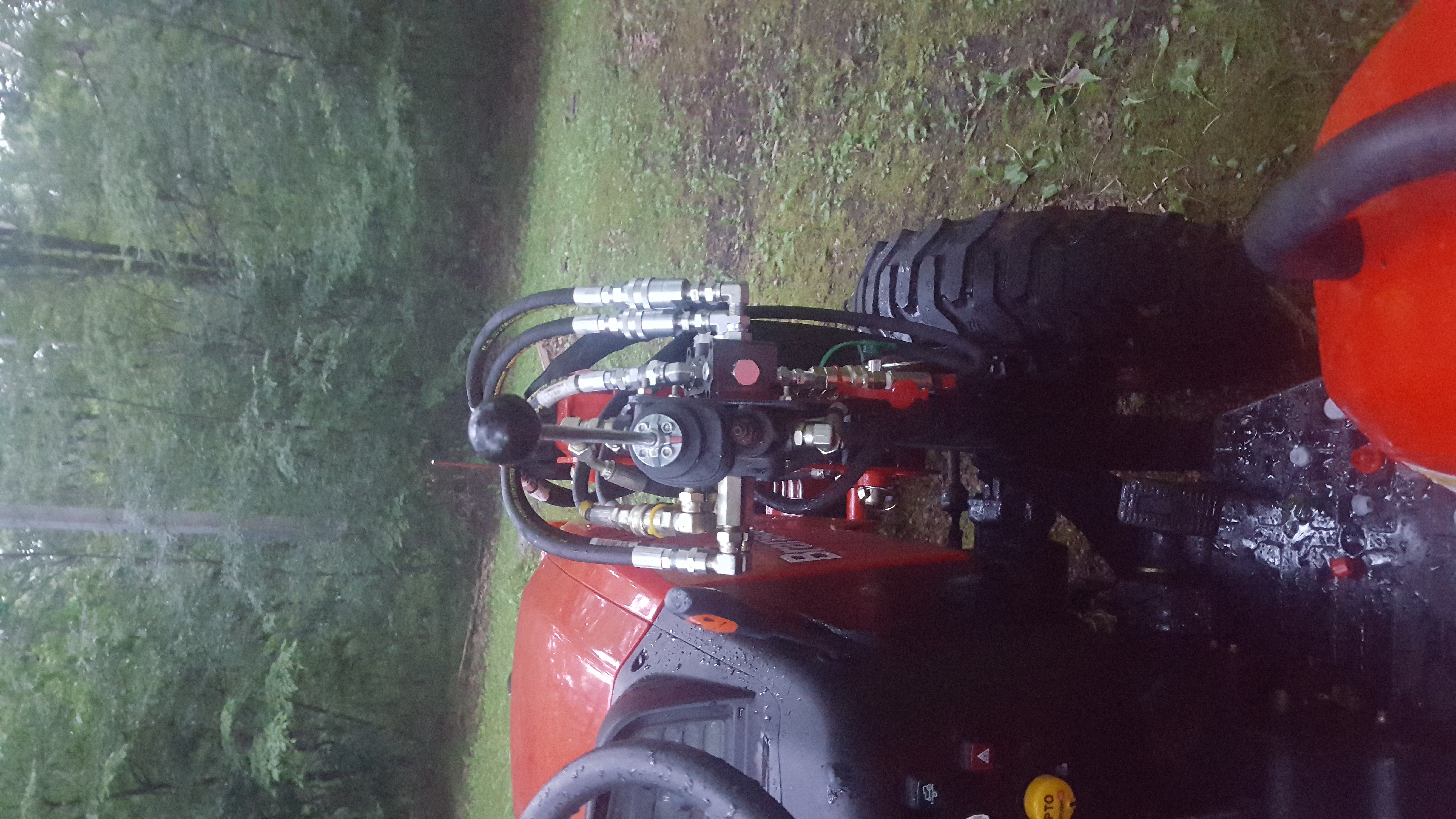

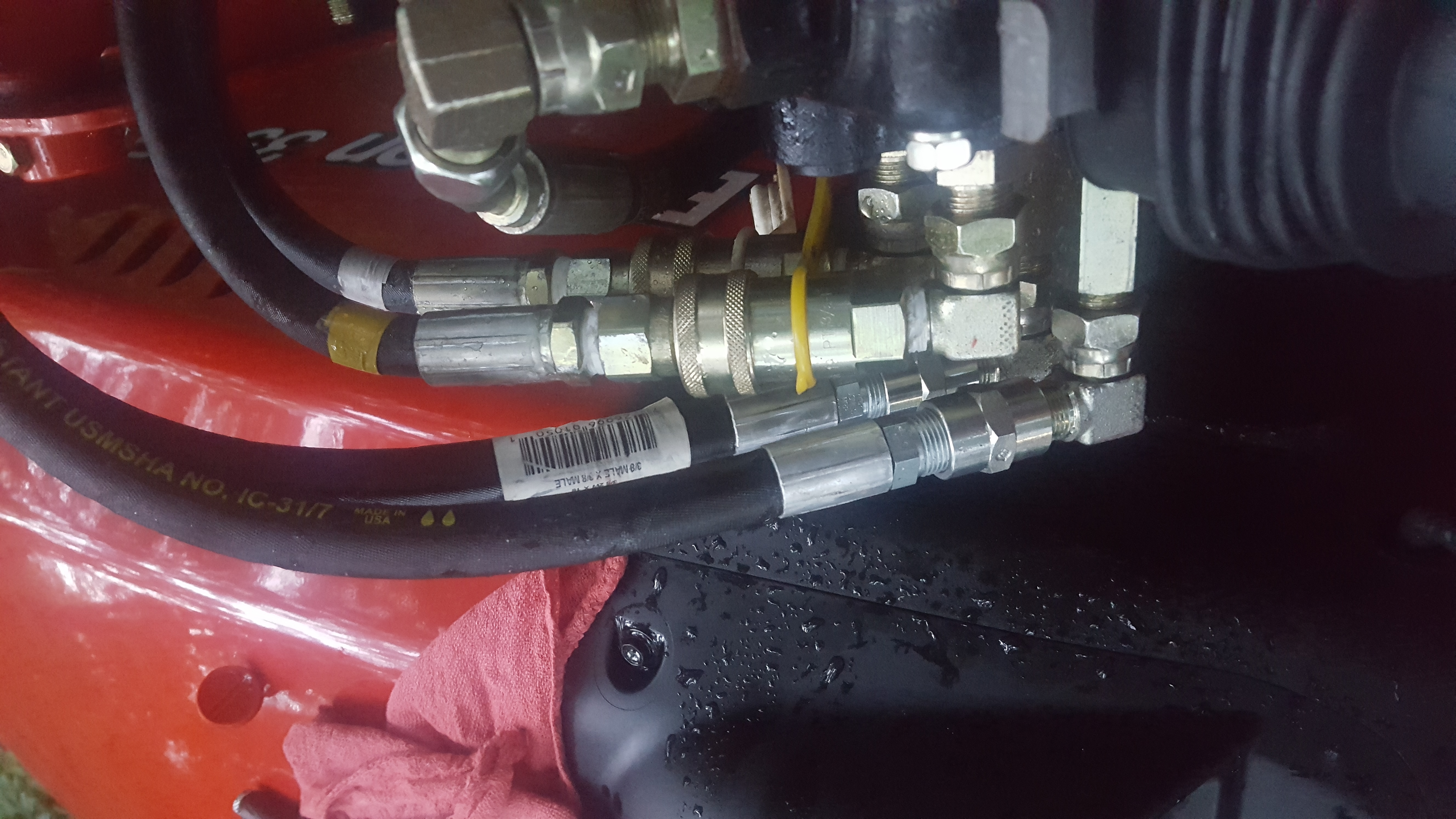

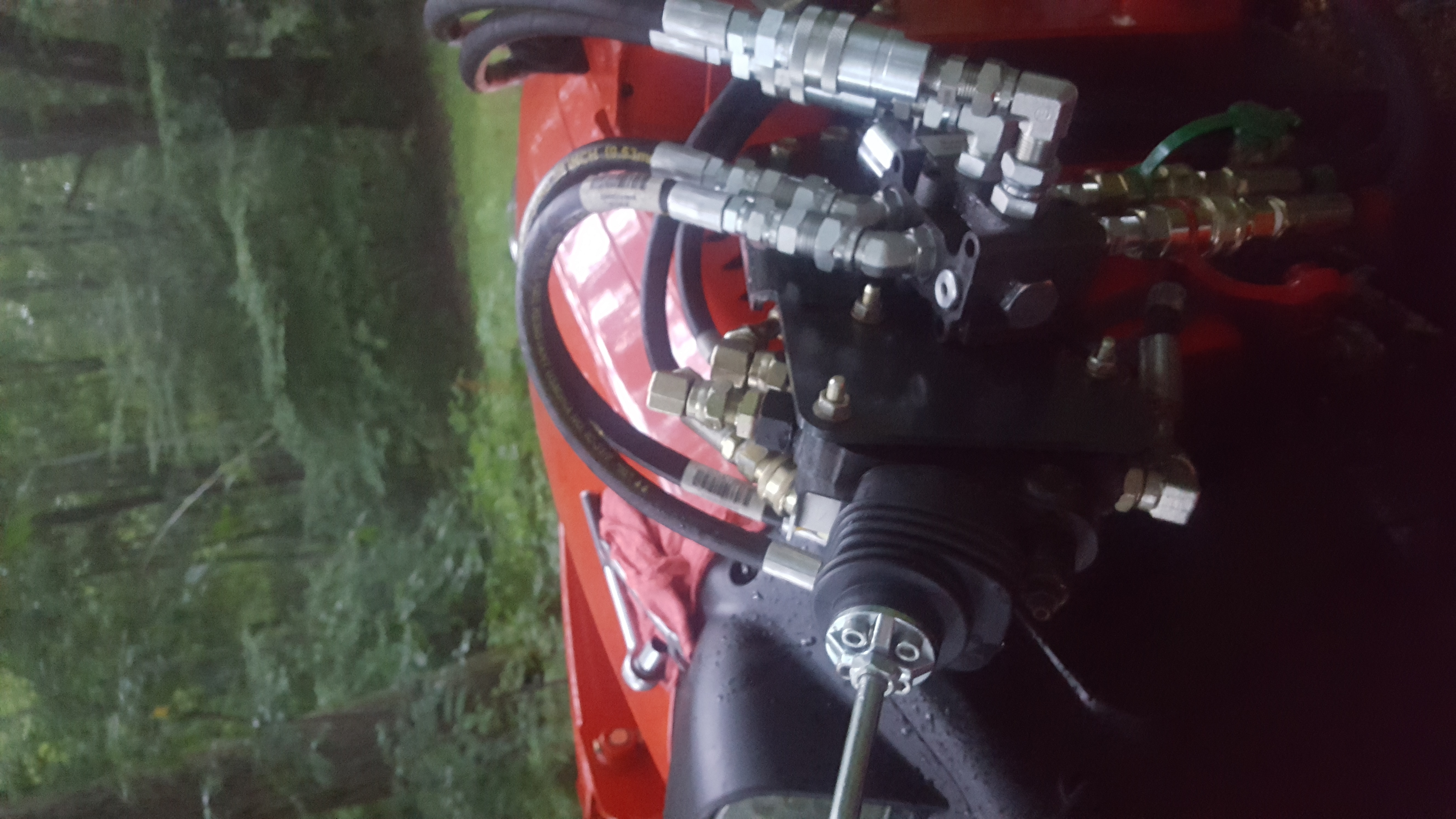

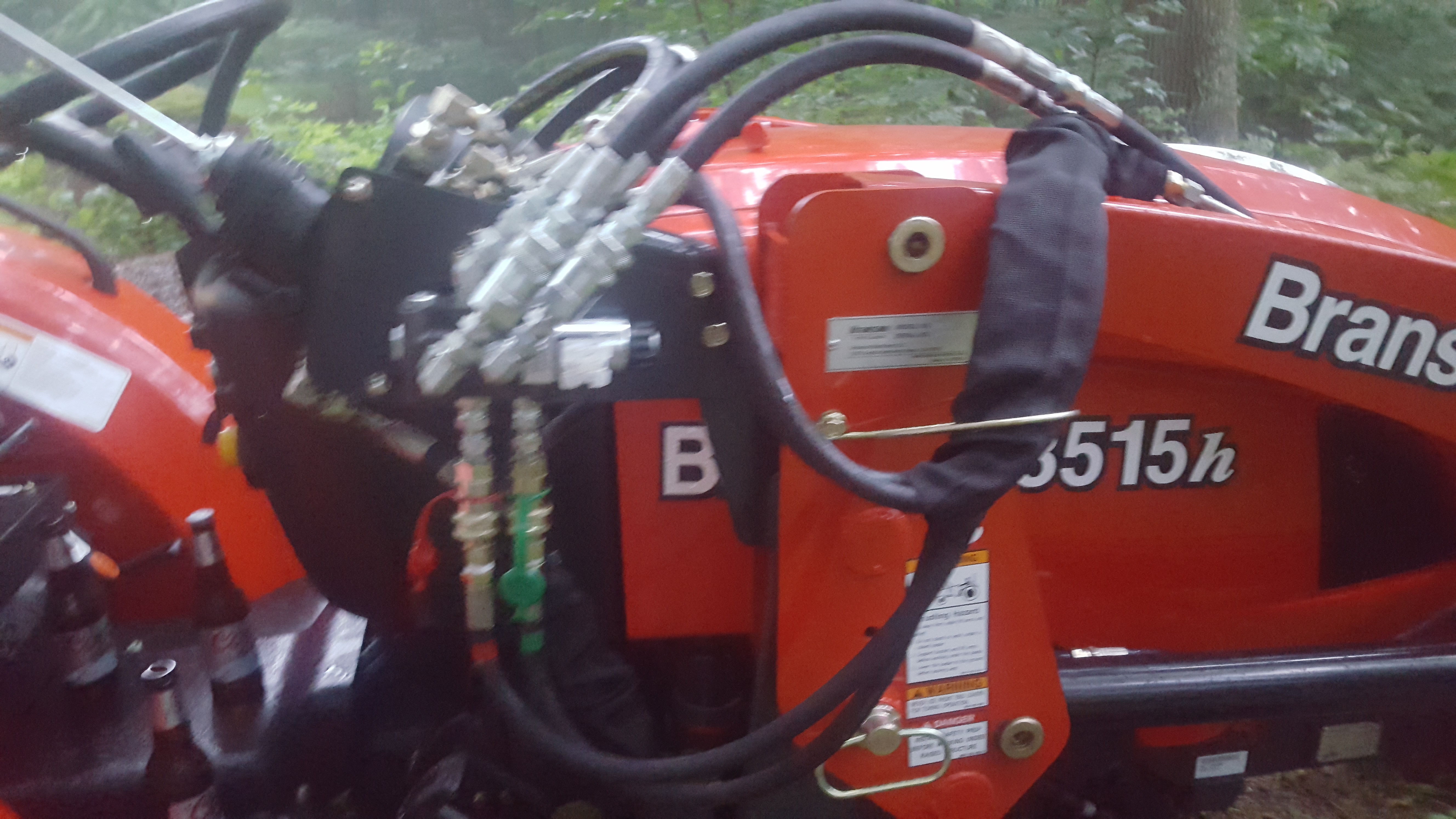

Well, I think I got the hard part done, now just need to install the electronics, tighten it all down and secure the lines

Thank you. It actually looks better in person. Lol and like a jack ***, In my haste to test it all out, I forgot to put thread locker on and snug everything up, but it did all work, fountains of fluid and all. I'll disassemble and thread seal and snug all connections tomorrow.
