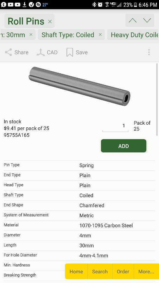

Instead if standard split roll pins, consider spiroloc pins. Thinner layers of SS spiralled 3 turns or so.
Do you happen to have a source for 4mmx3mm ss spiro loc pins?
I don't find meyric pins in SS. McMaster Carr is your friend. I assume you meant 4 x 30mm

Yes, 4x30mm. My son uses McMaster Carr a lot and i've bought from them before also.
Thanks for the info!
