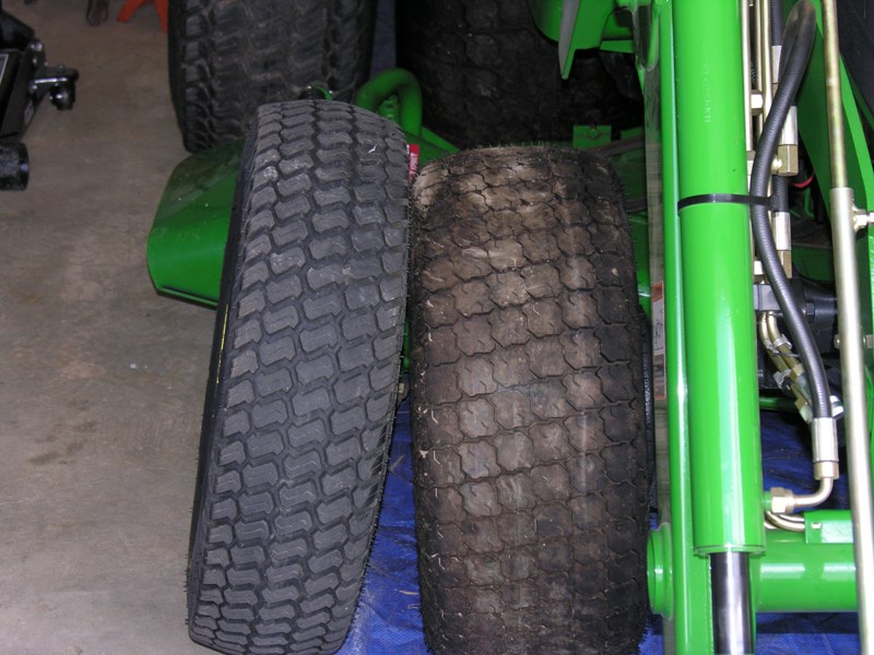

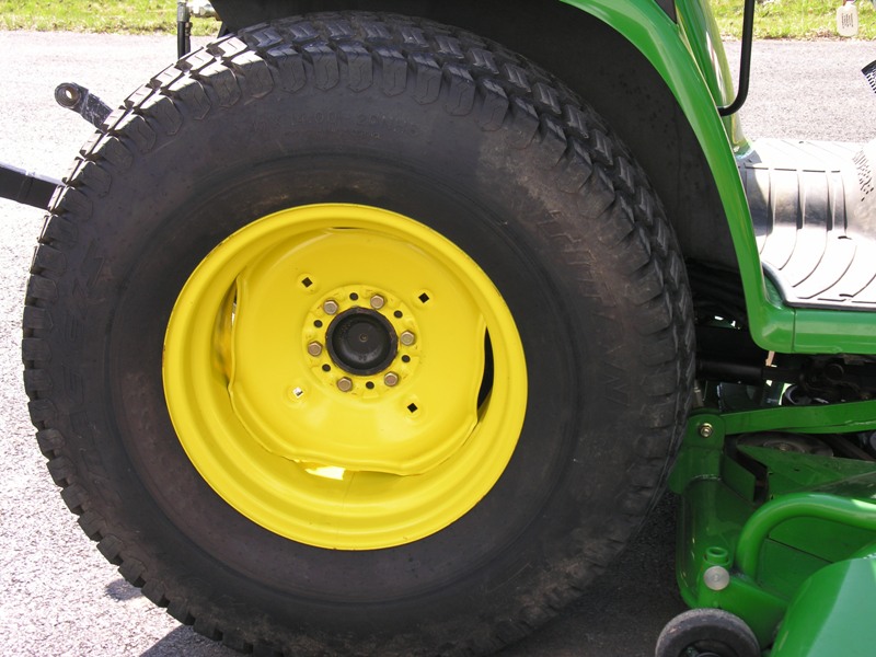

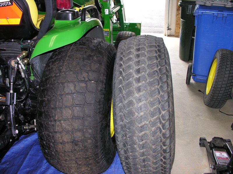

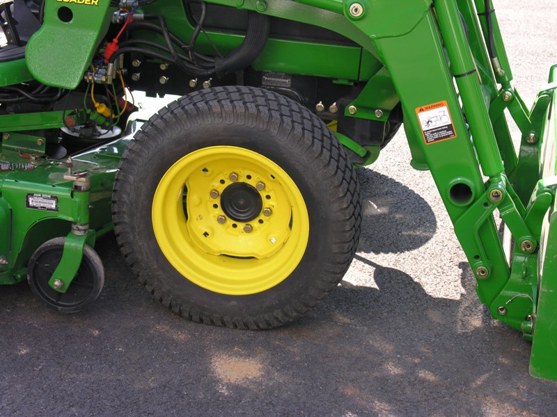

CinderSchnauzer, Actually yes it does. The Turf Specials are wider than the R3s, but they are 41 inches tall so they sit lower than the R-3s (well at least the ones that came with my 4310). See the comparison pics I attached from the 4310, the Turf Specials are the fat short tires. The normal R3s are the thinner taller ones. I also included a pic of the front tire comparison and it that the Turf Specials are wider but not taller. I have pics of the clearance of the regular R-3s on my former 4310 and it is quite close from thise pictues so maybe it is potentially the same situations and they will actually work?
The indication from the dealer and the JD specialist is that there is interference with both front and rear tires. They did not tell me if it was when raising the MMM, or just interference period due to the width of the Turf Specials. Apparently the wheelbase on the 3x20 series is shorter? On my former 4310, I did notice that there were times the front and rear tires would touch the deck, and the deck would bounce around. But nothing serious. So I am gonna see how the deck fits and then see what happens when I add the turf specials on the front and back.

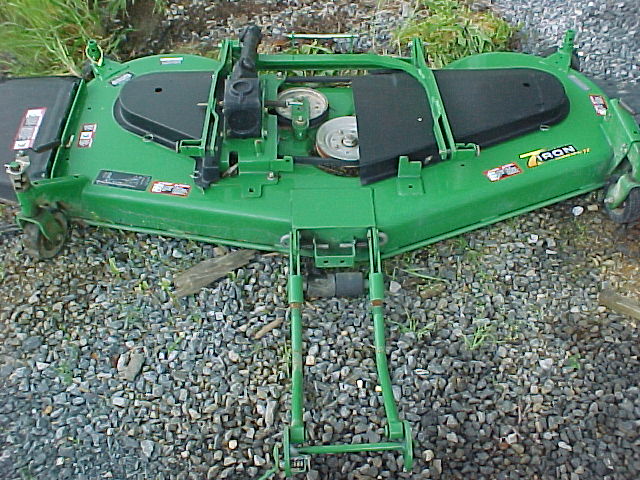

But on the 4310 they fit and only occassionally slightly rubbed when I was mowing in a vertical angle or if the deck went into a bouncy mode on very uneven ground. But that was so rare and I did not even know it until after I stopped the unit and examined the deck. and you can see from the pics that the original R-3s on the 4310 were pretty much as close as you are describing and the turf specials went on with out any issues and performed well. My only concern is the different position of the gauge wheels on my old non-7 Iron deck for the purpose of comparison. The deck I found is a 7 Iron deck, so I would imagine it is the same as yours. If it is clearance and the same scenario exists like the 4310, then it might work without any modifications and that will be fine. I am keeping my fingers crossed:rolleyes:

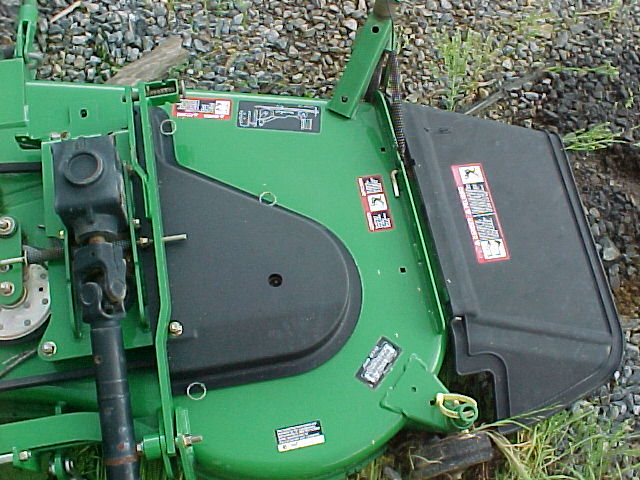

Here is a pic of the one I found.

At first glance, the deck in your pics looks exactly like mine. It's currently noon and spritzing rain here. If it doesn't get too much worse I'll head out to where the JD is and take some pics. I wanted to do the pics outside for better lighting. If I get some I'll post them later - probably after 2100 hours local time.

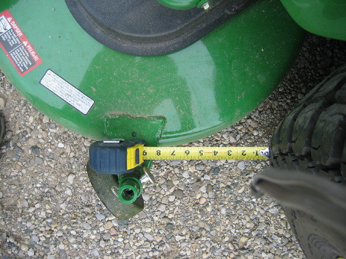

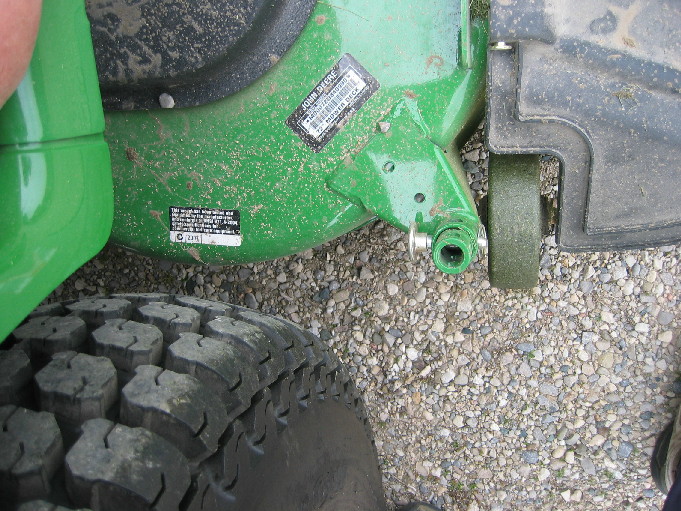

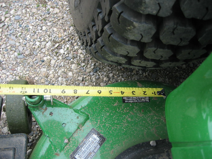

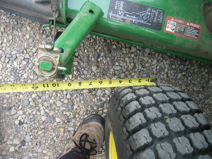

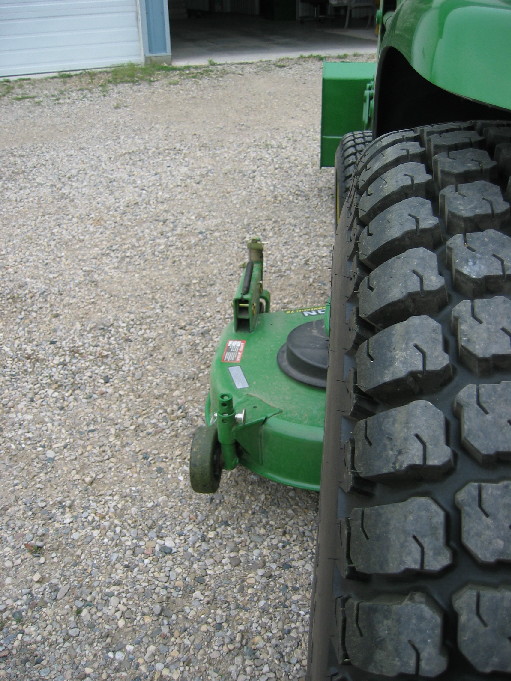

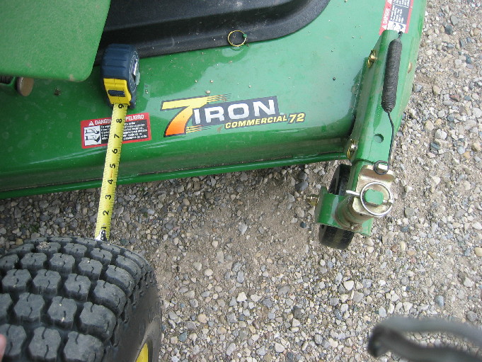

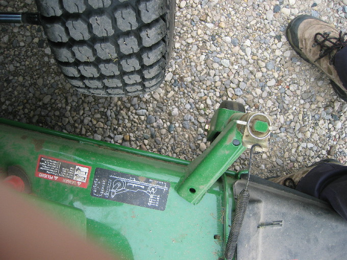

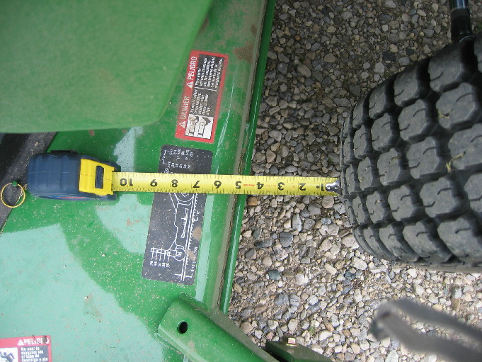

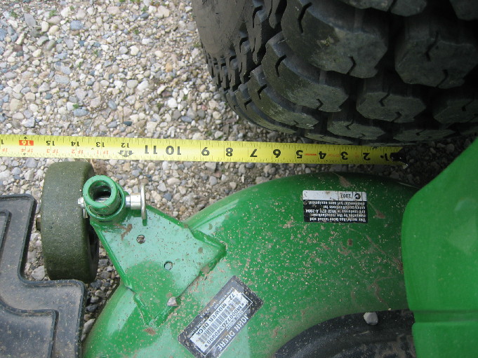

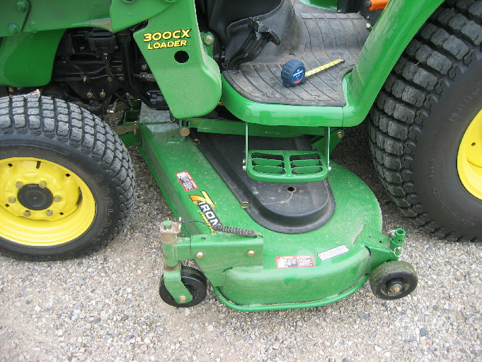

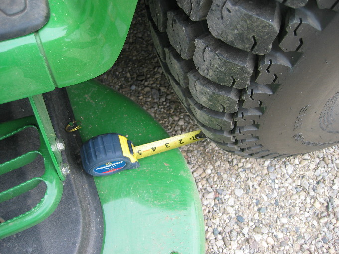

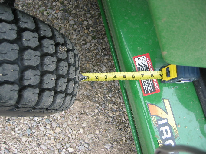

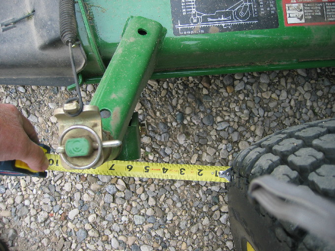

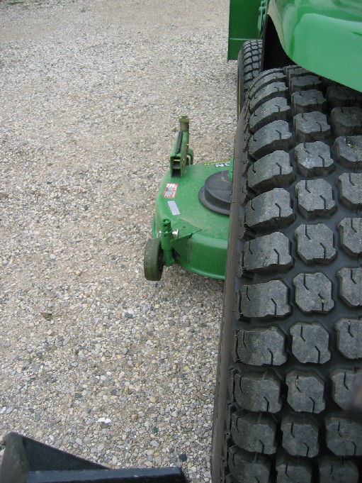

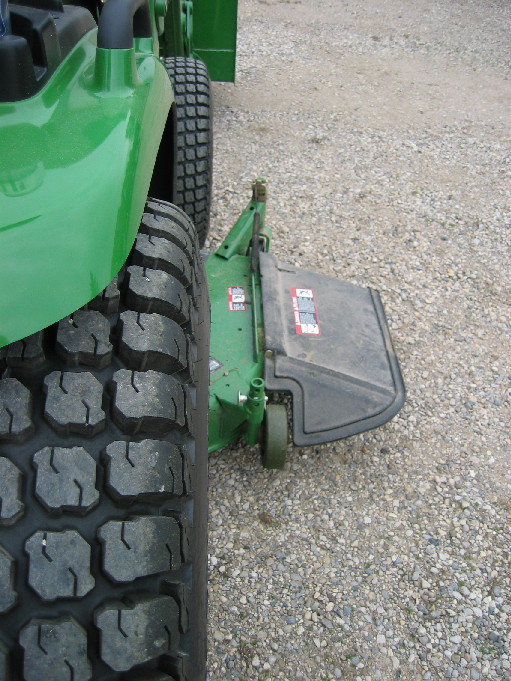

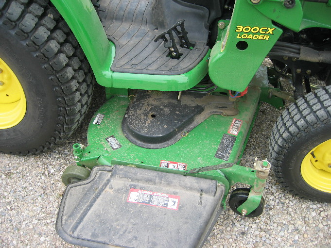

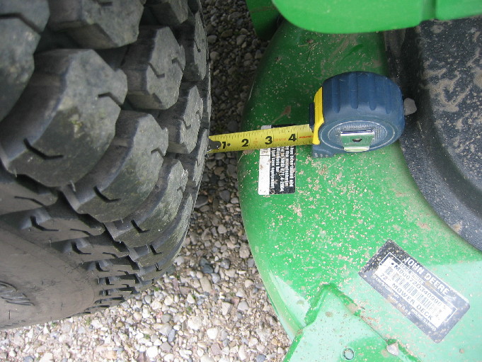

Nuru - here are some pics from this afternoon. Left / right / front / back. These have been resized to around 150 kb each. If you need the originals drop me a PM and I can send them. Originals are about 1 MB each. If you would like any other angles please advise. All pics were taken in full up position.
If the GT's are smaller in diameter and fatter, I'm betting they will fit despite warning from JD.

CinderSchnauzer, gee thanks for the pics!
The tires are
rear 41" tall and 16" wide
Front 25" tall, and 10.5" wide
First glance, It looks like the tires in the rear might make contact with the rear gauge wheels, if your tape is measuring from the inside edge of the tire. If you are measuring from the middle of the tire then the tires might just fit without issue
I think your fronts are 8" and your rears are 14". Are your tires set on the widest setting? If so that is good, as that will provide even more information for me. As the clearance running might be okay.
