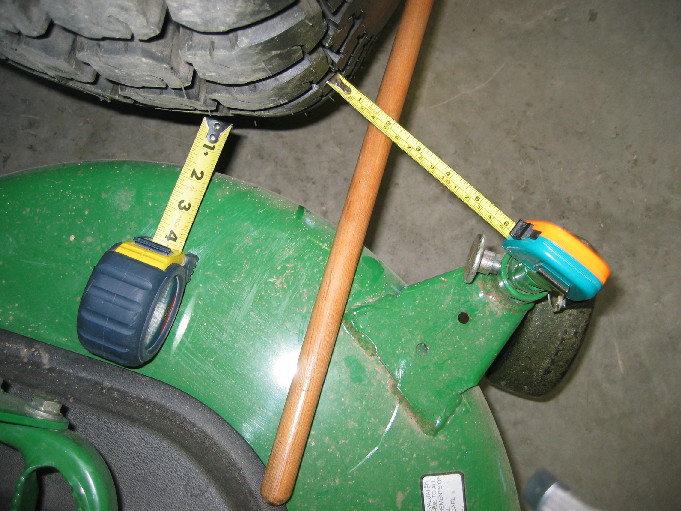

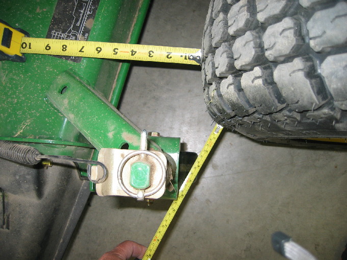

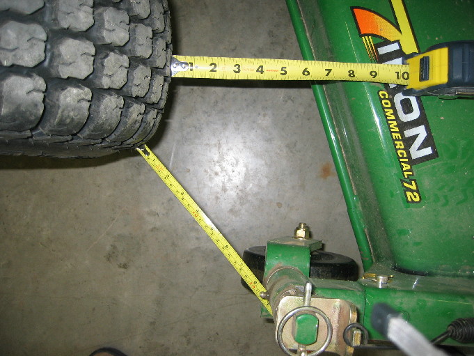

Also aren't your tires 41" tall, 14" wide for the rears and 27" tall, 8.5 wide? Then it really looks like it probably will work unless the offset of my wheels is so different it makes the tires not work. I am keeping my fingers crossed.
   / 3520 and MMM and Super Turfs? #12
Most of the measurements were from the middle of the tire, except for 2 that were from an outside edge to a gauge wheel.
Fronts are 27 - 8.50 x 15
Rear 41 - 14.0 x 20
The pics were all taken with the wheels in the narrow position, however, today it was raining and with nothing better to do, all the tires were moved to the wide postion.
Unless, as you say, the wheel offset is way different from the R3's I wouldn't think another 2" width would be a problem.
If you would like, I can take another set of pics in the wide postion - but not until Monday. Let me know.

Yep, i thought the tires sizes were correct, thanks for supplying those. Oh, if you can, yes those pics would be great from the wide position. That is interesting as one of the JD mechanics was not sure but thought there might be a possibility that the MMM would work only with the tires at the narrow position, seems you havve put that to rest.
The pics from the Wide setting would provide an even more conservative view of the clearances. Right now it looked like there was a lot of clearance. Those pics of the 4310 I uploaded were with the tires all set on the widest setting, and the clearances were fine.

Here are the new pics.
MMM is in full up position.
R3's are in Wide postion.
Broom handle is touching outer edge of tire.
Right Rear looks like the spot with greatest potential for conflict.

Nuru
Bad News. After all the pics and measuring, I had time to take the tractor out of the shed. With the front R-3's in the wide postition there is interference on hard turns, both in the full up and cut postition. The Gauge wheels are not the problem. On a hard turn - either direction the tread of the tire that turns in towards the center of the tractor hits the mower body.
If you look at the pics you took of the mower the interference point is to the inside of the "Danger" label, an inch or two towards the middle of the deck from the weld on the mower lip. On the left side, for example the contact point is approx. 14" in from the center of the tire, measured with tire straight forward.
Hills and perceived stability are not a big factor for me, so I think I'll switch the fronts back to narrow position.
