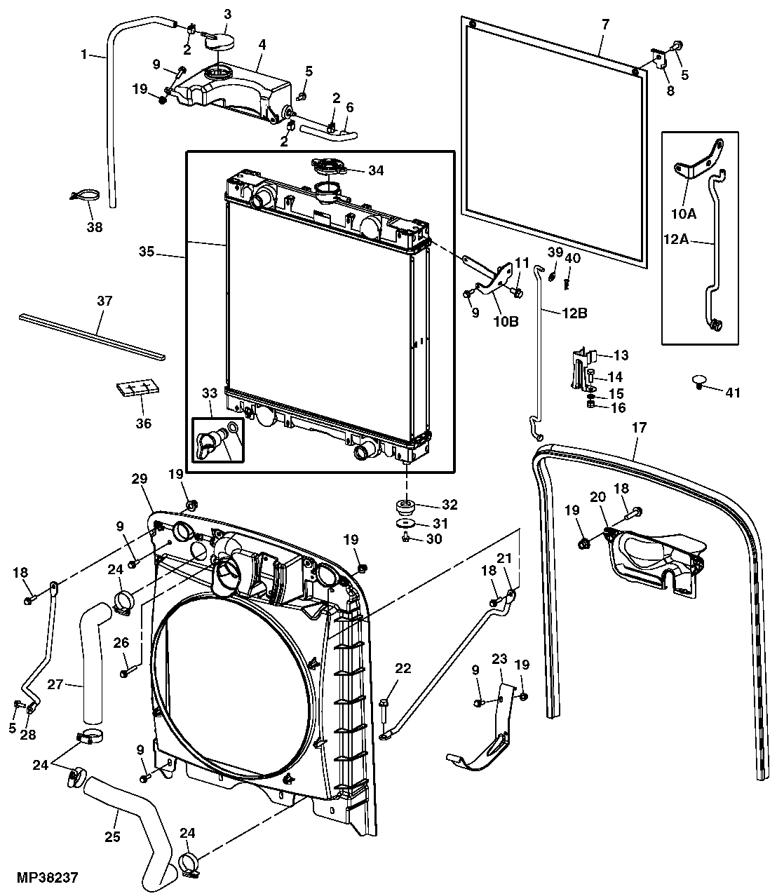

I was looking under my 3520 today to check tire pressures. On the front under the radiator there are 2 bolts coming up from the bottom of the tractor, both of them were loose. After tightening them I looked on the sides of the radiator at the bottom. There were holes for 2 bolts on either side of the radiator. No bolts in either hole. I don't know if I lost them or if they were not installed in the first place. Seems odd that all of them would fall out. The tractor only has 600hrs on it. I haven't tried John Deere .com because it is always a hassle for me to use.

I went out to check. The only thing that I could see that could be potentially what your talking about is the 2 bolts that attach the radiator shroud to the radiator. There is one bolt each side at the very bottom facing toward the operator station.

The bolts I am talking about are on the bottom of the radiator. One on each side facing out and one facing forward. I can't tell if they ever had bolts in them. They are visible with the hood up and looking at the bottom of the radiator. The bolts that I tightened come up from under the radiator only accessible from under the tractor. I don't see any movement of the radiator or the shroud. I guess I will try JDparts .com and see what I can come up with. Oh it is an Open Station Tractor. Serial#ch3015t206042
/ 3520 radiator #5
I think this is the correct diagram:
RADIATOR, HOSES AND FAN SHROUD (SN -H450000,-E470000,-P460000,-F475000)

The bolts that I tightened were #30 in the diagram coming up from under the tractor holding the radiator in place. The bolts that were missing were #9 in the diagram going thru the shroud. But the diagram only shows 2 bolts at the bottom of the shroud, whereas my tractor has six threaded holes in the radiator for bolts. I think I will stop by my dealers and see it they have a 3520 on the lot or in the service department that I can look at. Thanks for the diagram. At least I know my radiator will not fall out or move into the fan.
