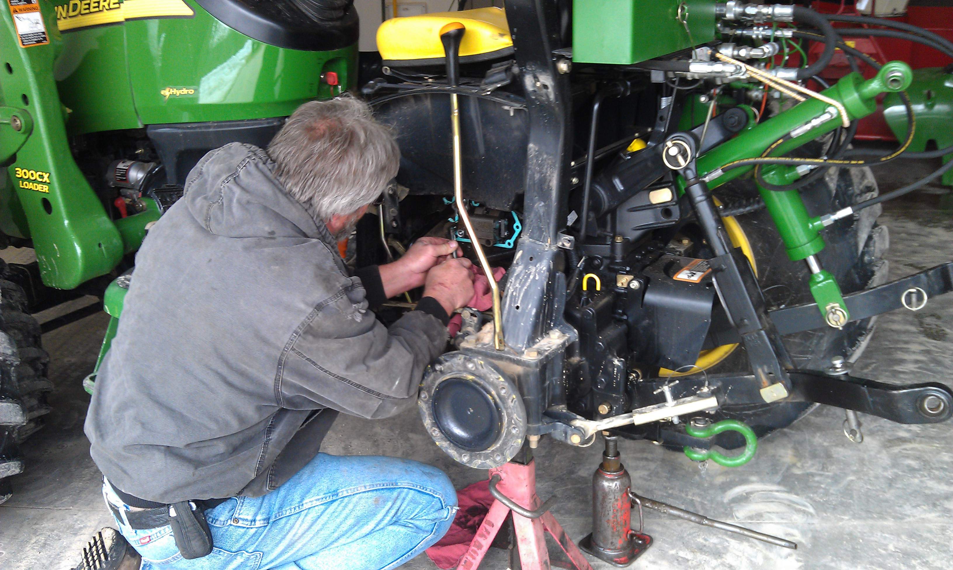

Got my 2010 3520 done the first week of December. I was going to take it to them since I was going to get it serviced but decided to service it myself since it went out of warranty in October.
I took them up on their offer to come out and do it as long as I had a hard surface (concrete, etc.) to perform the work. I have a concrete floor in my shed so they came on out.
They pulled the left wheel off and replaced the gasket in about an hour. I was pleased with them coming on time and calling me before they arrived and after they left so I could open and close up my shed.
No cost to me because it was a recall. The dealer that did the service told me I had until June 2013 to get the recall done but I was't going to wait that long.

That PIP is only to replace the RCV gasket due to the part not meeting JD specs. Should take an hour or less and the dealers prefer to bring it into the shop unless you have a nice spot for them to preform the PIP.

Here it is. They insisted that they trailer it to the shop but when I said that I would have to wait because I didn't want to be without my tractor they said, why don't we have the service guy do it at your house. I said swell. The service guy did mention that in all of the gaskets he has replace, he has never seen one that has been leaking.
