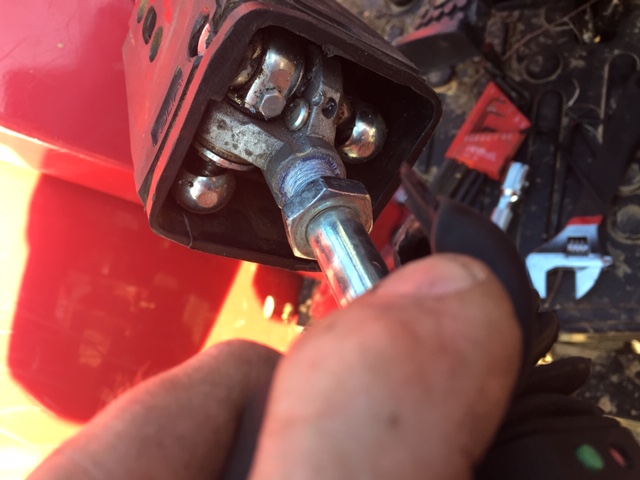

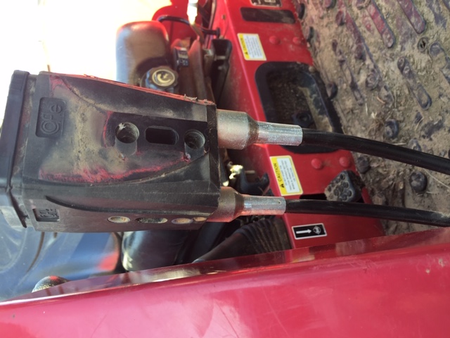

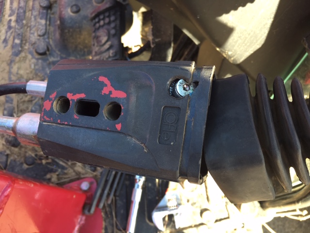

Thanks everyone for the help. I still would like to find a different brand of joystick although I was able to fix this one. I was able to back the screw out of the knuckle where it attached to the plastic housing and add a larger washer where it had pulled thru the housing. So far everything is working great. I did discover what caused the mishap. There is a round ring on the grip that has a rod that goes thru the center of the joystick. That can lower enough to pass thru a hole in the center of the housing and locks the joystick. Not sure of the purpose of this unless it is a lock for the joystick. Thanks again.
   / 3550 FEL Joystick replacement Options #18
Mine has a lock also, the ring is at the top of the boot and when I center the joystick I push down on ring and it locks. I think its a safety thing and if you didn’t have front end loader on it might keep you from putting pressure on the lines forcing it in bypass. I read something about it in the book but like most things I can’t remember. Glad you got it fixed and hope you have no more trouble with it. Good luck
   / 3550 FEL Joystick replacement Options #19
what you have there is a Cofle brand joystick they are found on several tractors. i am working on one right now where the cables are dragging real hard internally. which is a big problem with these joysticks. we have 3 tractors with it on there and have had to replace all of them some two times, they are not very reliable. i havent found anywhere where you can just buy parts for it, and its dealer only in most cases.
