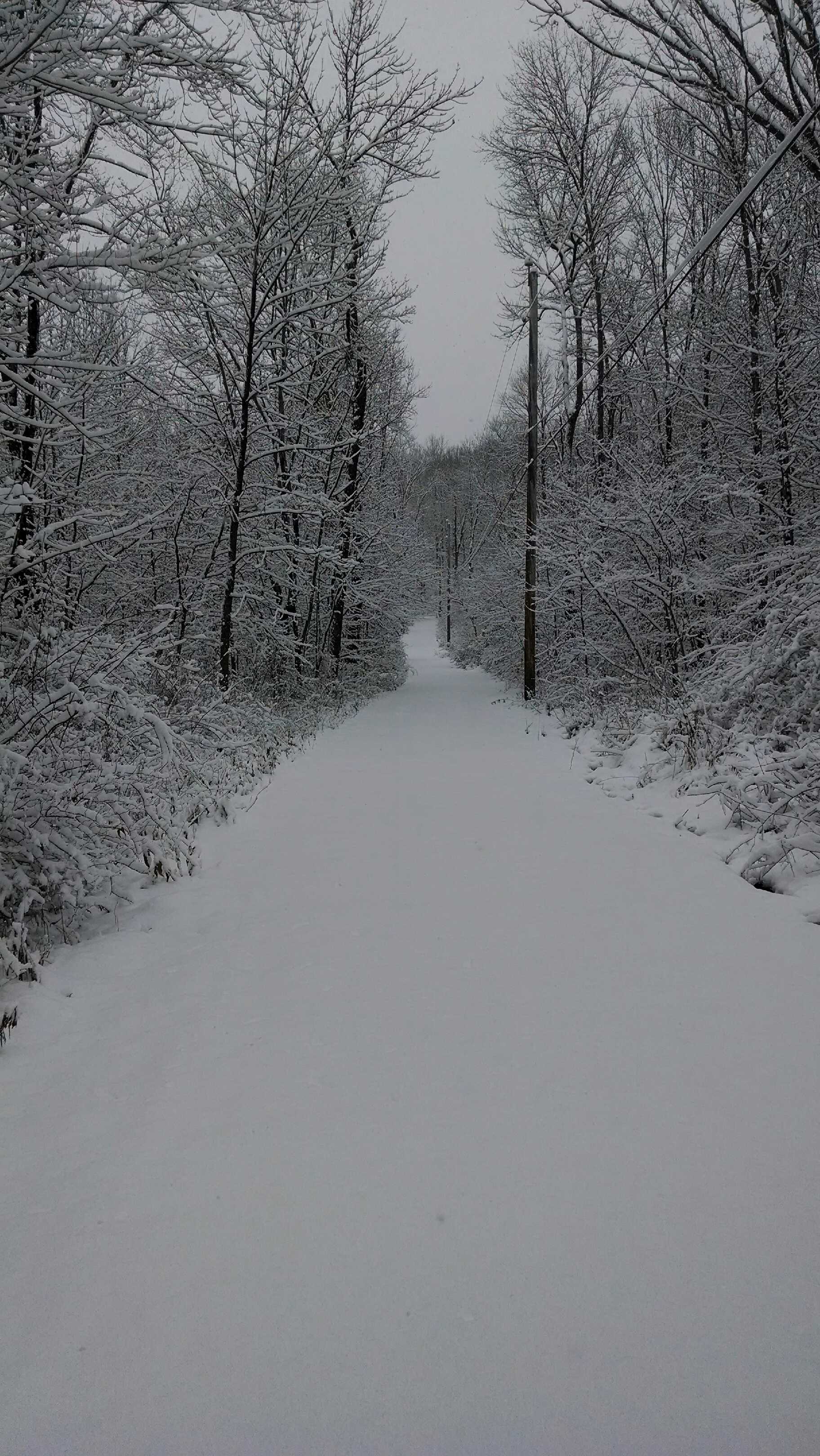

Very nice. Is there anything to dampen the shock if you hit something hard?

My drive is a 1/4 mile long, The picture is about the half way point. snow drive.jpg It took forever to do it like that(3 hours). It does pull to the non angle side if the blade fills and I'm going too fast. If that happens I pull the FEL off float and manually plow for a bit until it bites again. If I lean on the discharge side a bit she will hold straight. The first time I tried it I was looking for some spilt brakes. I thought about relaxing the angle a bit but I'm not sure if that would help any.
Yes, Me:thumbsup: I am working on a spring loaded cup holder for the beer though.
