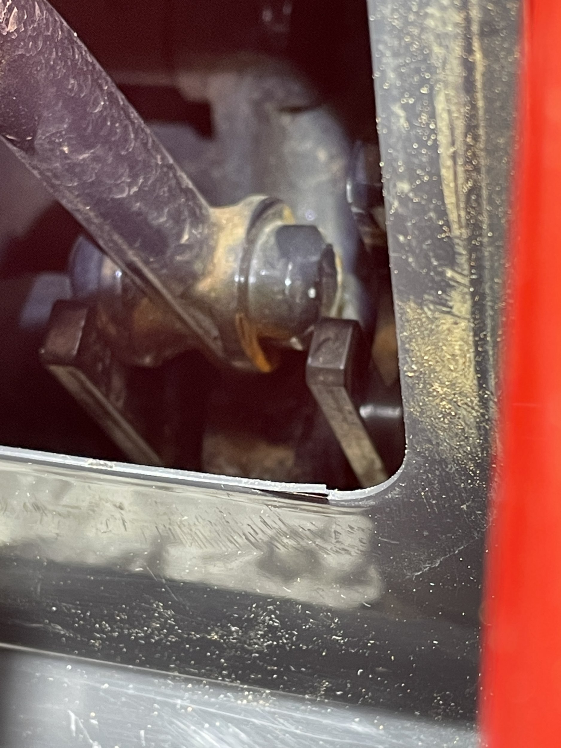

My 2021 3620H with 125 hours is stuck in A range. Everything was working great and during a routine range change it locked up. Shift lever does not look like it’s in the right position for range A. It looks to be in position C.
Any ideas?

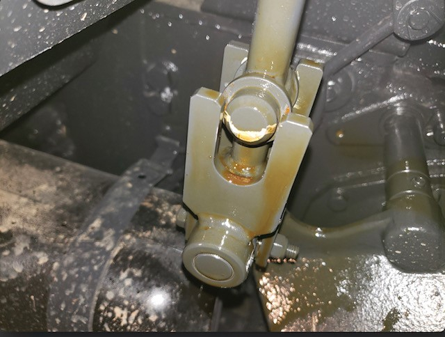

I didn't find much when I searched here about problems with the newer 4 range linkage. I traded a few messages with the dealer and he said that its possible the linkage had popped out of position and needed to be "pryed" back into position but from what I could see, it was located correctly between the the forks.
In this photo from a different thread, there is a bolt holding the forks to the transmission shaft.
Is it possible that has slipped out of position?
My linkage appears to be fully engaging both forks so I don't think anything has popped out of position but I'll look close tonight.

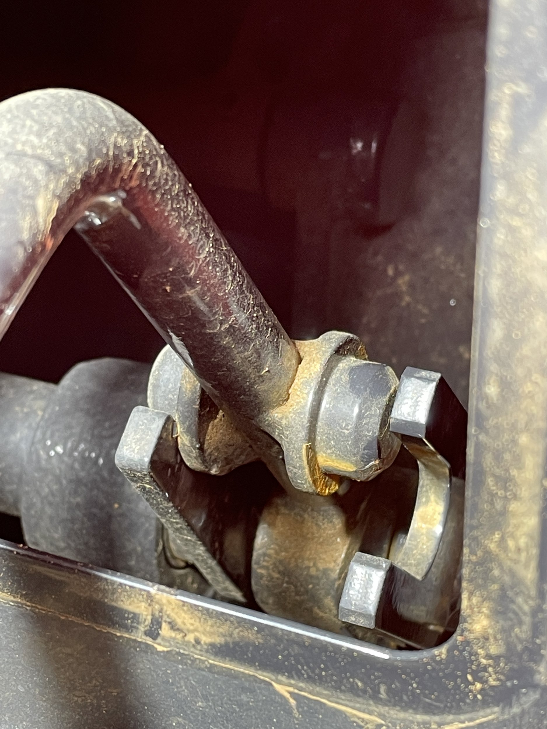

Problem resolved. The dealer gave me enough info to figure out that the linkage did indeed get out of alignment. The simple fix was to remove the rubber boot around the shifter and push the outer fork back into alignment with the boss on the shifter. First photo shows the misalignment. The outer fork (right) should have been engaged to the round boss of the shift lever. Somehow it did pop out of position and leave the transmission in range A (outer fork in forward position).
All I did was push that right fork back to be inline with the round boss (neutral) and problem solved.
The shifter was locked up because right fork was forward in range A and with it engaged, the left fork could not move out of neutral.
Hope this helps when someone else finds themselves stuck in one of the 4 ranges.

   / 3620H Stuck in Range A - Eazy Fix
After talking about this with the dealer, he told me this can happen in any range and is a result of applying either inward pressure (to ranges C/D) or outward pressure (to ranges A/B) before first fully shifting forward or backward to neutral. The fix is the same, just bring the disengaged fork back to neutral.
