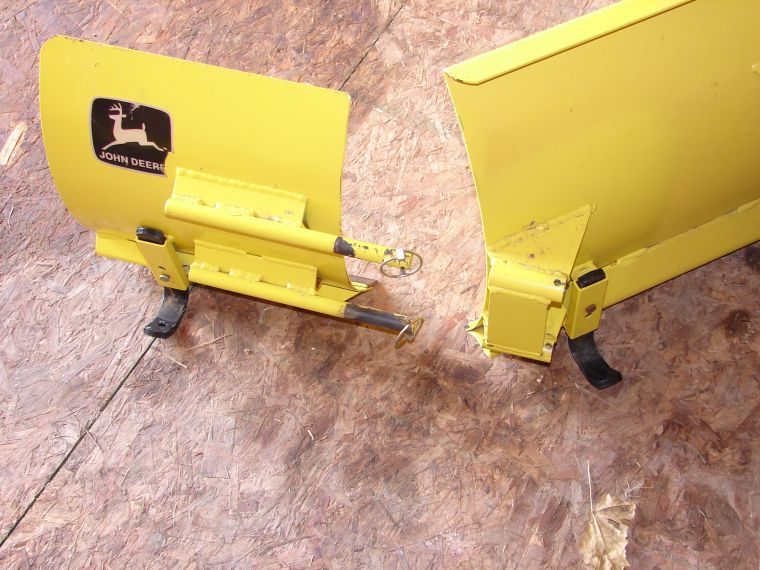

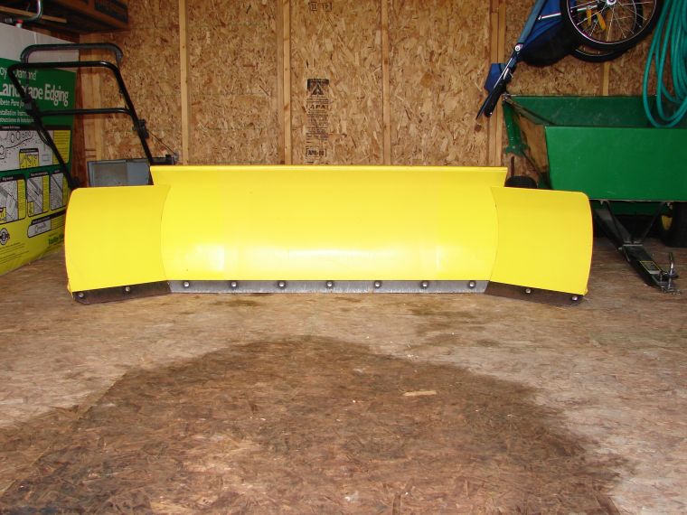

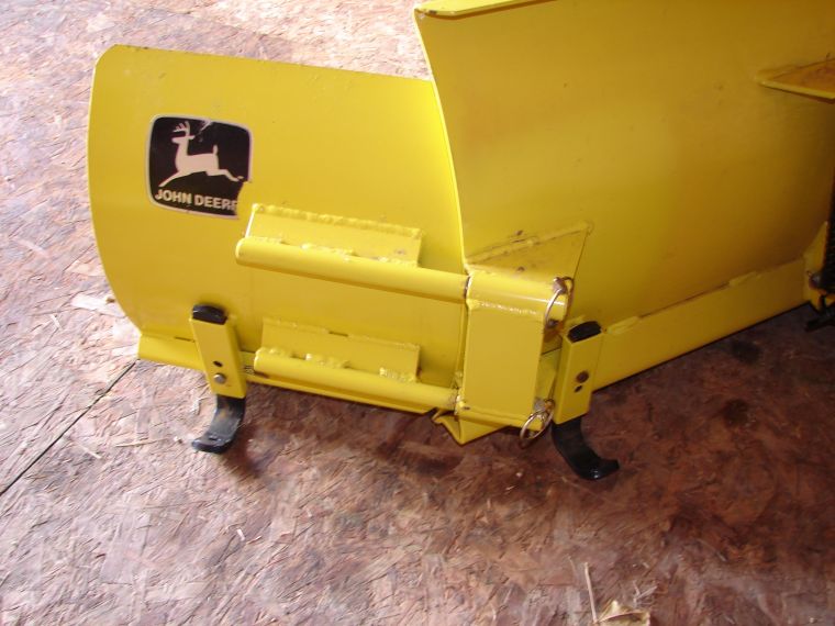

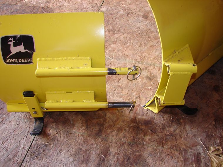

I do not know if this is an option for you... but... We biult a set of wings for a smaller blade on a friends gt235. We found an old plow and cut it in half then added mounting brackets. We added some support to his current blade. I will try and grab a picture, but he has less than 50 dollars into the deal. He uses it hard, clearing a driveway over 300 feet long. Way more than the tractor and blade should be, and its fine... Might you be able to build one?

I am going to try to get some pics of what we did. I found a back blade in the old farm barn that I would be willing to donate if you want to go this way. It measuered 17 inches tall.
I could cut it and package it up easy.

I will try to get over there this weekend. We used a shorter blade on his sides to eliminate the stress that could be cause by pushing a huge pile. His machine is only a GT235, so there is not the force there to push a big pile also.

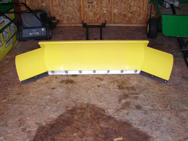

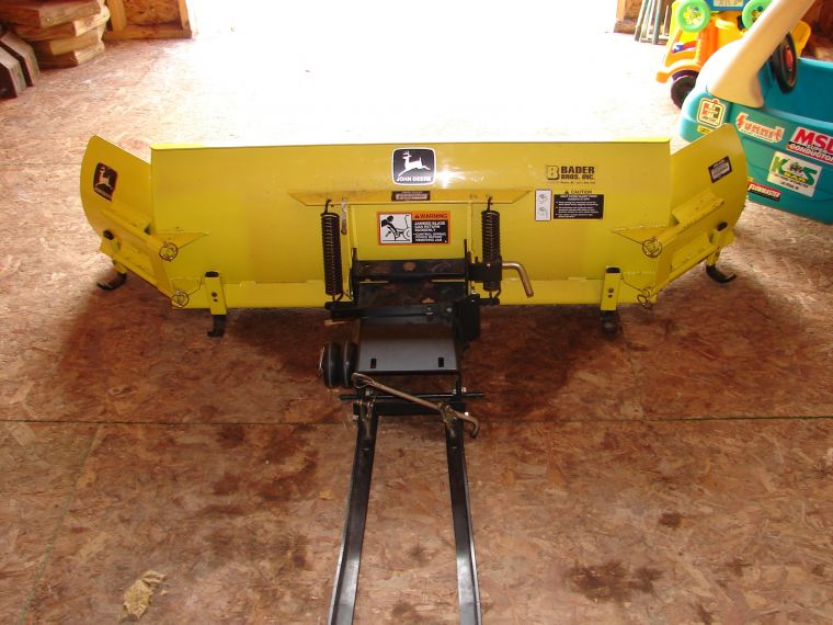

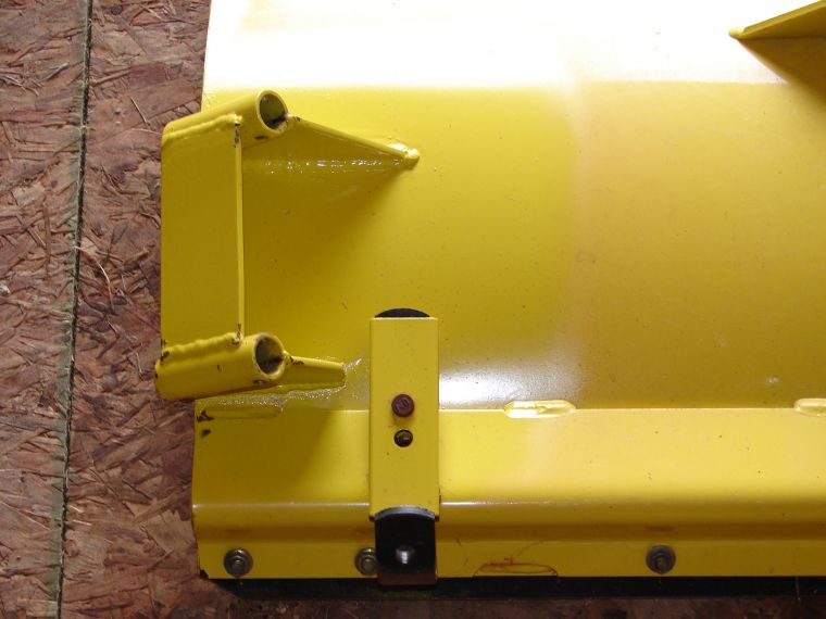

Here are the pictures of what we did for his smaller plow. I think you could do the same very easily!:D

Thanks a bunch, kinda interesting and it does promote some additional thought.
/ 366 Frame Mounted blade #31
Good job on that blade, nmu98! Easy to adjust; on or off and looks like it would make the blade alot more efficient for holding and piling snow.
Need something like that for my 110 (with skid steer attachment..).

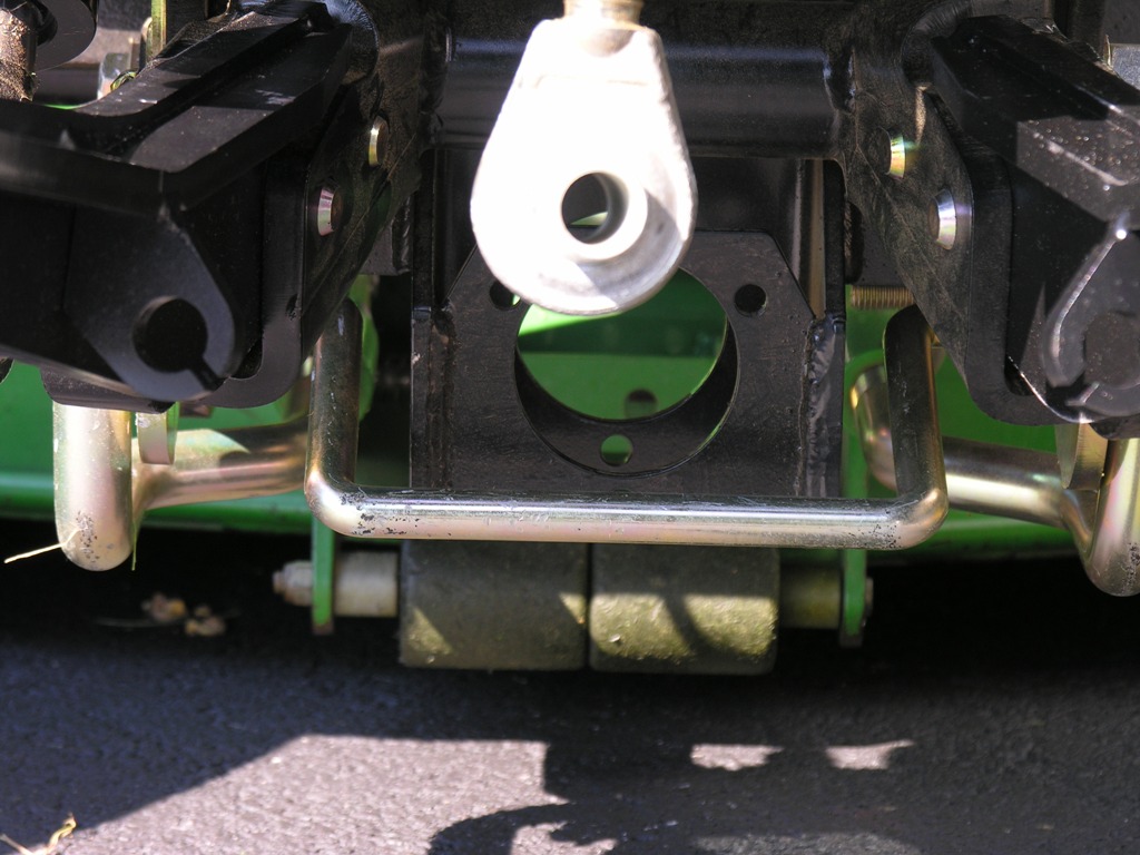

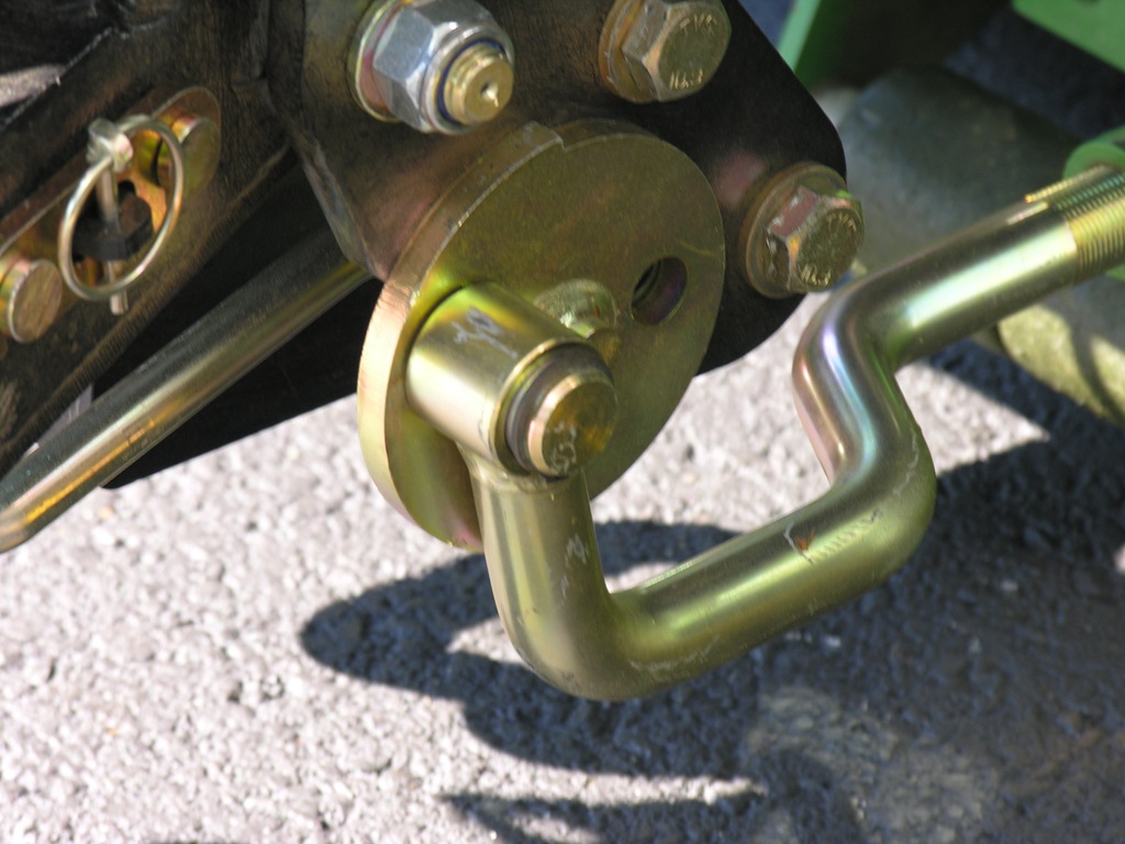

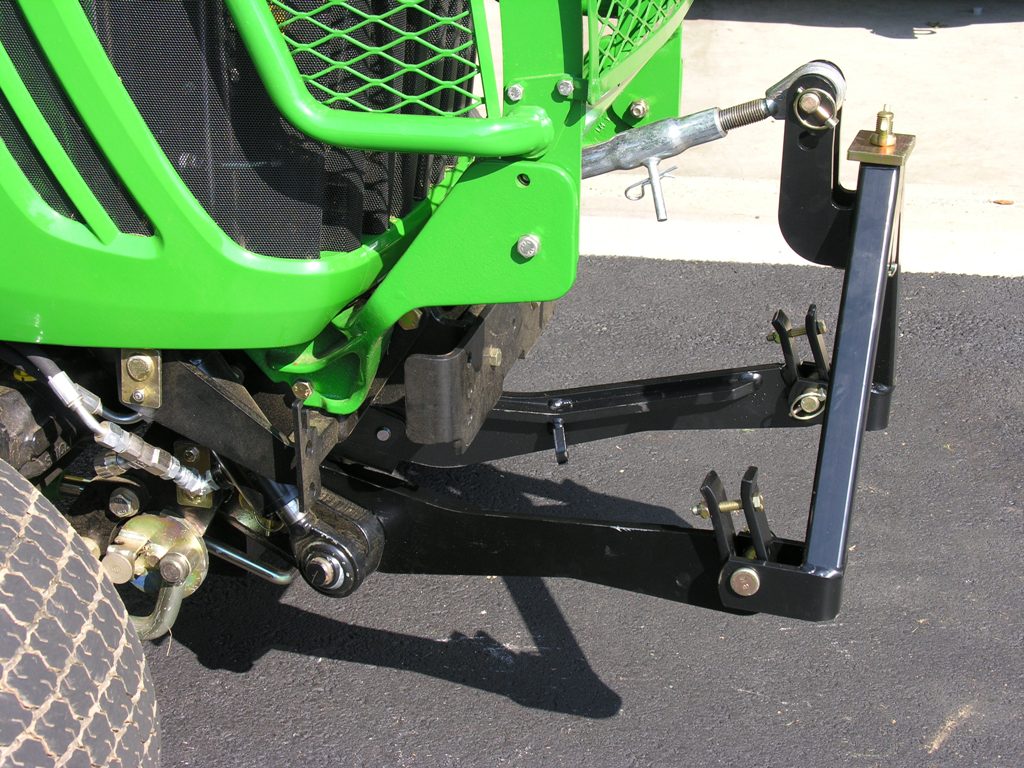

Well here is the Front 3PT Hitch installed
/ 366 Frame Mounted blade #33
How bad was it nuru... Looks like a PITA:eek:
#34
nmu98, Actually, it really was not bad at all. I am leaving this on until I need to use the loader, then it is just a few pins and it is off the tractor, takes a couple of minutes to get it off and back on.

It's hard to see where/how the arms disconnect. And the shiny brass-like linkage stays on all the time, yes?
You'd not want to be dragging thru the woods or in rough territory with that hardware either - I'm guessing...
That said; I'm wondering about the advantages of this front blade configuration vs the older, drive-over design? The 380-390 front mounted blades.

AKfish, I think the reason Deere went with the front 3pt for the frotn blade mount was to make an easily compatible front blade with loader and MMM's. The 3pt removes easily and then you can change into the loader. With the old style 380-390 blades the brackets were not compatible with the loader mounts or the MMM. When I bought the 3520 I have I had a choice of going with the front 3pt hitch if I wanted a front blade. I myself liked the old style blades so I modified my loader mount to be compatible with the blade mounts. Now I can change between loader and blade in a few minutes without removing any brackets. The only drawback is now I can't use a MMM, which did not matter to me. I think the old style mounting system is stronger than the new style 3pt and that is the main reason I didn't go with the new front 3pt hitch. It looks as though the new style has the advantage of more ground clearance, although I never found that to be a problem with the old style..I always wondered why Deere never offered a loader mount that would also be compatible with the blade mounts?
Nuru, do you have any pics of the blade not connected to the 3pt. I'm curious as to how the lift cylinder comes into play?

AKfish;The linkage can come off with the MMM if one desires. The front 3PT comes off in seconds and just leaves the brackets and the MMM hooked up.

" Nuru, do you have any pics of the blade not connected to the 3pt. I'm curious as to how the lift cylinder comes into play?"
DirtW; Here you go. This is pic of it on the floor of my shed.

On mine the A Frame and the arms come off and then you can go to the loader and if you want to go to the blade then you put the A-Frame and arms back on (a couple of minutes), then you can use the blade. The MM can stay on the tractor regardless.
