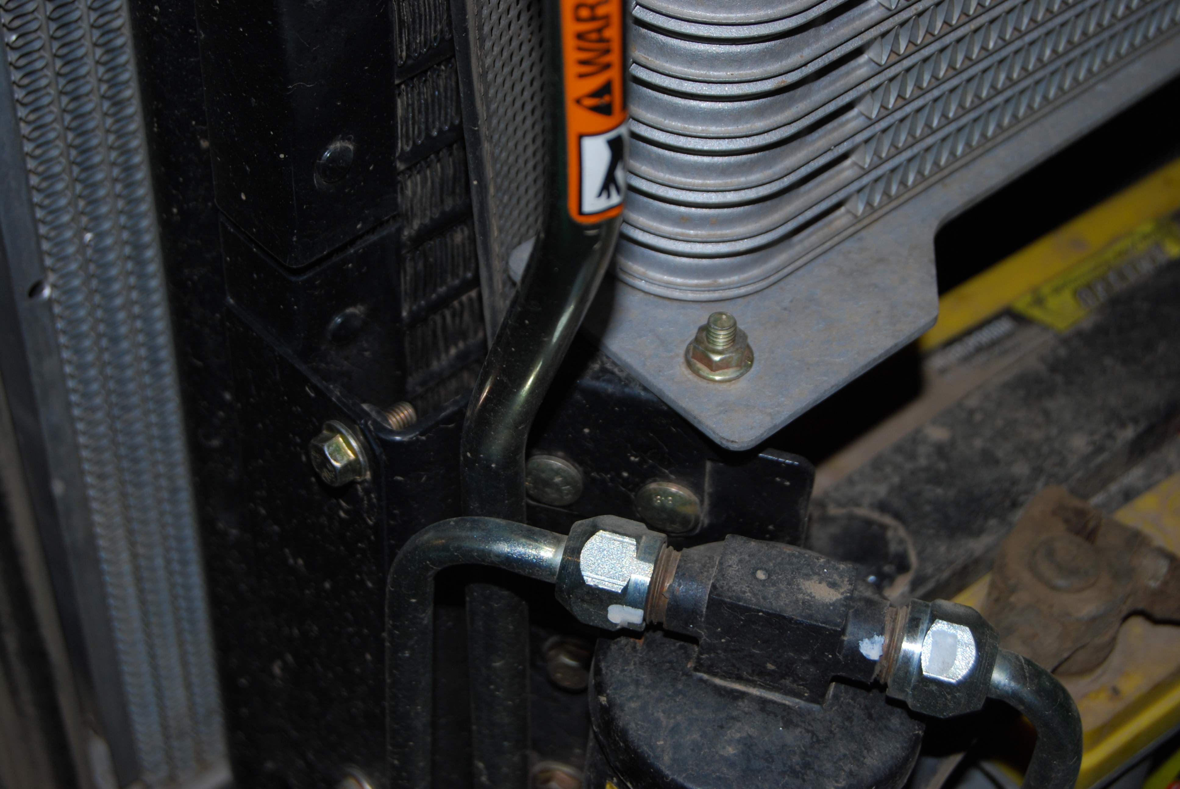

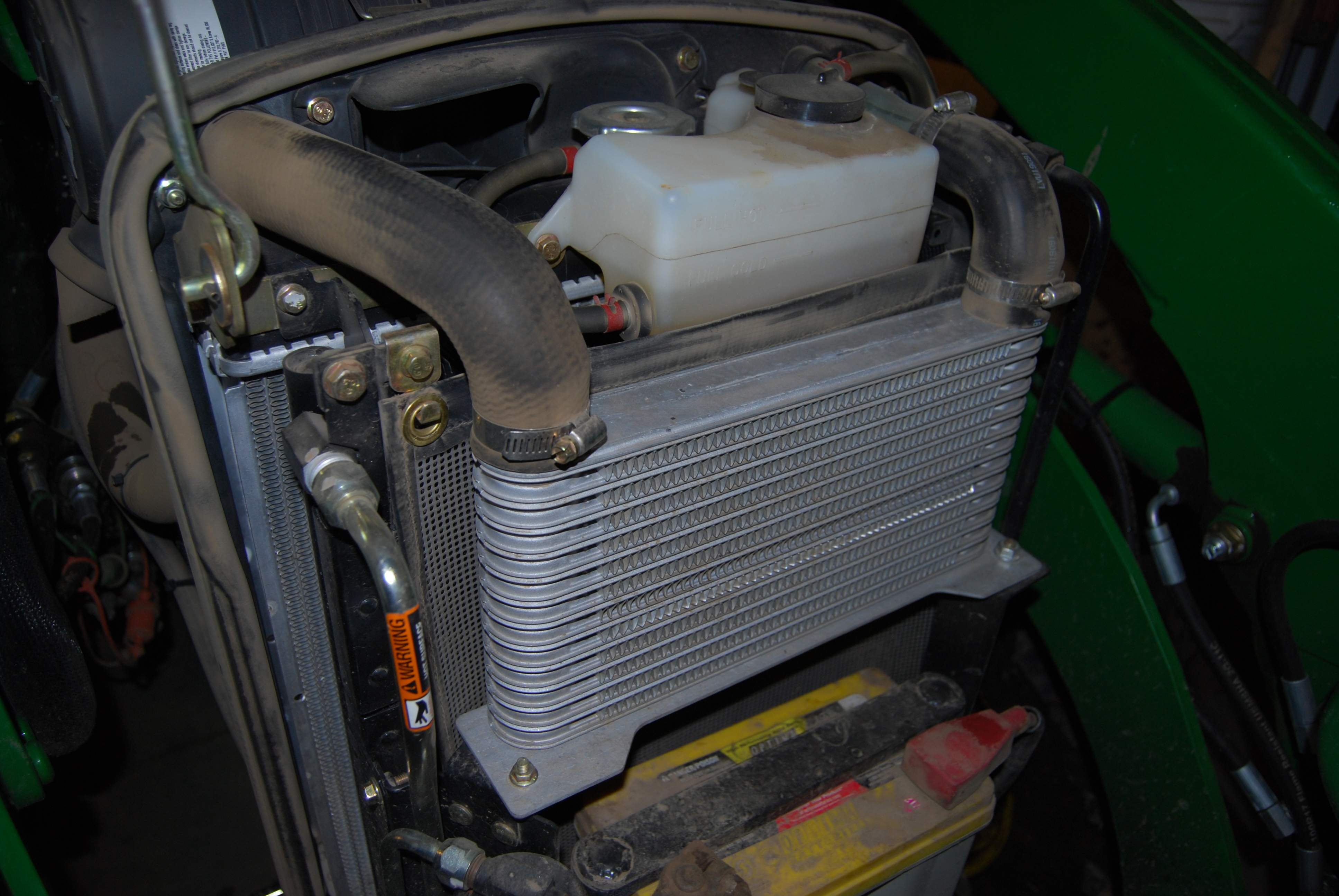

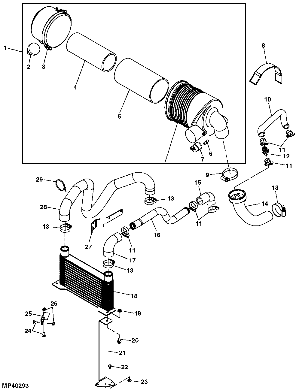

Can someone post a picture of the intercooler on 3720 with a cab? I am thinking of putting one on my 3520 cab tractor and was wondering if the cooler was located in front of the ac condenser. I have looked at an open station 3720 and the intercooler is mounted right in front of the radiator and on my tractor the condenser is in front of the radiator. Is it mounted in front of the condenser on the cab model?

Do you still need the pic of the intercooler, I have a 3720 with cab and can take a pic tomorrow if you need it.
/ 3720 intercooler
Sure, if you could I would appreciate it.
/ 3720 intercooler #4
Here's a parts photo from JDparts.com

Here are some pics of mine, hopefully they uploaded correctly.
/ 3720 intercooler
Thanks for the pics. Compared to a non cab model, it looks like they used different mounting brackets and longer intake hoses to move the cooler further ahead.
