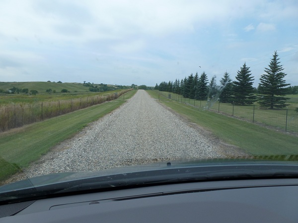

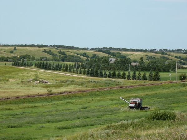

Adding on to AKFish's questions...will you have to mow along that drive? I'm wondering if your drive way right-of-way extends to the fences shown in your third picture.
I'd also consider a rear blade (7' or 8') for the lighter snows. With that gravel drive, you'll definitely want skid shoes.
BTW, you might want to consider snow fencing too. That's flat land with no windbreaks...drifting snow might well be a problem.

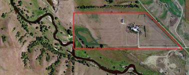

We'll have 40 total acres of which most is pasture/hayland. The original owner had it set up for horses but we don't have any interest in that. A neighbor currently hays it for his horses. I may be interested in buying a mower in the future.

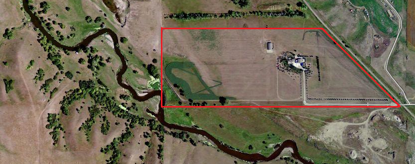

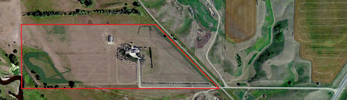

Yes. I've attached two more pics of the property that give an aerial view and show the layout better. Our driveway is at the end of a 1/4 mile gravel township road.

Is that 1/4 mile twp road run east/west? And your drive runs due north from the end of that 1/4 mile twp road?
Will the twp plow that road or will you have to keep it open (or sit tight until they do it)?
   / 3720 with snow blower for 1500' gravel driveway?
#18
The 1/4 mile township road runs east/west (from the highway to the railroad tracks in the pic). Our drive then extends 1000' feet east/west from the end of the township road until turning north for 400'. The township will plow their road but there might be times when I need to clear it before they do so my wife can get to work.
