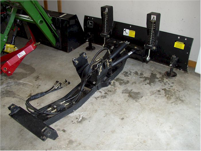

The 380 and 390 are very heavy duty. But I never use mine anymore because to install it on the 55 series requires removing every bracket from the tractor that is used for the 70 loader. Even the long loader bar through the frame. You then install a different set of brackets for the 380 blade. After doing that back and forth a few times I decided it was not worth it. I now just use the loader and box blade for dirt work and a rear three point blade for snow.
Having said that, the 390 has the big advantage of using a quick attach set up instead of what the 380 requires. So I say if the price is right then go for it. I always enjoyed using mine when it was installed and is a lot easier than watching a fixed blade over your shoulder. I did a lot of dirt work with it and it was always up to the job.

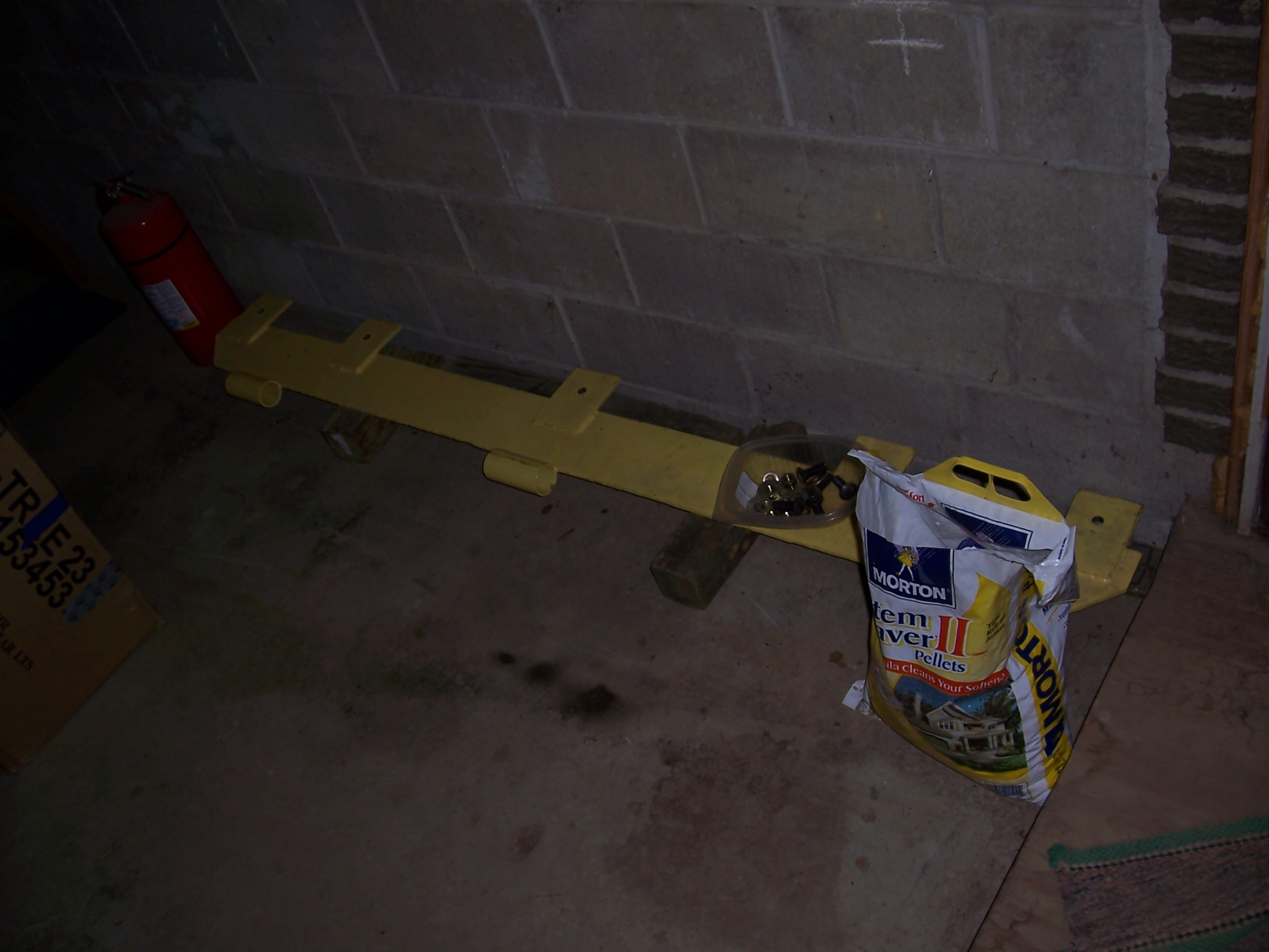

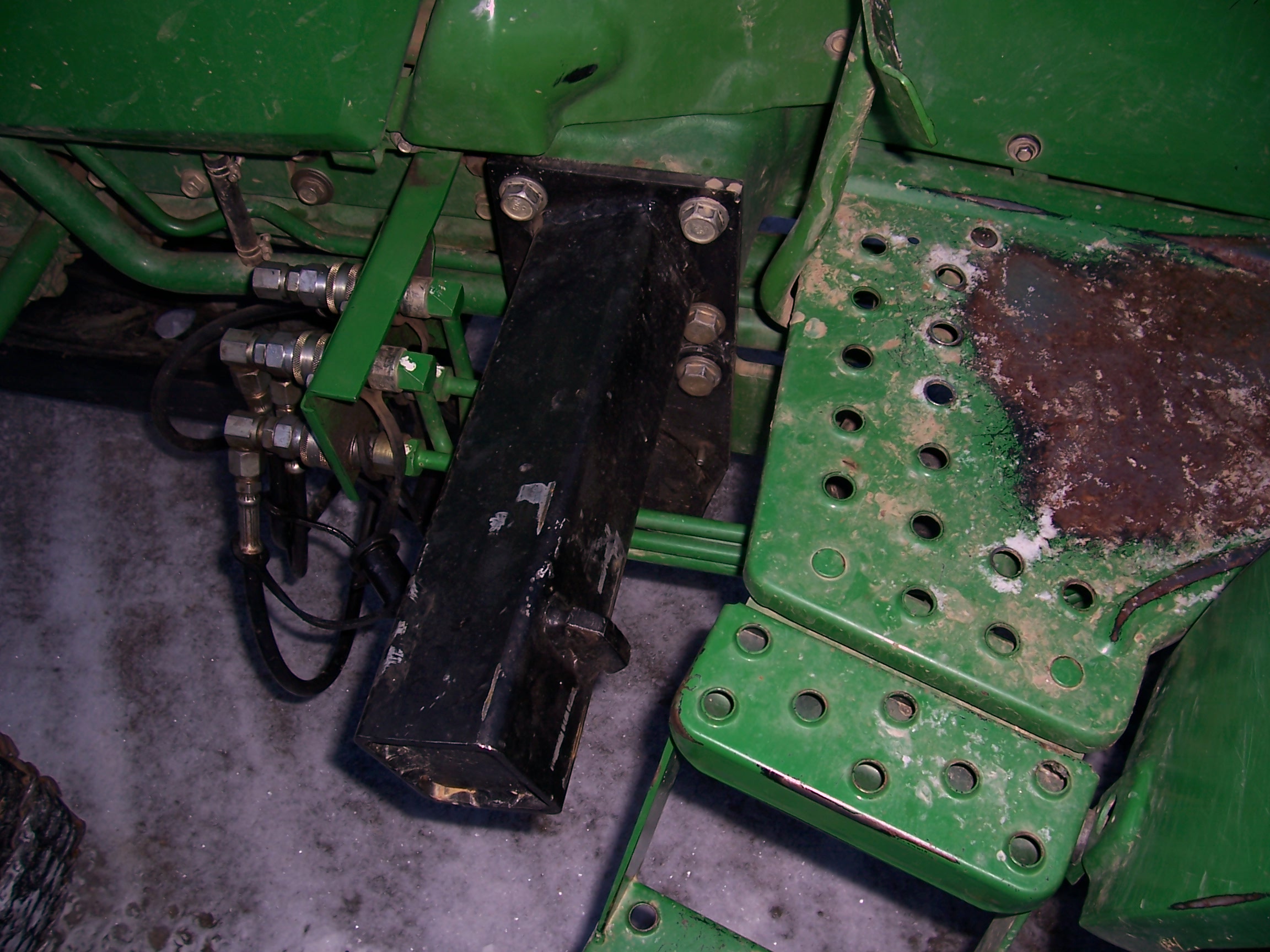

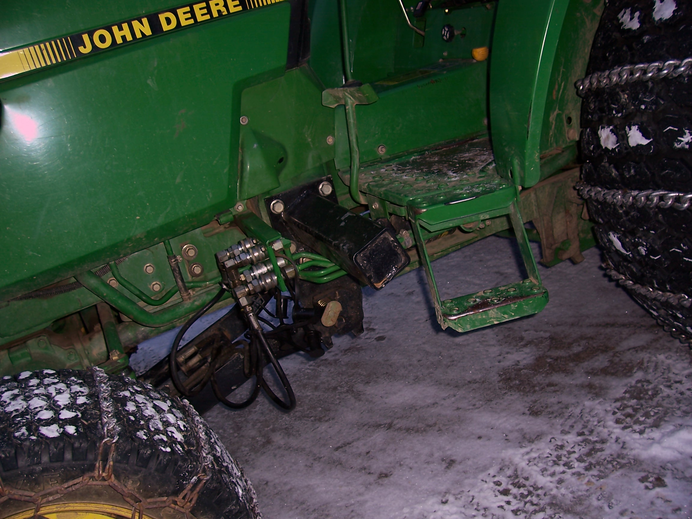

I see this is an old thread, but maybe you bought it and have the hassle of bracketry changes between FEL and 390 blade. I had the same hassle with my 1070, 440 FEL, and 390 blade. I then modified the rear 390 brackets so that they mimicked the FEL brackets by welding on square tubing and little ears to locate the FEL. Now I can switch back and forth between the FEL and 390 blade in a few minutes in winter. It isn't that much work or welding to fabricate - the hardest thing was making a pattern to get the square steel tubing in the right place on the bracket at the right angle - I made a heavy paper pattern for that and it worked fine. In summer I use it for mowing so I remove the modified 390 brackets and go back to the originals that can be used to install the mower hangar stuff. Once a season is not too much a hassle.

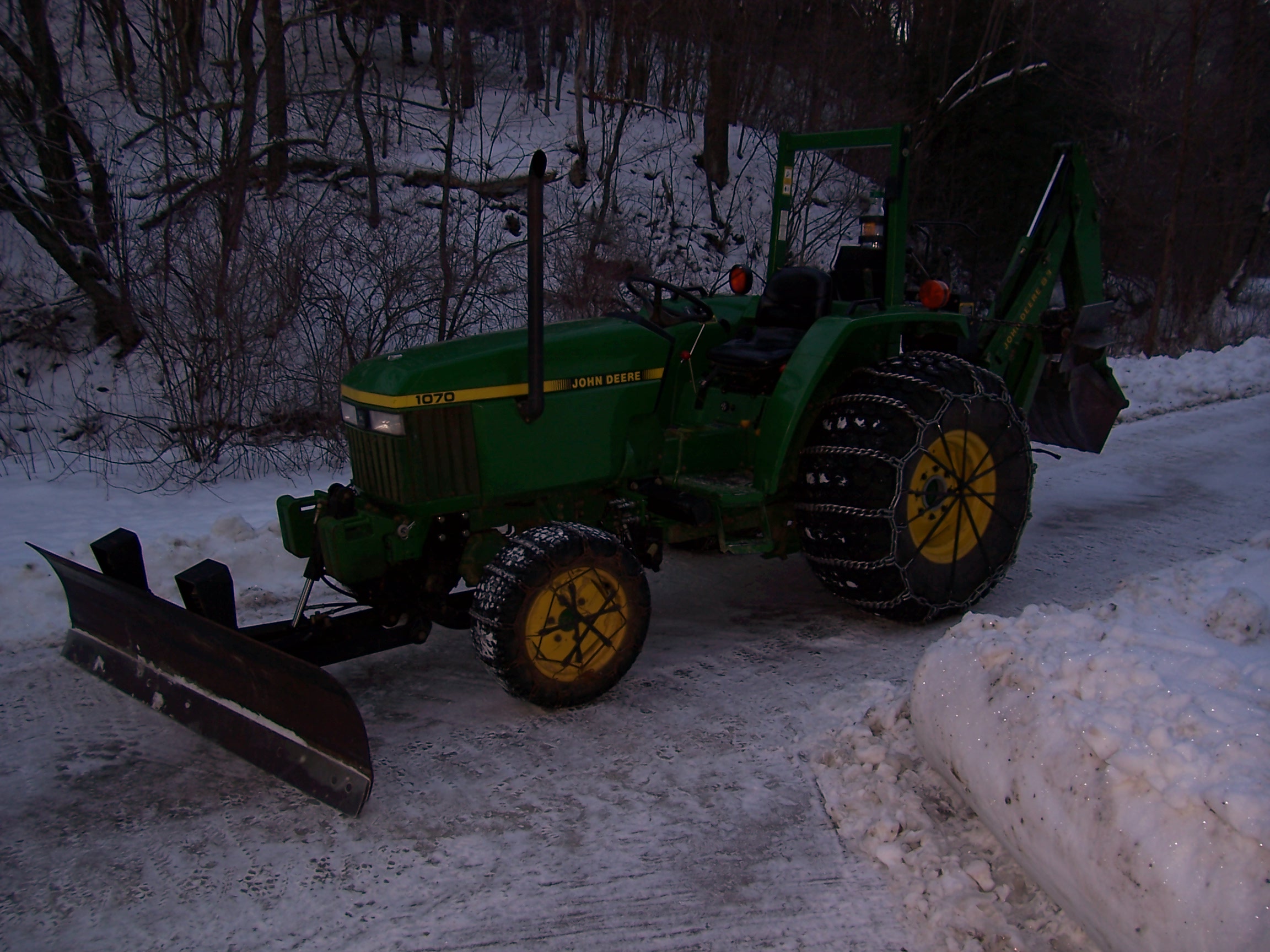

Here are some pictures of my 1070 with 390 blade sporting the modified rear brackets that I made so I can switch to the 440 loader quickly. I added the square tubes to the rear brackets. Also shown is my blade height extension which prevents me from squeezing the unit in the garage so it stays off till I need it.Snowplow brackets and extension 009.JPGSnowplow brackets and extension 001.JPGSnowplow brackets and extension 002.JPGSnowplow brackets and extension 003.JPG
