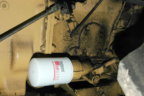

As I previously posted, I believe your 3910 to have independent PTO. There is however a listing for a double clutch and live PTO in the parts catalog. There is no single clutch transmission PTO referenced. We can solve the mystery easily. Every three cylinder Ford with either live (two stage clutch) or transmission driven PTO has the PTO shifter shaft supported by and run through an inspection cover on the left hand side of the rear axle center section. Every three cylinder Ford tractor with independent PTO (except those with Selecto-Speed transmission) has the PTO shifter shaft supported by a machined bore directly through the rear axle center section housing itself, well above the left hand inspection cover. A casual look will tell the tale.

Independent pto:

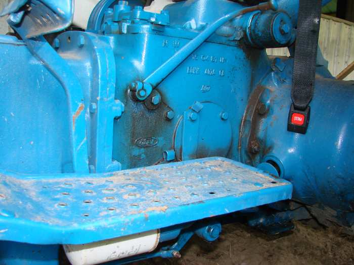

Here's my selector, does that mean it's independent?...If so is there a clutch in there that I can inspect?
Not sure what you mean by Selecto-Speed. My transmission is 8-speed synchromesh (operated by steering column levers).

You have independent PTO. There is a hydraulically actuated multiple wet disc clutch in the rear axle center section. You can split the tractor between the rear axle center section and transmission, but it's not likely you will find anything wrong, or be able to do anything to modulate the clutch engagement. Lubricating the external linkage pivots so the control operates smoothly and easily, and learning to feather the engagement as I suggested in my first post will do just about all the good that can be done.
A Selecto-Speed transmission was an option available prior to 1975. I included the reference in my post because the PTO shifter location is relevant to all 3 cylinder Ford tractors, and also to prevent the need of another poster from correcting my error of omission. 3 cylinder Selecto-Speed tractors had a cable operated PTO.
