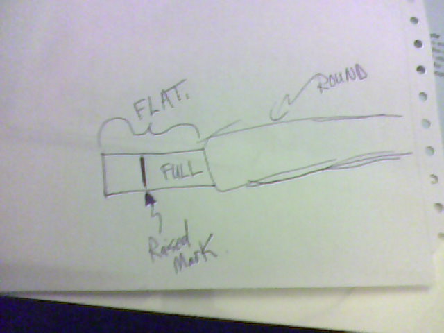

Apologies... I only have my webcam, so had to take a picture of a crude
sketch, the dipstick itself wouldn't look like much on this 'cam....
(The dipstick is straight.... I just can't sketch today....)
I do have the factory operators manual, it says "....check that the oil
reaches the upper mark on the dipstick..."
What I am trying to get across in the sketch is that I can only see ONE
mark on the dipstick. When I got the tractor, the oil level in the
transmission covered the FULL letters on the stick, coming right up
to where the flat portion of the dipstick ends.
I'd like to think the drivetrain can tolerate some overfilling, but with
what (very) little I know about hydraulics it seems that things can get
weird with too much oil.
So... just wanted to ask the brain-trust here:
1) Do I use the Raised Mark to indicate full, or do it top it up to the
end of the flat portion ?

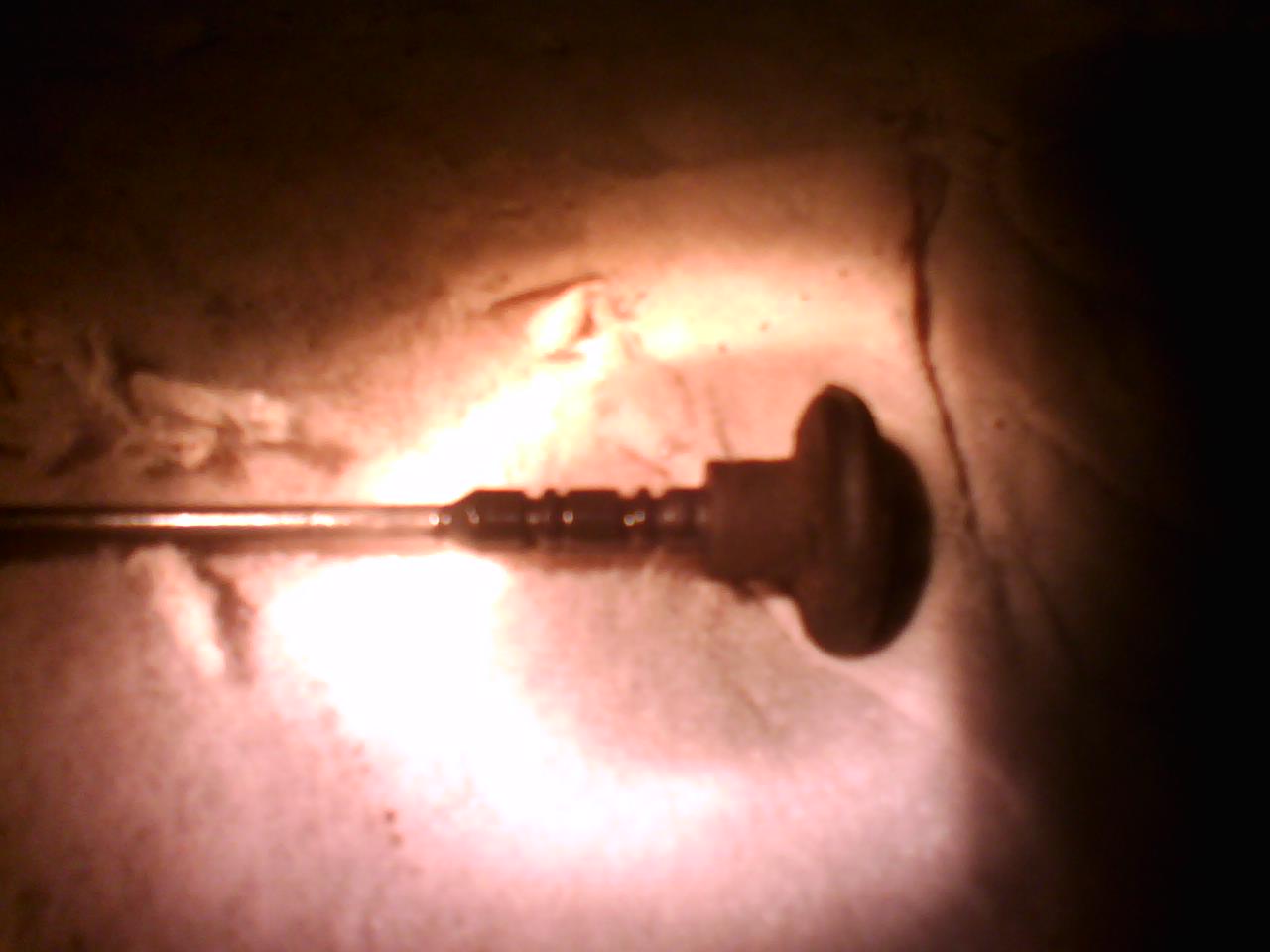

I'm pretty sure my '92 4630 has the same 8x2 tranny. Dipstick is confusing as there is no "upper mark". Mine came from the factory filled to just above the full word where it tapers from flat to round. After changing the oil a couple years ago I found after refilling spec amount it indeed came to that same level. I'd estimate that lower mark to indicate at least 1/2 gallon low. As far as O-rings, mine has the grooves but I'm pretty sure there was never O-rings in those grooves and it does fit kinda loose. Here's some sorry pics to help illustrate.

Does the tractor have remote hydraulics? That oil could have come from an external single-acting cylinder. If the reservoir is filled with the 3PH lifted and/or an external hydraulic cylinder extended, then on lowering the 3PH, the fluid will go over the full mark. You should always check fluid with the 3PH in the lowered position and other attachments like an FEL at the lowered/retracted position.
Another way that reservoirs get overfilled is when someone reads that the reservoir holds a certain amount of fluid, like 10 gallons. They buy 10 gallons and then drain the reservoir. Because oil is trapped, they may only drain 8 gallons, but they worry that the spec said 10 gallons, so they put the whole 10 gallons into the reservoir. The tractor may also not be on a level surface and the dipstick can give a false reading.
At any case, I'd put the tractor on a level surface and fill to the line. After that, you should be good to go.
