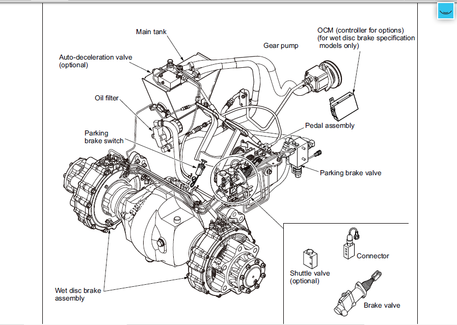

Has anyone tried carbon fiber for wet brake disc printed of a 3D printer? I cannot get brake disc for my Mitsubishi MT14 compact tractor so I am going to try this.

Do you have any Mitsubishi or general Forklift repair shops in your area? If so, take the wet disk brake in and match it up.
Here is the Mitsubishi Forklift setup.
