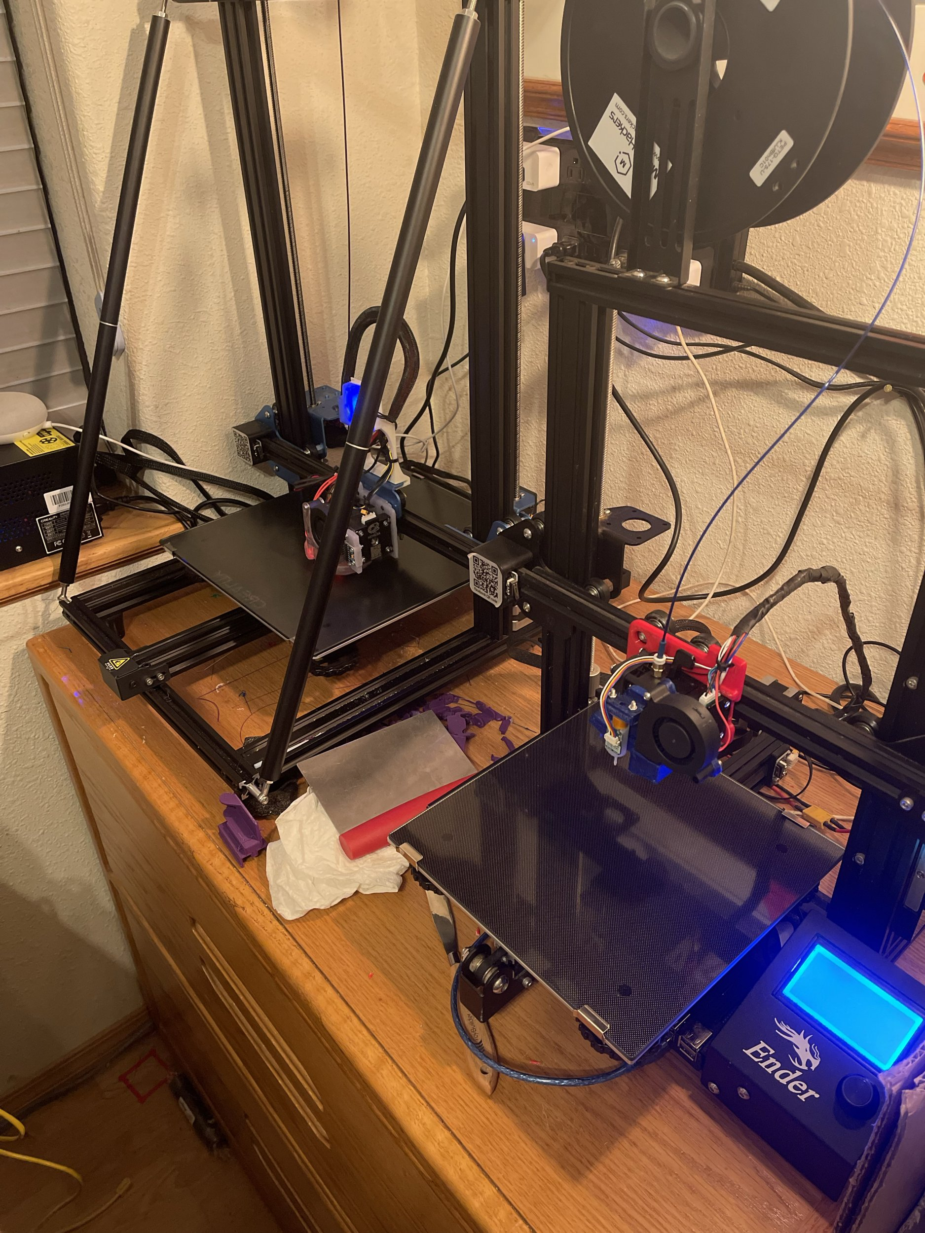

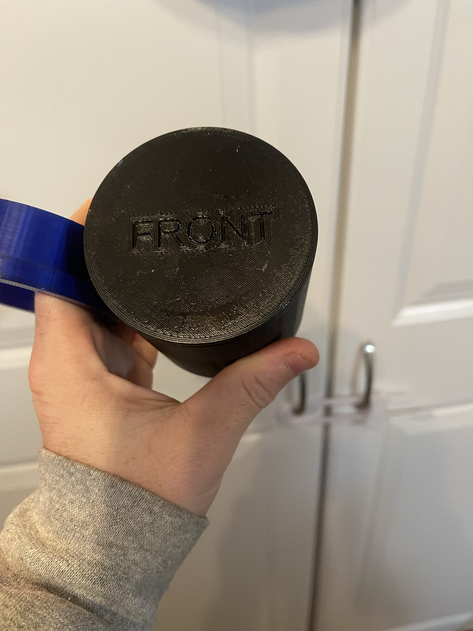

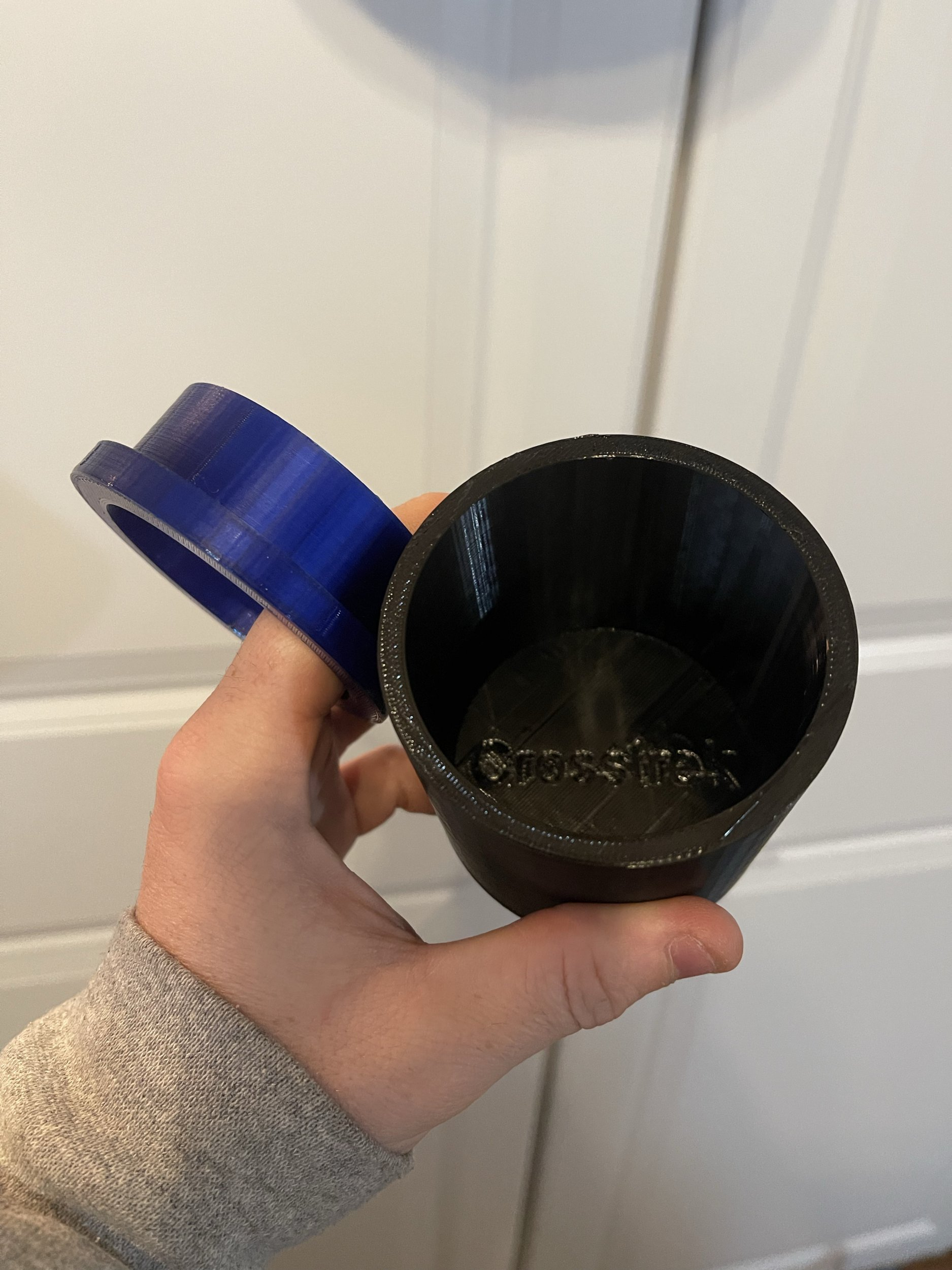

It can also be a trait of a heavy bed style machine, both of my machines run on Klipper with the CR-10 printing up around 100mm or higher with no ringing. Klipper Firmware is replaces Marlin but requires a Raspberry pi computer to run everything it does all the computing well the main board only is there for which direction the stepper motor is going. These main body pieces are PETG came off my CR-10 running at 100mm for most settings at 75mm tall take around 2 hours well the accent adapter came off my Ender 3 with a Biqu H2 direct drive they are around 20mm tall they take around 1.5 hours each at around 50mm a second. If you’ve been thinking about doing Octoprint or are running Octoprint I’d look into Klipper with one of its light weight interfaces such as Fluidd or Mainsail they’re easier to use as well as cleaner.

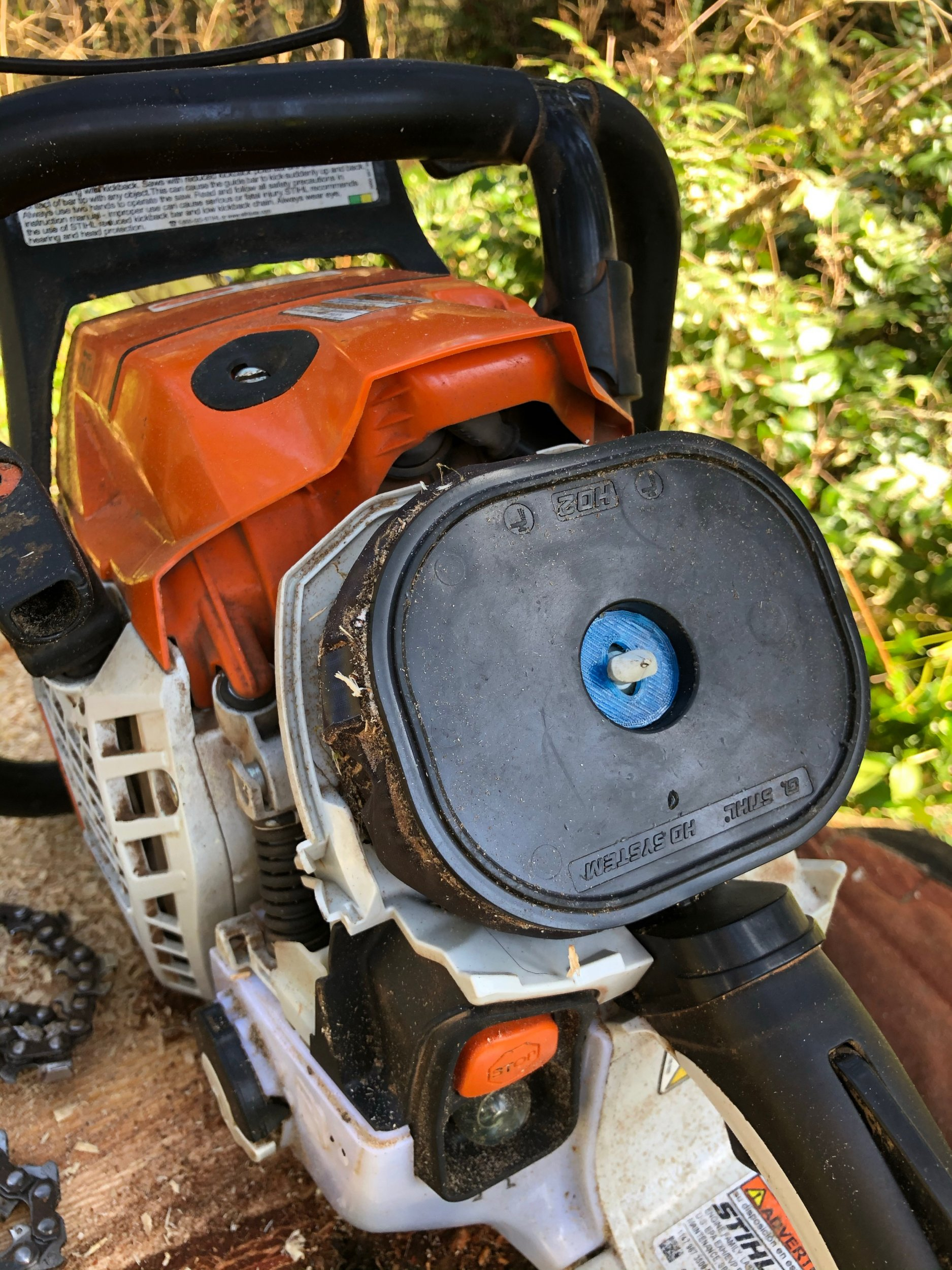

That would depend on the stepper motors that are on the board, my Ender with the stock board was terrible for noise but with a BTT SKR Mini E3 board it’s pretty well silent now. My stuff is a hobby with the ability to prototype something or make stuff for our equipment that’s not available. Something like this little flexible filter lock is something that’s nice to have the speed when doing prototypes in the evening to try out during the day.

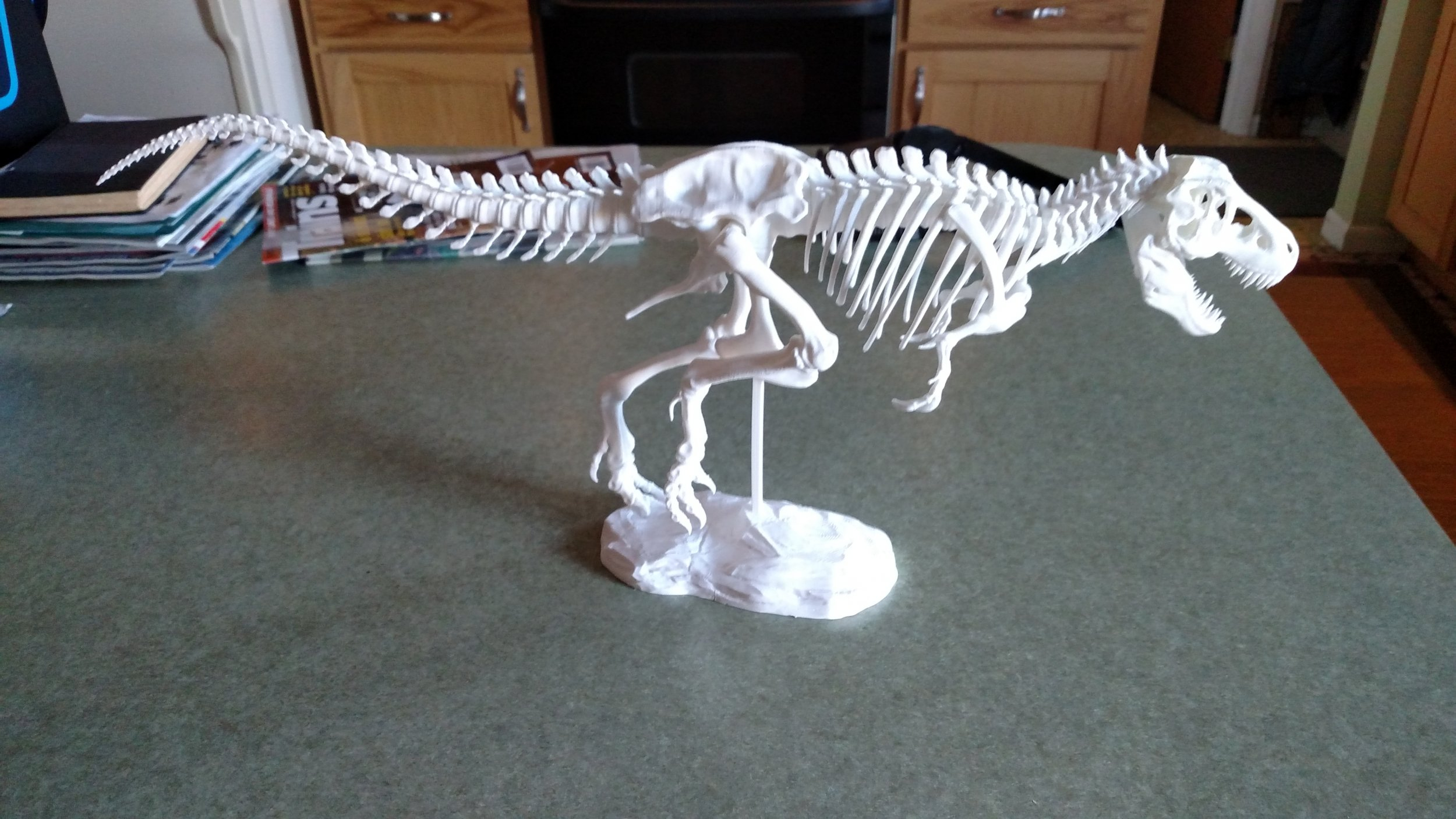

I did the same print, but mines only about 2 feet long. Took my QiDi Tech about 24 hours to print all the pieces.
