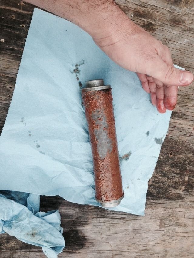

I'm new to this forum and 1st time tractor owner 2007 JD 790 2wd. I've allready searched this topic and what I've found is that dirty hydraulic oil and/or filter could be the culprit for the power steering not working correctly. Also my 3ph will not move up or down and I was wondering if the power steering and 3ph problem is related. I bought this tractor last week and haven't been able to fool with it much. Any other things to look out for from my fellow 790 owners will be much appreciated also.

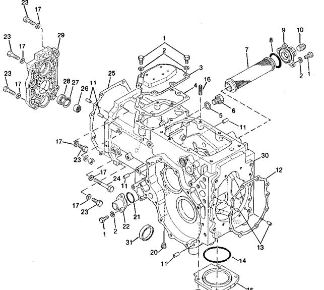

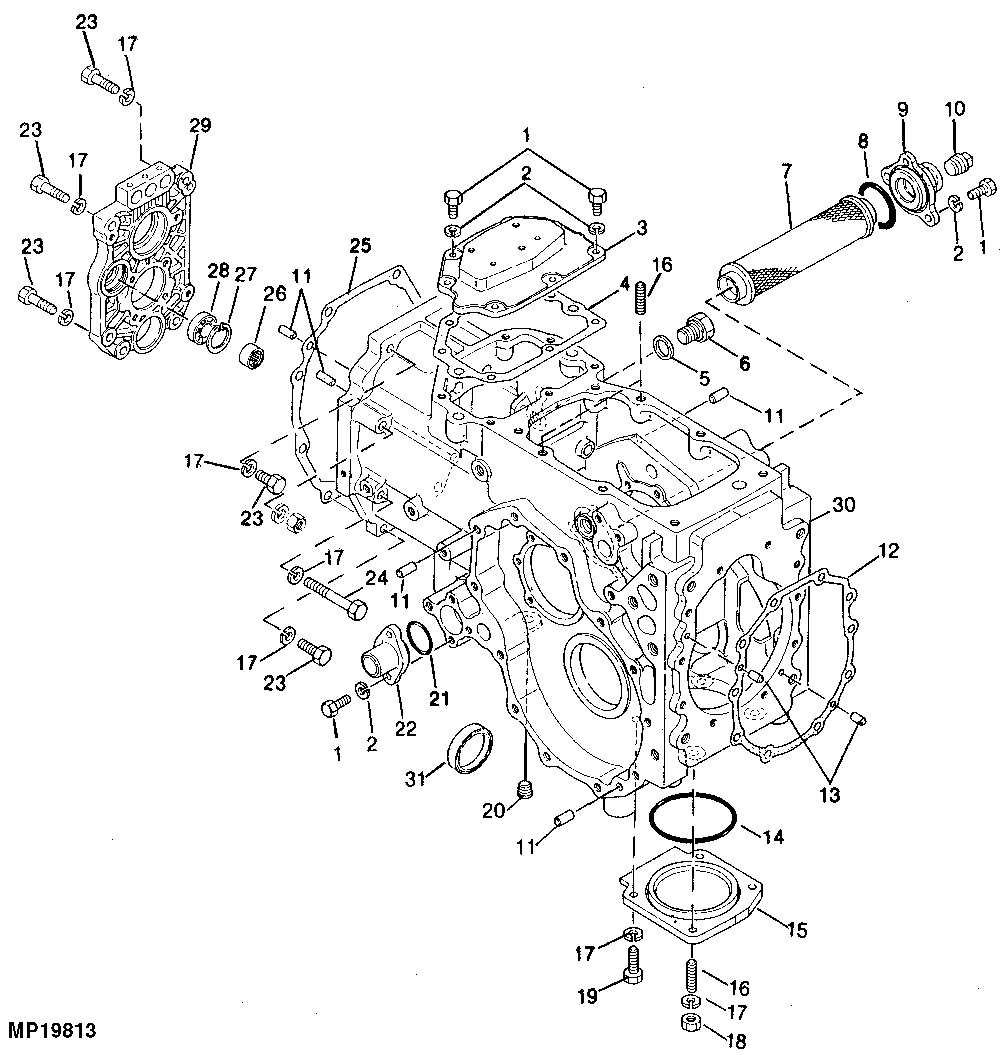

Parts schematic shows a strainer(parts key 7) PN-M803024
I'd suggest to clean screen,change hyd filter & hyd oil.

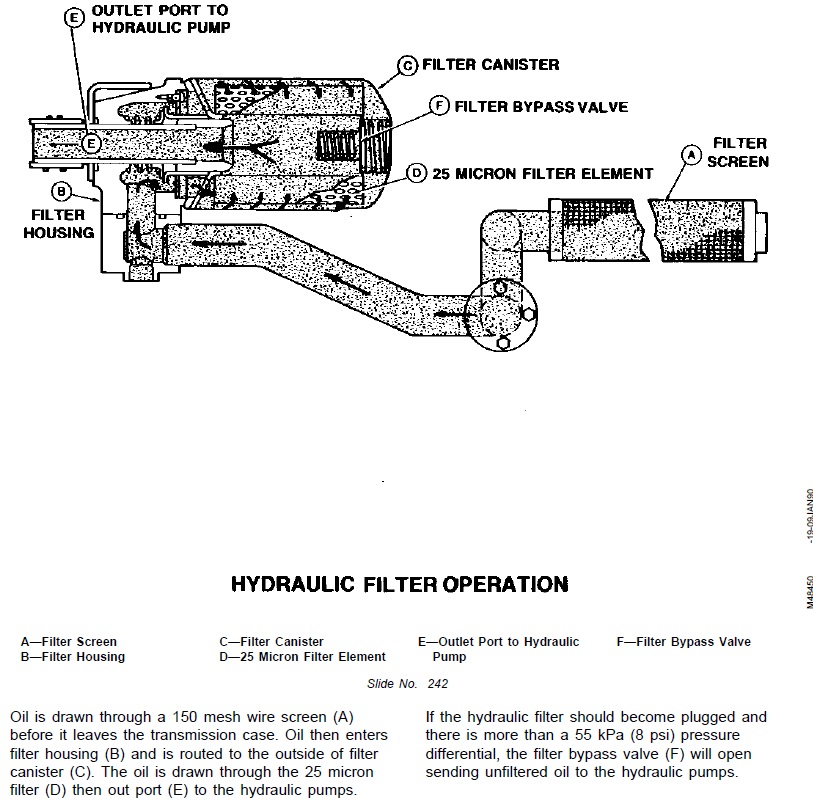

Made me go back to the tech manual and search for that screen. No mention of it when describing hyd. oil filter change, but under Theory of Hydraulic Oil Filter Operation, this schematic shows up with the screen. Failure to not mention it anywhere else, apparently. Also found I'd saved the same one you found in parts, but now can't seem to delete it.

Well I finally changed the hydraulic oil so I had to dig up this old thread. The sump screen/reservoir screen was definitely the culprit. My power steering and 3pt would operate slowly and sorta jerky, but now it's smother and faster than my truck. Also the hydraulic pump would "whine" at times, but after the oil and filter change it makes no noise.
Before
Cleaning
After

Great follow-up with pictures! Glad you solved the problem and your example will help other owner's down the line. (And now your son knows what to do, too!)

Yall are welcome. I never would've found the sump screen without the tips from this forum. Hopefully somebody else can search the forum 1 day and fix their problem using the pics and tips from this thread.
Btw that's my oldest son and he's my best helper.
