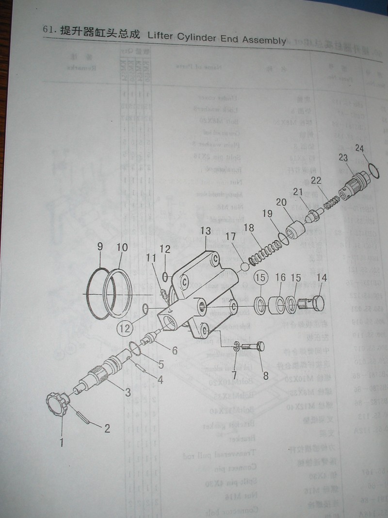

On my KM554, the drawbar is 1" thick, 2.5" wide, and protrudes 14" from it's frame. The 3ph is rated at 2068lb. The end of the drawbar is inside the ends of the lower arms so it should beat the rated load a little. A 2068 lb load on the end of the drawbar will produce 69,485psi of bending stress. If the draw bar is cold rolled steel it's yield stress is probably less than 40,000psi so it will bend. That is not to say that ugly interference between an implement and the drawbar will not damage the 3ph. It is simply no surprise that you bent the drawbar.
Even though it's a big hunk of steel, it is cantilevered and the load was applied against it's weak axis.
If it were me I would drain the lift box if necessary to look for damage. Can you take some pictures while you are at it? I just looked at the assembly in my parts manual and mine is quite different from what is shown! My parts manual shows a "lifter cylinder end assembly" that bolts to the front of the lift box and contains the relief valve and return adjustment valve. On mine the adjustment knob threads into the main casting right under the seat.
