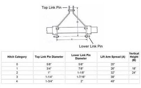

Have also seen pins that were stepped where part of the pin diameter is CAT2 and the tip is CAT1 and the CAT2 arms go in the outside slot and CAT1 arms are on the inside slot. You can try sticking a normal CAT1 pin in from the inside and put the lynch pin in between the ears.

If your tractor 3ph is CAT 2 and your pin is CAT 2 (1 1/8”) why do you need a bushing? Are you sure the pin your using isn’t CAT 1 (7/8”)?? Sure looks like lots of daylight around pin in your first picture?

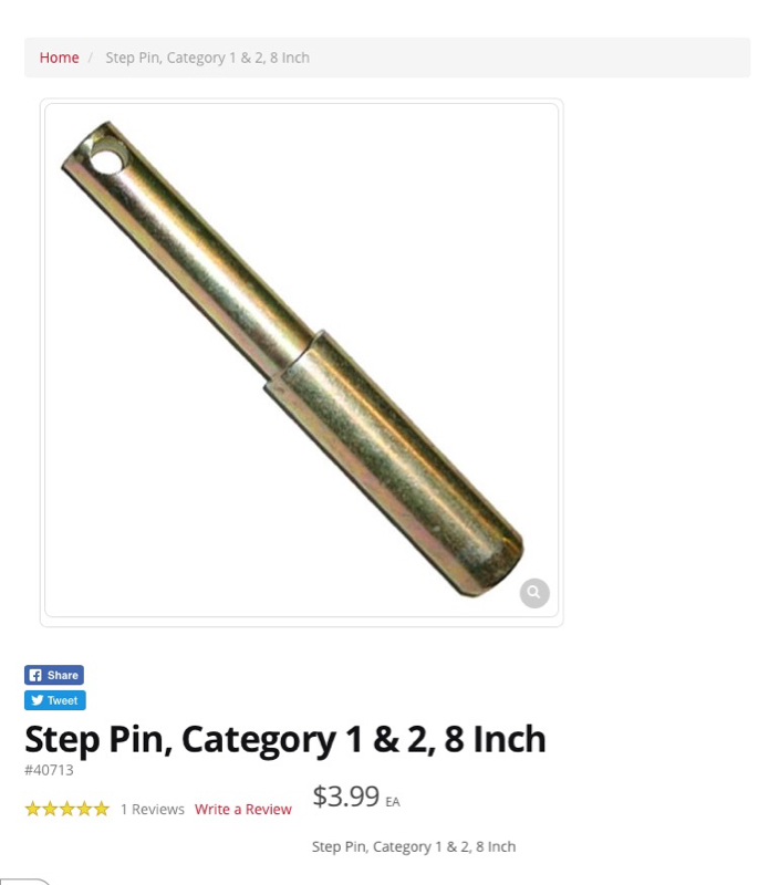

I too was wondering about that, if your tractor is cat2 and the first set of holes are also cat 2 then get a cat 2/cat1 combo pin. It will go through all three holes and pin in place.
Step Pin, Category 1 & 2 | Agri Supply 4713

Some equipment set up for multiple category hitches use stepped pins for the lift arms,
A pin with half the length cat 1 and half cat 2 or cat 2 and 3 with these stepped pins
bushings are not required. It also seems to me that you could be using a larger pin and no bushings.
