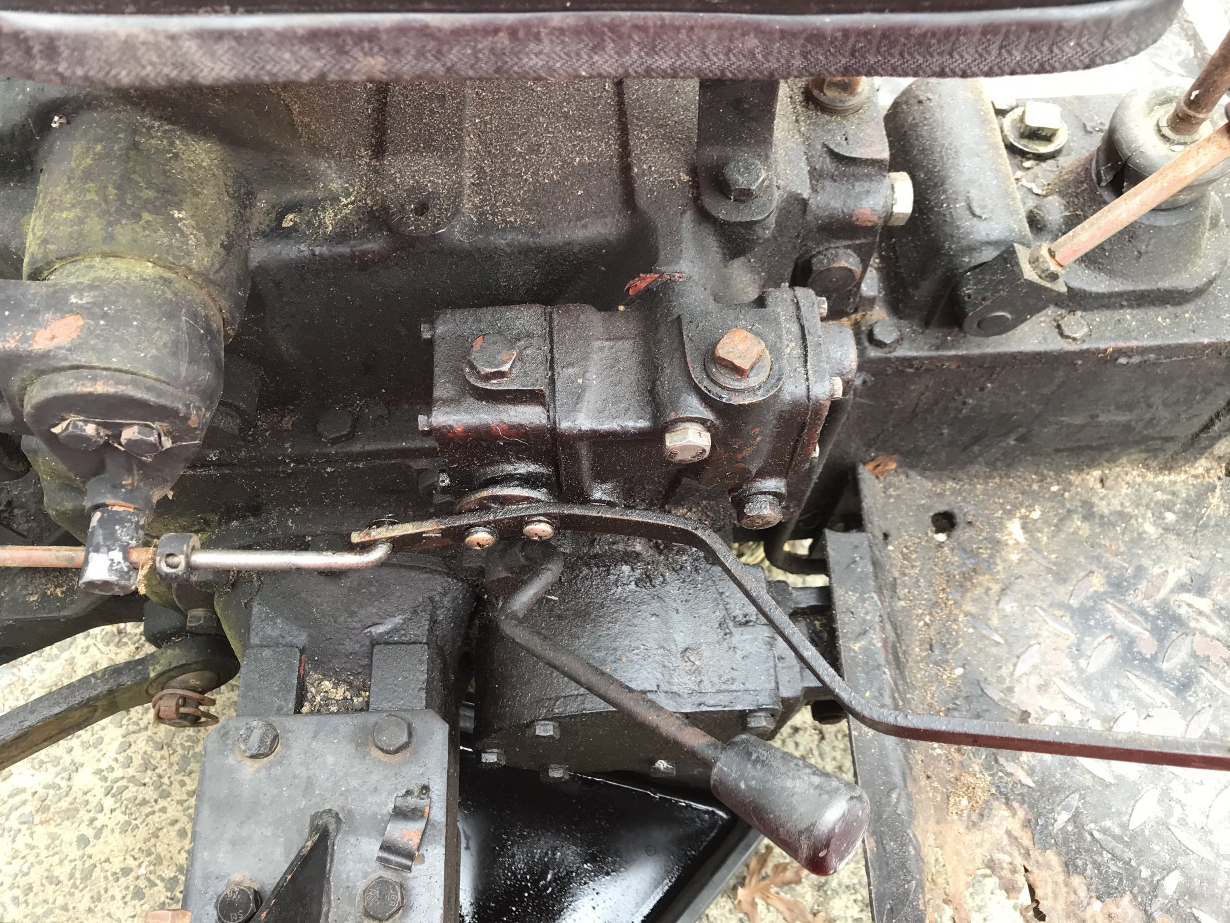

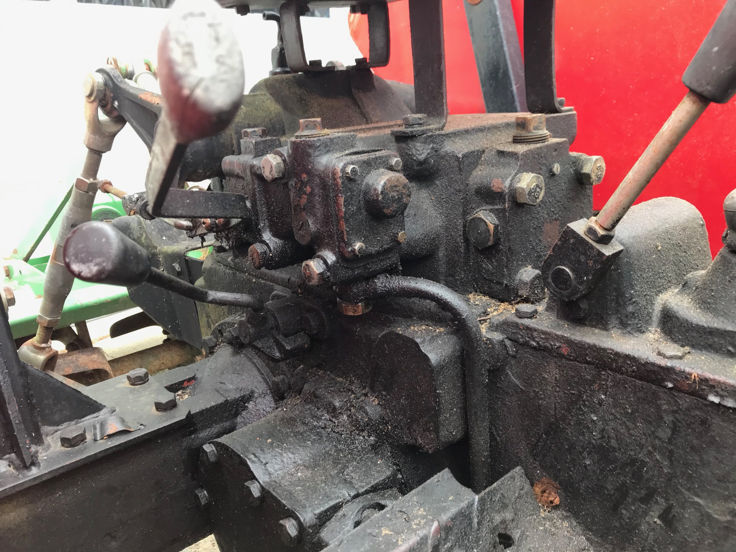

it looks like this thing sticks to the tractor with an actual gasket, someone gooped it up pretty good. But Im not sure thats whats leaking, it really seems to be at the lever where it exits the lifter valve...

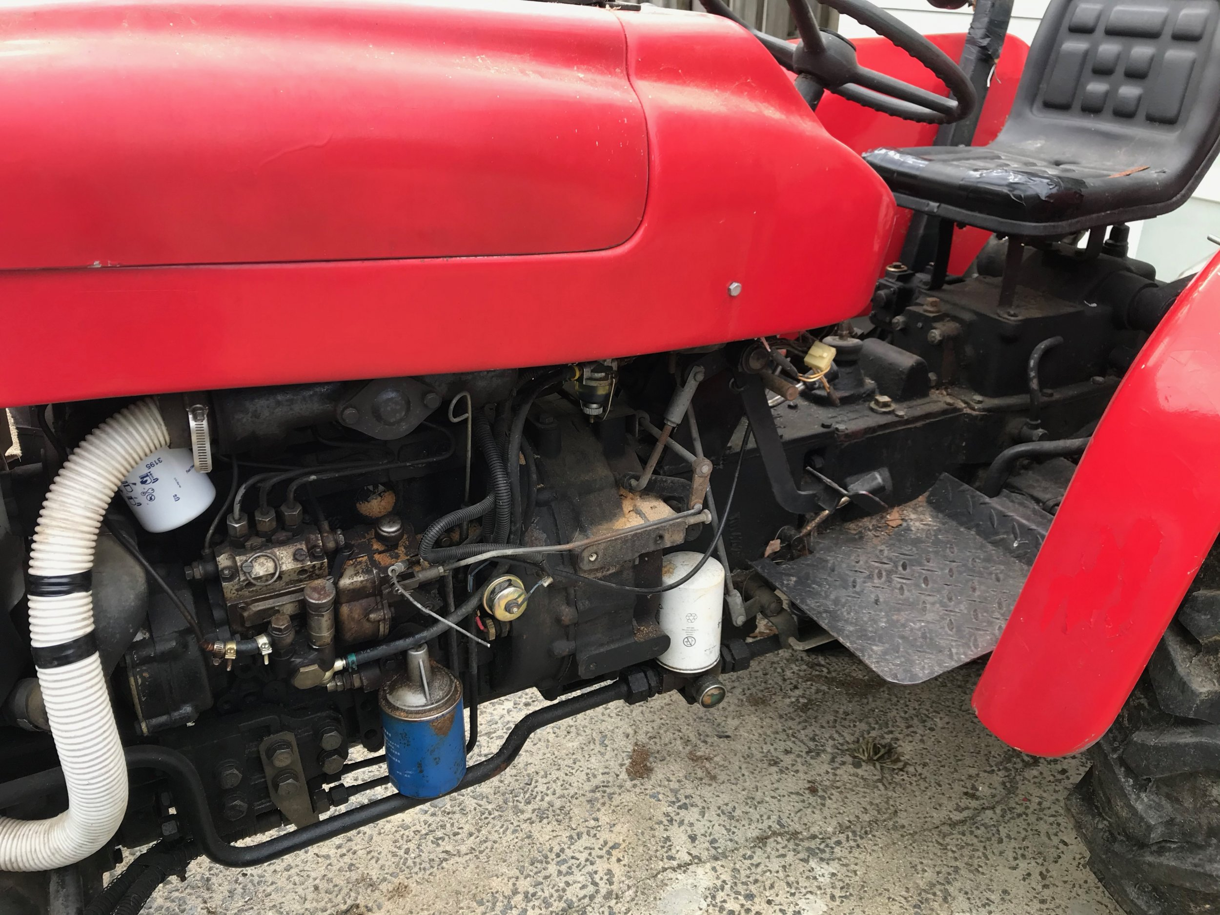

The white spin on filter appears to be a suction line filter. Is that a temperature gauge on the filter housing?
Where does the pipe on the filter come from and where does it go to?
If this is the suction line for the 3PT hydraulics, I would change out that filter first.
As for the control valve the first thing I would do is get some parts cleaner (paint thinner/mineral spirits) and a brush and clean off as much of the valve assembly as possible. Then follow up with some spray brake cleaner and then let it dry. This way you can start the tractor and let it run for a minute or two while watching to see where the fresh oil is coming from. Then you can better identify the source of the leak.
Odds are pretty good that the rubber portions of the banjo fitting seals are shot. Either old age or perhaps heat from the fire. They don't last forever. I try to keep spares on hand. The BOSS style fittings on my FEL are notorious for failing on a regular basis.
If it also leaks where the control lever shaft enters the back housing you will have to take it apart to evaluate. I don't see a seal listed for that location. Technically I suppose there should not be any leakage of the spool valve into the back housing but that would be a near impossibility. There are gaskets between the valve housing and back housing for a reason so it follows that there should be a seal of some kind on the control arm shaft.
If you take it apart, note that the hex head plug on the rear housing only holds in the detent and spring assembly. Part #30 is what actually connects the control lever shaft to the spool valve. There were a few different designs used but the basics are the same. As you unscrew the back housing it will back off from the valve body as it is under spring pressure from the spool valve.
If I were going to get into it, I would also pull the spool valve for cleaning and inspection. If it is badly worn it could be leaking internally and reducing the amount of power available to the 3PT cylinder.
The square headed plug on the main valve body housing is for the pressure relief valve. I would also pull this apart for inspection. If the spring is weak or if the assembly is not screwed in all the way it could reduce operating pressure. Some pressure relief valves are adjusted by how far you screw in the adjuster (adding more tension to the spring) or by adding a shim under the spring to increase the pressure. A worn valve or seat can cause loss of pressure and dirt or debris caught in the seat can cause the same thing.
That is a "change filter indicator". It's actually a vacuum gauge that's between the pump and filter. The filter head has a nominal bypass setting of 5 psig Δ. Typically, suction line filters have a 25 µ rating.
