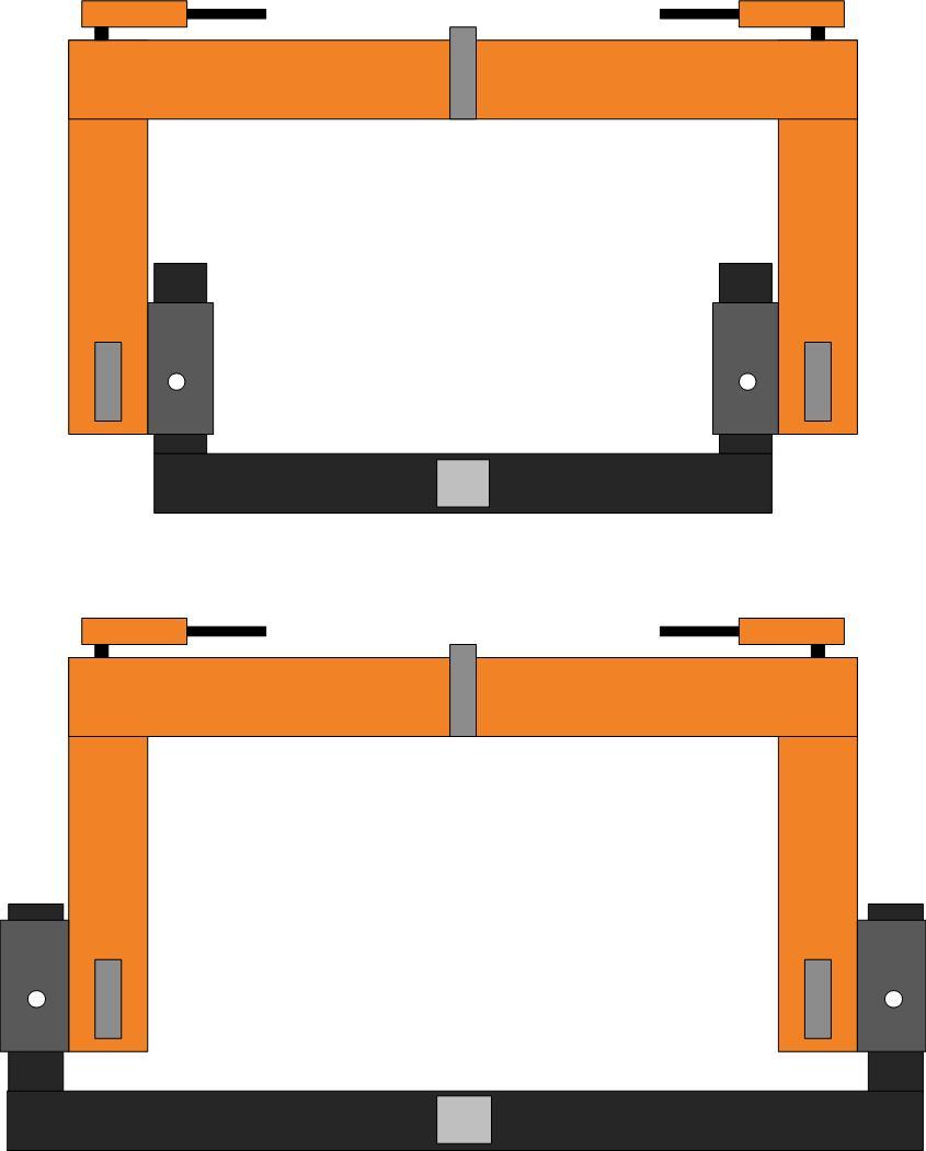

srjones said:
Yep, I see what you're saying. I hadn't thought of it, but the drawback is that that the receiver wouldn't be centered.
However, on that very note, I _could_ weld a 2x2 reciever on each side to accept my gauge wheels control the depth of small, ground engaging attachments I have planned. What a thought!
if you did that, you could also make a receiver that connects to the receivers... see attatched photo for my ideas...
Aaron Z

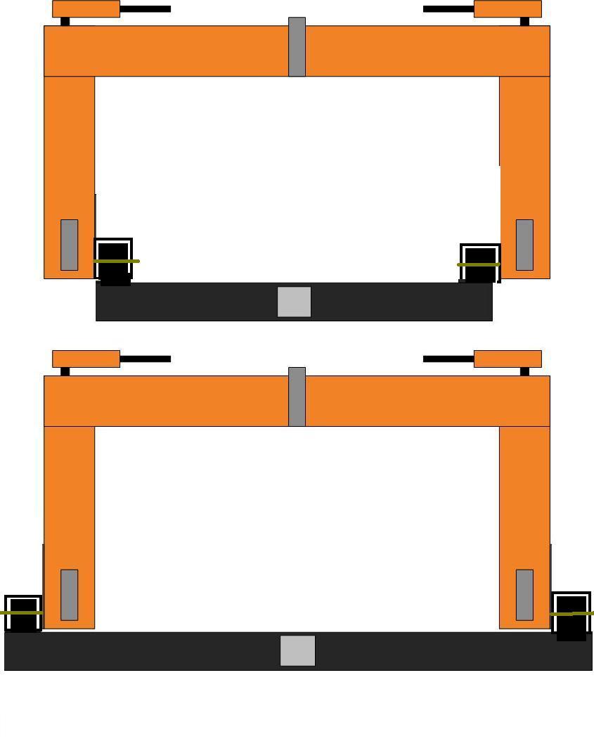

Yet another great idea! Thanks! Though, I'd probably mount the reciever tube horizontally.
See my attached modification of your pic. :D
