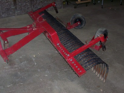

OK Ya' talked me into it. It should be strong enough now. I made the width of the pins same as my forestry winch, which is my default 3ph attachment.
Thanks for the help!
Al

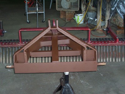

Woops!! That was a "before " pic. This is the one I intended to post.
Now that definitely looks beefy!:D
Nice job!
