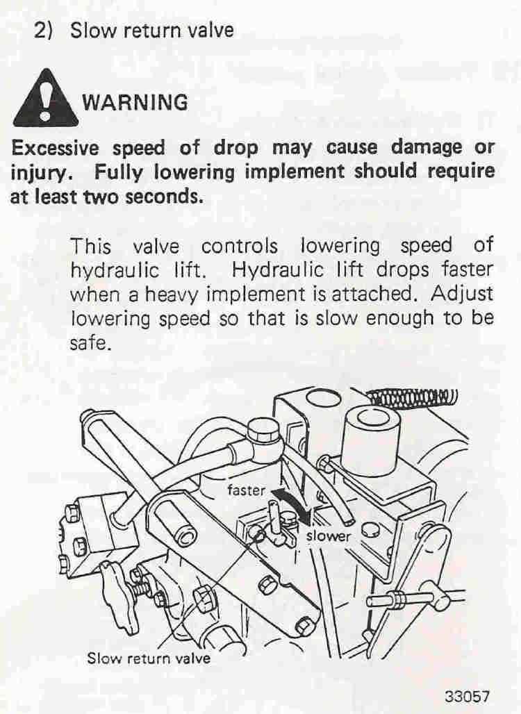

I've got most of the superstructure removed on my tractor and have a very good view of the 3pt housing. There is absolutely nothing moveable on that housing except the service lock valve, and the mechanisms for the 3pt lever and the draft(?) control lever. I was 90% convinced no such animal as a drop rate control exists on my tractor. Your comment pushes that to about 98% conviction.
I had been feathering the service lock to control implement drop rate but noticed a couple of posts which stated the service lock should be either full open or full closed. Then I saw the same statement in my manual - either full open or full closed. That set me on the search for, what appears to be, a non-existent drop rate control.
Incidentally, where did you get your manual. Mine is a Operations Manual translation provided by Hoye Tractors and appears to attempt coverage of all the YMXX20 tractors. Do you happen to have one specifically for the 2220D?
My manual states explicitly:
"The valve that adjusts the drop speed is located under the seat, on the right side. It is a small lever that, when moved clockwise slows drop speed and when moved counter-clockwise, increases drop speed. Adjust for a smooth, slow drop."
That is followed by a big "safety alert symbol" and the caption "Open lock valve completely when not in use."
I simply do not believe that applies to my tractor!

Here's a pic of my 1700 hyd section. You can see the tranny shift patter at the top of the pic for reference.

The diagram posted earlier is a very good representation of the unit in Norm's photograph and the rate control lever is very visible - thank you, Norm. I seriously doubt that I could overlook a feature as prominent as that. But, believe me, nothing that has any resemblance to that control lever exists anywhere on my 3pt housing. Other than the service lock valve, and the PTO levers, the only movable/removable features on that housing is the banjo fitting and multiple hex headed plugs(?) that require a wrench to move/remove.
EFT's website listed a 2220D as being in stock at his dealership. I dropped a PM to him with a request to take a look and see if a rate control valve exists on that machine and, if so, to describe it's location. But, as yet, there has been no response.
I think I can state with conviction that the 2220D (at least the tractor I own) does not have a rate control valve mounted anywhere on the 3pt housing unless it is masquerading as one of those hex-headed plugs. See attached photos.

The drop control level is an orifice valve.. if you tighten it up, you can slap your 3pt control all the way down, and the oil will only be able to escape the 3pt cyl slowly.. thus making the implement very slowly settle to the ground.. It is usefull with heavy implements that you don't want to accidentall 'slam' to the ground.
I looked at his posted pic.. boy.. sure looks 100% different than what is on the 1700

Interesting comments in the manual page Eugene mailed to me (Yep, I got it. Thanks!). Seems in that particular design, the service lock valve acts almost like a diode/choke in an electrical circuit - has a slider in the valve body that is moved by oil flow such that the valve offers free flow to the fluid in "raise" mode and slides to choke or restrict cylinder outflow in the "lower" mode.
Also, comments in this thread makes it look like at least one Yanmar model in the XX02 series and two in the XX20 series operate without a separate drop rate control. Can't help but wonder if the "guts" in those units aren't designed similar to Eugene's. Hmmm... Design change in later models??? Wonder what the FXXX models do for drop rate control.
I'm not going to tear into mine to find out, but I have observed that "throttling" the service lock to limit drop rate doesn't seem to affect lift speed nor do I see any indications of excessive load on the hyd. pump (noise, whining, etc). YMMV!
