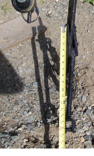

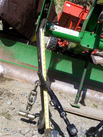

RK,
2nd Pic. 4" length from attachment pin end to 1st bend. the other end of the draft arm is the same 4".
Tom

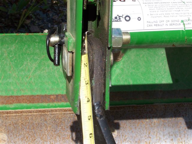

/ 3PH Question #12
RK,
3rd Pic. 19" center section of draft arm, between "bends".
/ 3PH Question #13
Last pic...just incase there's something odd about the lift links they provided you. This is the fixed lift link. I measure 16", pin center to pin center.
Hope this helps. I could find no part numbers stamped on any of the arms /forums/images/graemlins/frown.gif
Tom

Tom:
That's really helpful, and I appreciate it.
The draft link lengths seem the same as mine. My top link is adjustable, but my recollection is that its shortest length is around 19" also. I'll be able to check the measurements when I'm with my tractor tomorrow.

/ 3PH Question #15
RK,
Hope they do help. Are you installing the draft arms on the tractor's link pins 1st (i.e. both draft arms closest to center) then the attached spacer (with turnbuckle) then the short spacer? I'm not sure that it would appreciably change the distance from the link pins to the mower, all that much but, when I look at my manual it is some times hard to tell from the pictures which component is supposed to go on first. Draft arms on first is the best fit, for me. Putting them in the position that would make them the closest together at the link pins on the tractor appears to be where the draft arms belong.
As for leaving the 3PH parts on the attachment, I've found that the "I-Match" makes for convenient storage for the 3PH. Hanging it off the RB, in the pic, is a matter of convenience and keeps the parts up off the ground (still no barn /forums/images/graemlins/frown.gif). As for attaching, with the parts connected to the I-Match, it is pretty easy to line up and attach to the tractor. It still takes a bit of muscle power to move parts around and, I've been known to take a wooden or plastic head mallet to "persuade" parts to get to where they belong. I usually back up, slide one link pin in to attach a lower draft arm, lift arms, and top link, then, as needed, release the I-Match from the RB to attach the 2nd draft arm (this is where the mallet occasionally comes in /forums/images/graemlins/tongue.gif ). Seems to work for me. I used to take it all apart and hang the pieces in the shed before realizing I was wasting a lot of time when I could just leave it all hanging on the I-Match and RB, or Mower, or,...and only have to adjust the toplink for which ever 3PH implement I was going to use.
Let me know how it works out. Seems as though you must have some thing in the wrong place if your dimensions match mine.
Tom
/ 3PH Question
#16
Tom, You got it, a setup issue. Same draft arms as yours. I had the sway hitch too far inboard and didn't get enough leverage. The ops manual photos and the lack of text leave something to be desired as far as where to put that spacer. Also, the turnbuckles in the ops manual photos are set all the way to one end. But after taking the sway away from the 3PH, I've got about 4" of clearance to the tire with the cutter dropped to 6.5, and 1.5" of clearance with the cutter raised to rockshaft 10. And the draft arms are no longer rubbing on the inside of the tire. I took photos, but kept getting them rejected for size, so they're in the TBN gallery now. I'm going to go tackle some brush.
